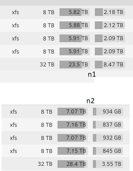

HI All,
Love unraid, have 2 servers n2 is just a backup of n1
RSYNC is run regularly to copy data across.
I don't delete missing stuff during rsync but I clean it up manually from time to time (bcompare helps), so there's always a few leftovers & a small amount extra, but not 4.9TB worth.
However, despite runing bcompare to confirm they are pretty similar, n2 shows disk space used = 28.4TB whereas n1 shows it as 23.5TB
I've checked on the CLI using du, and only found around 0.6TB difference, when looking at the array share /mnt/user/filestore
However, checking the individual disk shows a very different story:
n1 = /mnt/disk1  = 5.3T    ./filestore
n2 = /mnt/disk1 = 6.6T    ./filestore
All 4 disks are the same sort of thing. (XFS)
I also ran xfs_repair on one of the disks, as I got an error on it, but didn't fix this though.
The other directories on these disks don't account for very much, system, appdata etc.
Interesting the GUI and CLI don't agree in the detailed numbers, but still generally in overall amount.
Not sure where to start looking now.
I know the last resort is to wipe & restart, but that's a whole week's worth & is scary.
Any pointers anyone can suggest?

So the rsync with delete option has finally finished, no difference in disk size.
n2 = 27.5TB
n1 = 23.6TB
So what is difference?

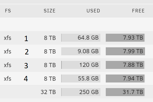

Gave up on finding an answer, so deleted everything.
When "empty" the disks still had some data in ther, system, iso images for vms etc, but not much:
8.5G    ./disk1     64.6GB
8.2G    ./disk2    9.08GB
61G     ./disk3     120GB
0       ./disk4       55GB
CLI                      GUI
However, the GUI still reported somewhat less than empty...when compared to the "du" command on CLI.
I don't care all that much about such a small amount, but do I need to do a "disk check" to clear them down ??

There will always be some space used even on a newly formatted disk due to filesystem overhead.
