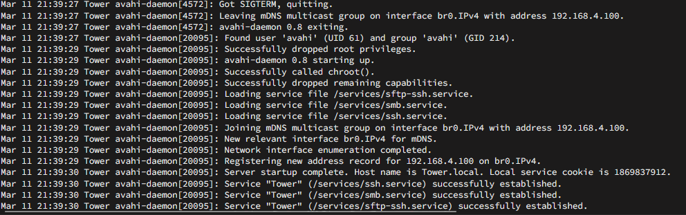

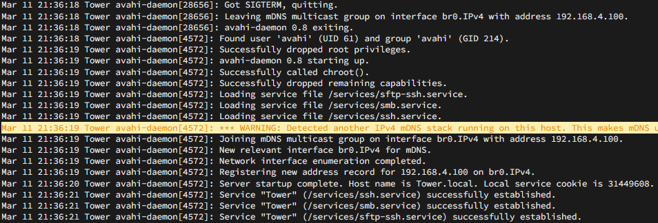

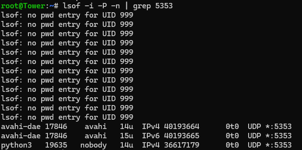

I think I found the culprit maybe?
nobody   19635  0.8  2.3 1609296 388820 ?      Ssl  10:06   5:39 python3 -m homeassistant -c /config
Before and After stopping HA docker and restarting unraid mDNS:
After, clearly homeassinstant is what I think is the source for the mDNS conflicting issue
