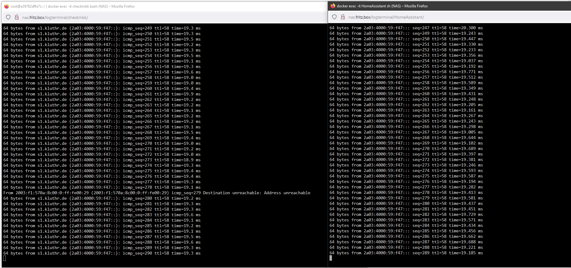

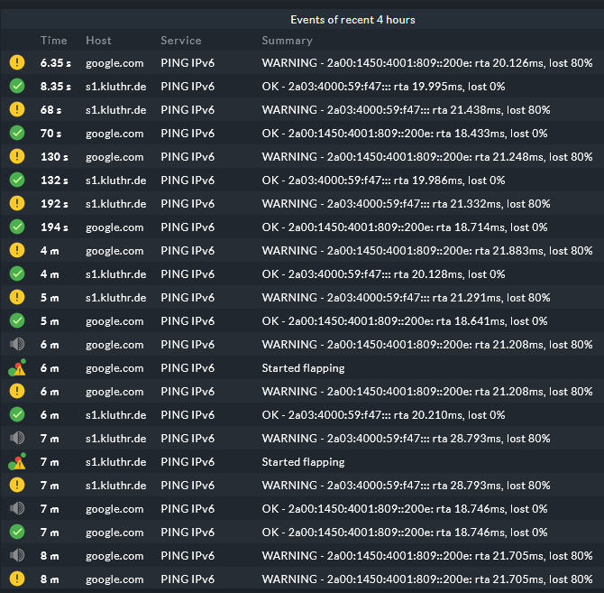

I migrated from an exclusive cmk appliance to the docker version to get rid of one physical system. However, I experience permanent occasional v6 smart piung issues with the container. I can observe this with ping6 from inside the cmk container. Every few minutes I get 100% packet loss, then back to normal etc.

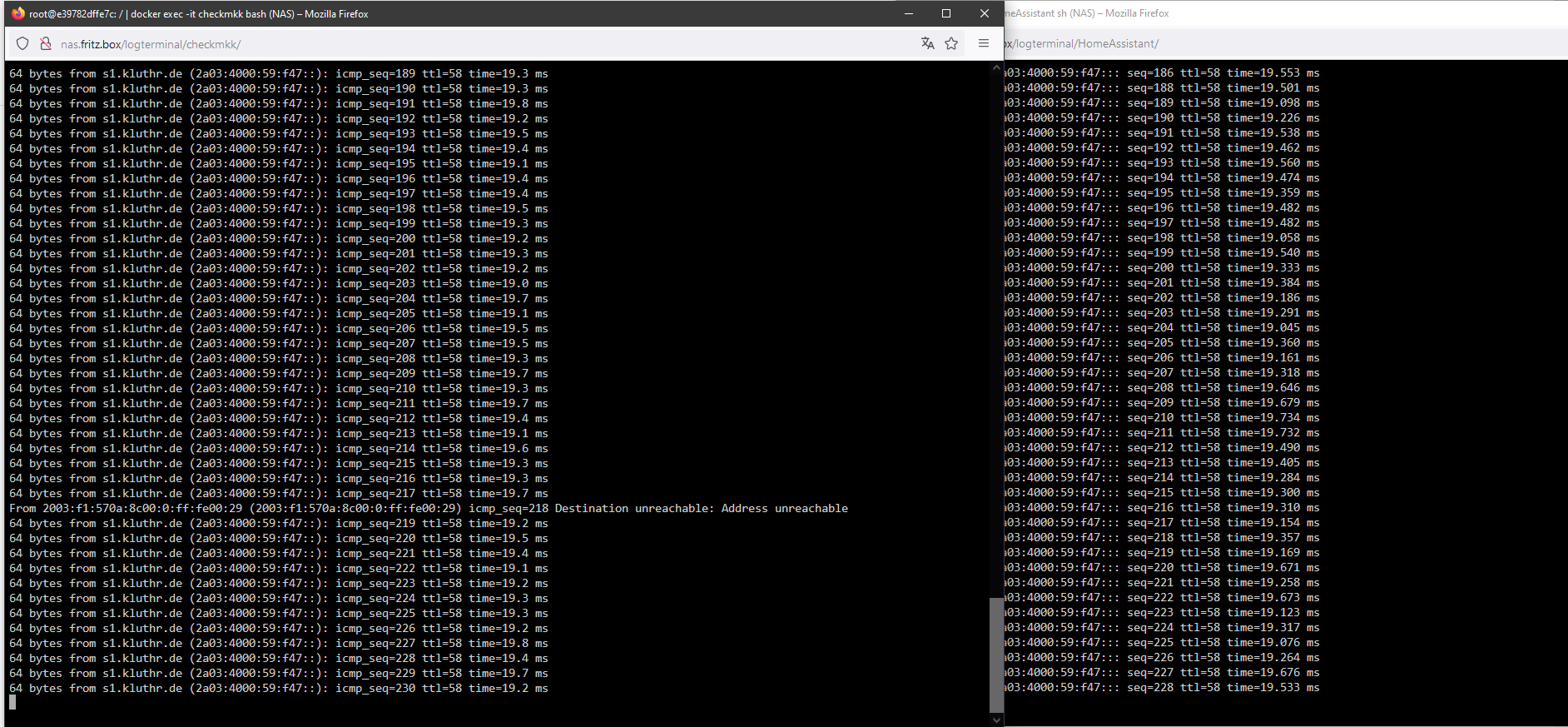

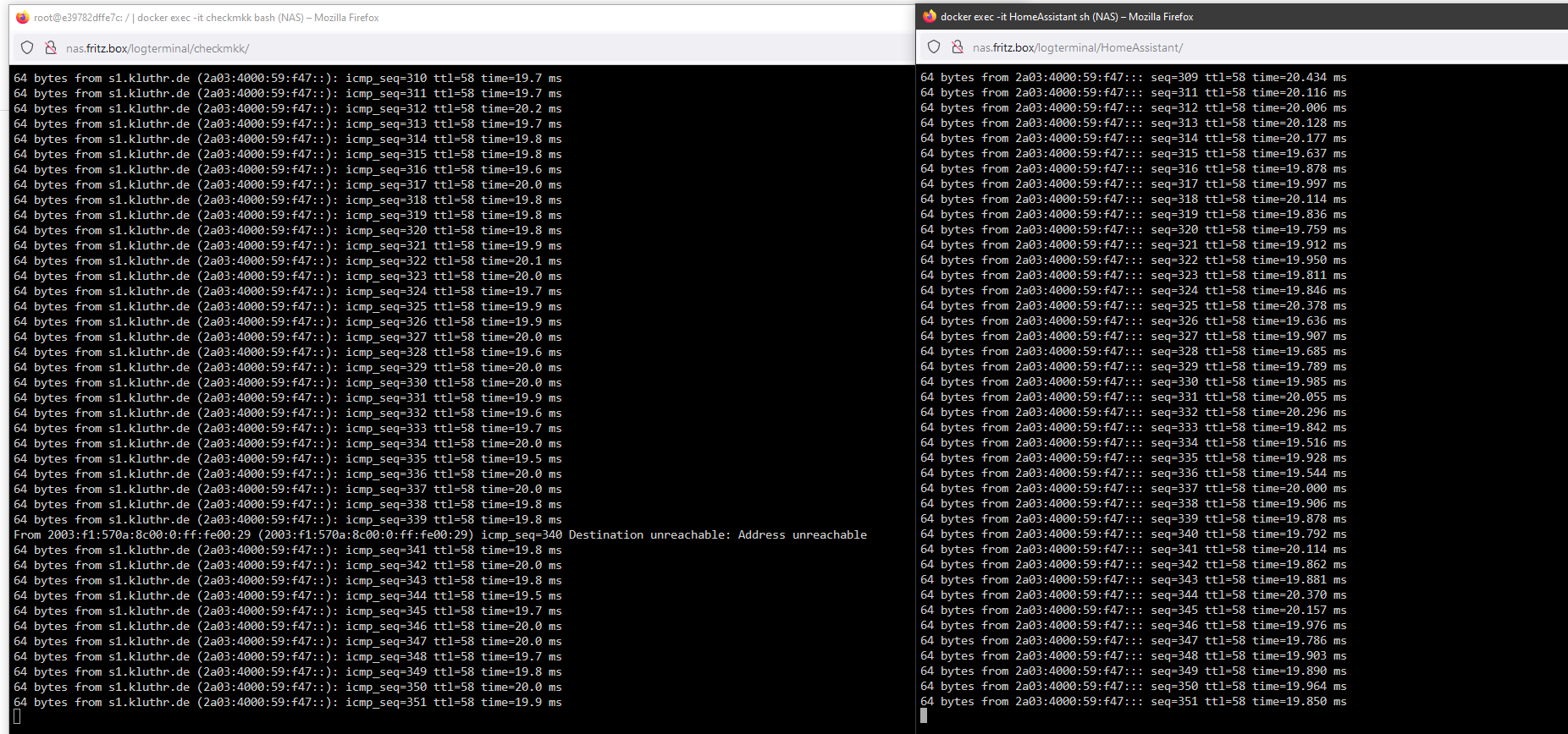

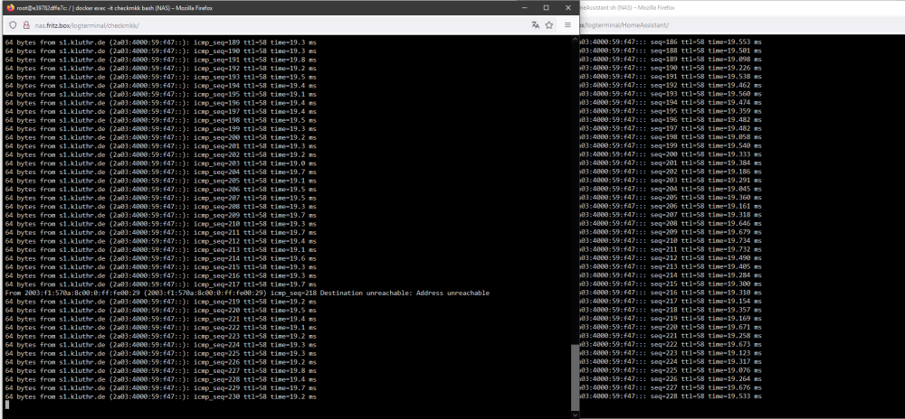

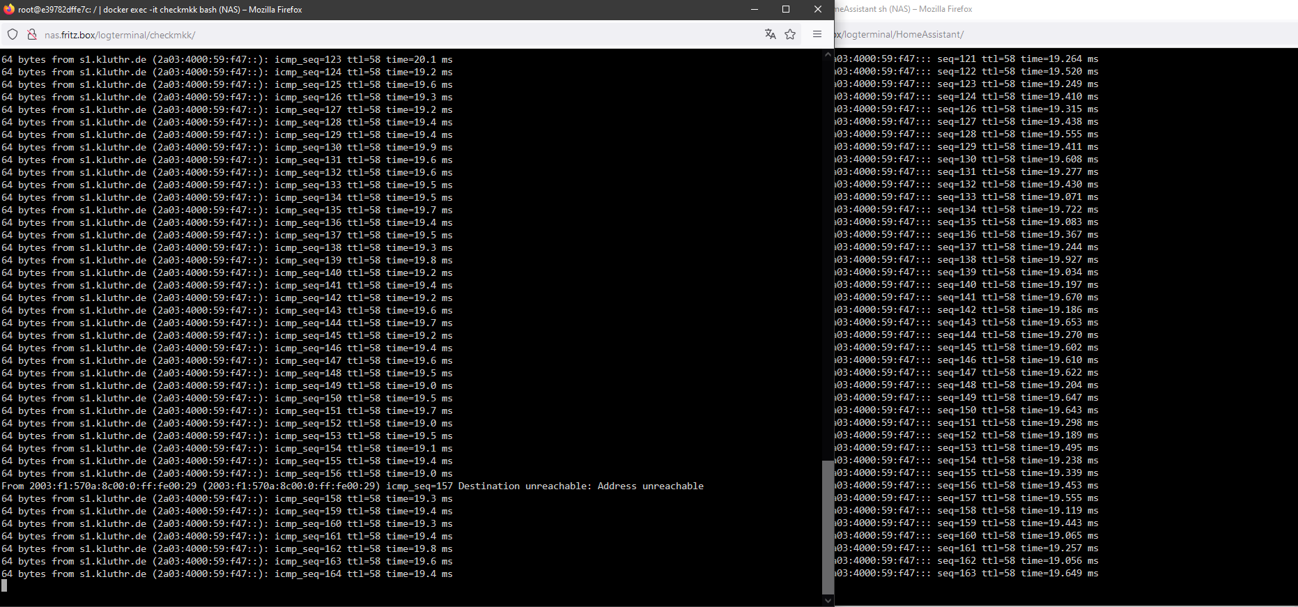

Some ping pictures which show the v6 issue only within cmk container. HA container does not show such issues..? HA is set up the same way.
docker is using macvtap bridge.

ping pics
Feels more and more like a general v6 docker issue. docker and IPv6 are not the best friends. There are several issues regrading v6.

Does no one use IPv6 inside Unraids docker? Could someone do a ping test from inside a container to a public server and observe if some "address unreachable" occur?
I still need to retest with a native portainer install. Somehow I got a feeling that this is an Unraid thing...
