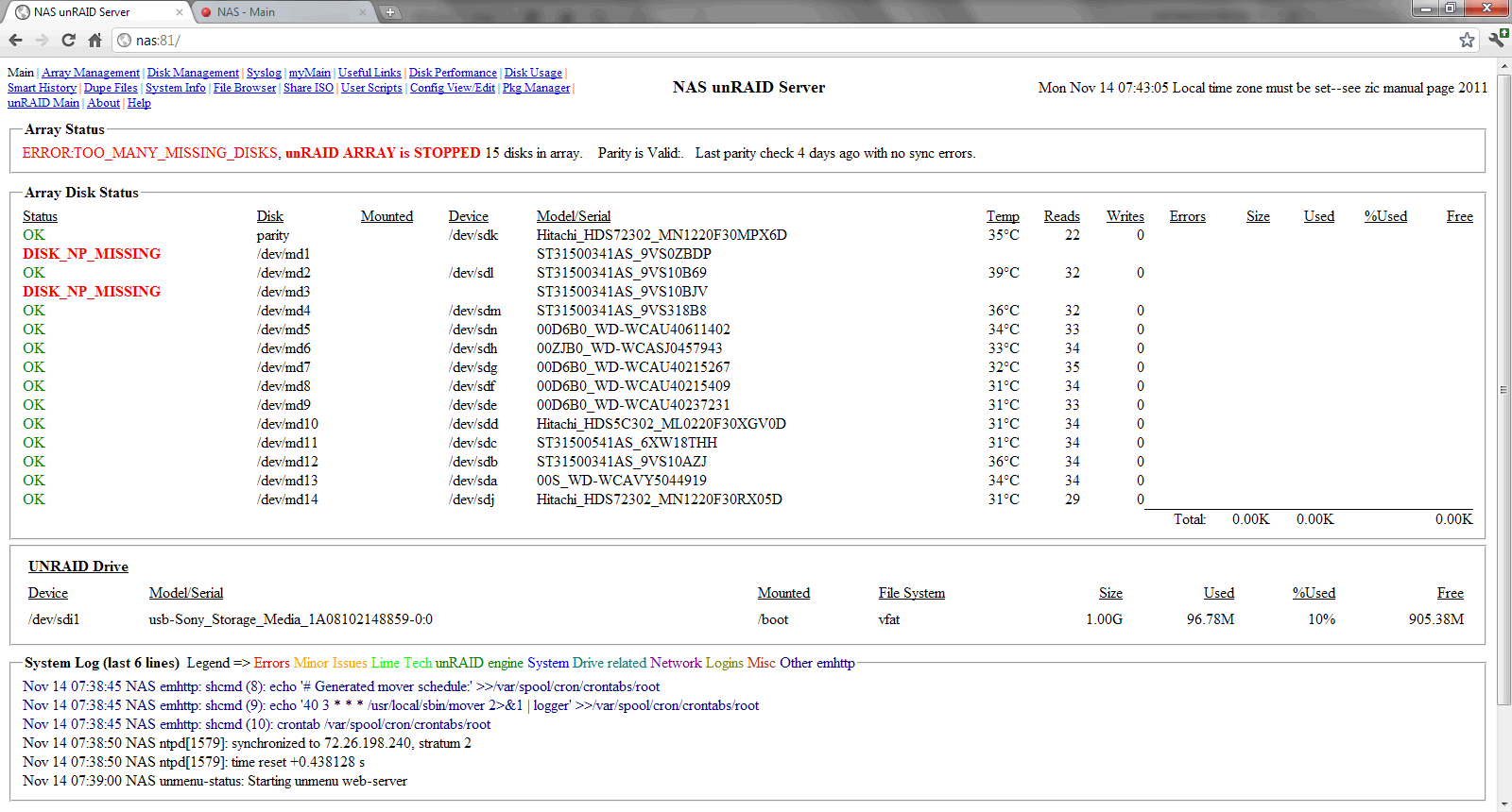

It appears I may have simultaneous failure of two drives in a 15 drive array.  My unRAID server is a LimeTech MD-1510/LI; unRAID version is 4.7.  The system has a mix of WD, Hitachi & Seagate drives, including several ST31500341AS 1.5TB drives.  I recently had an issue with one of these Seagate drives were the disk was showing as unavailable.  I did an RMA advanced replacement from Seagate, got the replacement drive in two days, ran preclear on it with a clean bill of health and rebuilt the array.  Everything was then fine.  Now, four days later, it appears as if two of the other Seagate drives have failed.  I first noticed that a directory had far fewer files in it than it should, so I checked the unMenu page and there were I/O errors listed.  I rebooted the array, and now two drives are listed as missing (see unMenu screenshot) and the array won't start.  Also attached is the syslog; the two drives are listed as missing so I haven't been able to figure out how to run a SMART test on them (if there is a way, please let me know and I'll certainly do that).
Is there any hope of rebuilding the array or am I out of luck when it comes to the data on the two affected drives?

I checked the cables--everything seemed fine.  I then re-slotted the drives (my server uses the IcyDock enclosures) just to make sure that wasn't an issue.  I then powered up the system--I heard the clicking noise indicative of bad drive.  When I went to the unRAID web console, it was showing an odd message.  Disk 3 had a red dot and was marked as unavailable, but the error message was that the parity disk was smaller than the largest disk in the array.  Disk 3 was showing a total size of over 2.1GB, even though it's a 1.5GB drive (my parity is 2GB Hitachi).  I then unassigned disk 3, and was able to successfully start the array.  I then tried to use preclear on disk 3, and got the message "Sorry: Device /dev/sdn is not responding to an fdisk -l /dev/sdn command", so I have to assume the drive is beyond recovery at this point.  I guess it's another RMA for Seagate.
