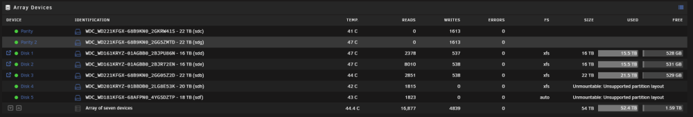

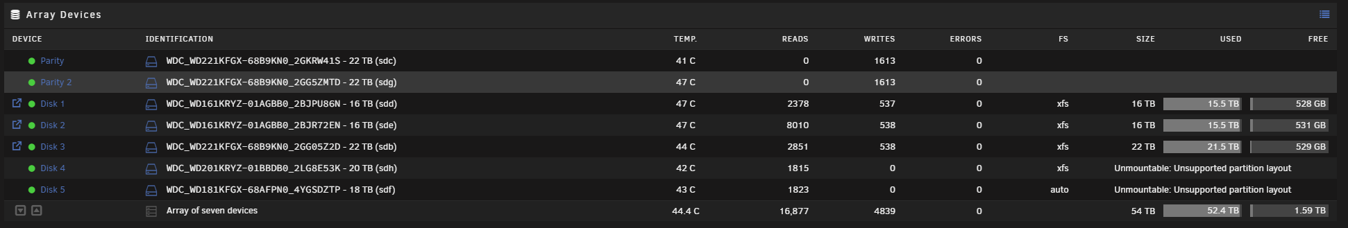

Hello all!
I am having a problem that I don't know how to resolve. I had an array of 2 x 22TB parity drives and 4 data drives: 2 x 16TB, 1 x 22TB, and 1 x 20TB. I wanted to add a 5th data drive, an 18TB, to the array. I performed the preclear on the new drive, all completed successfully with no errors (pre-read, preclear, post-read).
I then stopped the array, added the new drive (Disk 5) to the array and started it up again. When I started it, Disk 4 (which already has data on it) and Disk 5 showed up as "Unmountable: Unsupported partition layout". See below:
I do not want to lose the data on Disk 4. Disk 5 is new, so I don't care if I need to format it again. How should I proceed? Thank you for any help you can provide.

Looks like the new parition for disk4 requires a reboot to be updated, please reboot and post new diags after array start.
Phew! A reboot seems to have fixed Disk 4. Disk 5 still appears as Unmountable. I suppose I should just format that one.
