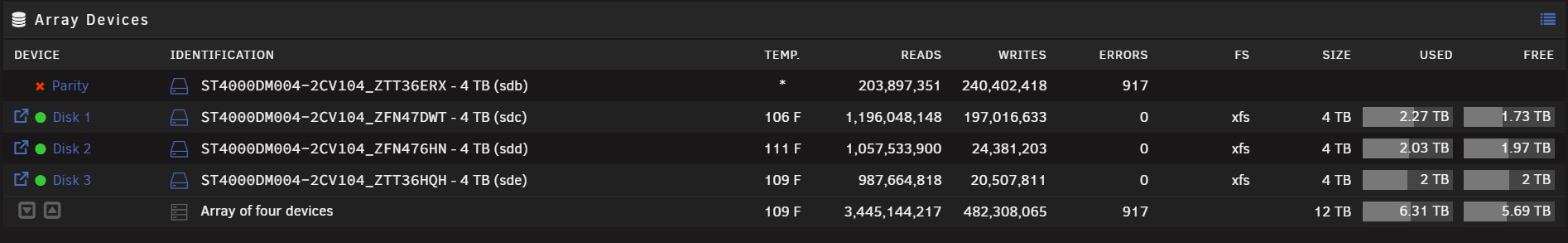

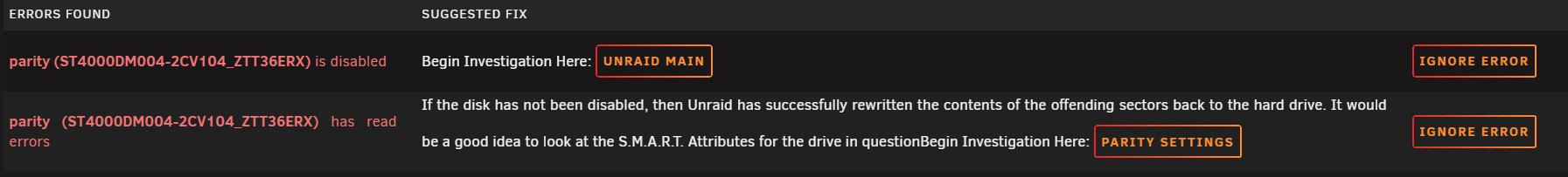

Today at 10:45am I received a Parity disk error notification. "Parity disk in error state". I ran a Read-Check on the array and it just finished with 0 errors. This is my first experience with a drive issue so I wanted to reach out for assistance if someone can talk me through next steps please.

Parity disk dropped offline, so there's no SMART, check/replace cables and post new diags.
Thanks, checked connections on cables and all seemed good. Disconnected and reconnected and brought back online. Disk shows now (disabled). Below are the new diags.

Still no SMART report for parity
Check connections, both ends, SATA and power, including splitters.
It's still showing ATA errors, try swapping cables with a different disk, if the same the disk might have failed.
Reallocated Sector Count is quite high, but they could be old, you can re-sync parity and keep monitoring the disk.
Would you mind stepping through that process? I have the array stopped right now and the drive shows in Parity but is disabled.
  5 Reallocated_Sector_Ct   PO--CK   097   097   010    -    9168
Too high for my comfort.
Plus
Model Family:     Seagate BarraCuda 3.5 (SMR)
SMR for parity is not ideal.
I would replace with CMR drive.
You should see a SMART ( 👎 ) warning for that disk on the Dashboard page.
Setup Notifications to alert you immediately by email or other agent as soon as a problem is detected.
During parity rebuild, the drive errors returned, so time for a new drive. Thank you for ALL for the guidance in getting me to this point.
