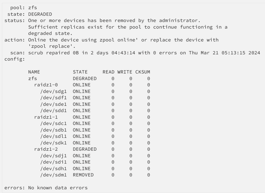

  • Drive is "REMOVED" so that means that I need to follow process#2 because the server is not seeing this drive as ONLINE - it's not a swap of drive that's operational, this is a bad drive, so it "Cannot have both the old and new devices connected"...? Or is this only if there is a physical limitation - e.g., there are not enough SATA connectors? We don't have any limitations with the hardware.
  • By "Device" that is the "Drive"?

So, I should:
  1. Stop Array
  2. Unassign the "REMOVED" drive = SDM1 in this case = change to "No Device"
  3. Start Array
  4. Shutdown
  5. Physically remove "SDM1"
  6. Physically add New Drive
  7. Assign New Drive to Pool where "SDM1" was previously
  8. Start Array
Please post the diagnostics to see what happened to sdm, also see SMART.

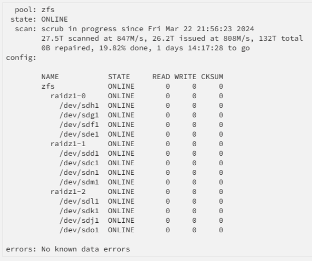

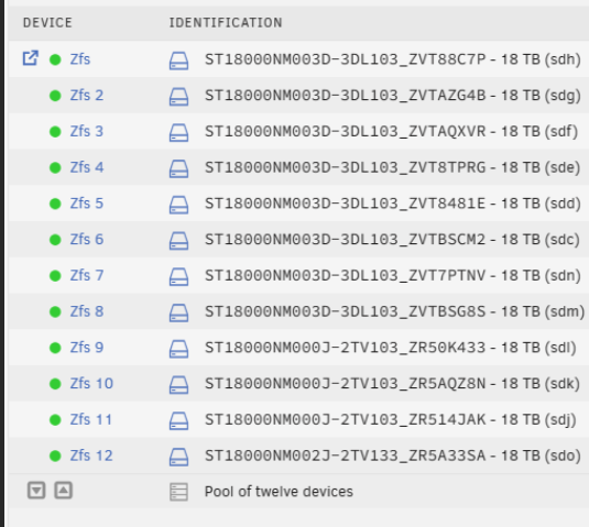

I think we broke a cardinal rule. We rebooted to add the new drive but did not add it to the server. Just to have it in the server for when we decided a path today.
Once it was rebooted, it changed the drive to sdo1 and showed it online. My assumption is that it's SDO now because another drive was added and orders are different now. We're new to this, so unsure.
It's running a scrub now. We had problems with this drive in the array previously and thought it was a fluke. It went to the "x" status but went back online - thought it was a port issue.
SDM before the reboot is now SDO. My assumption is that it will error when it gets to that point, but we're in waiting mode. There is a mirror of all the data on a second server.
