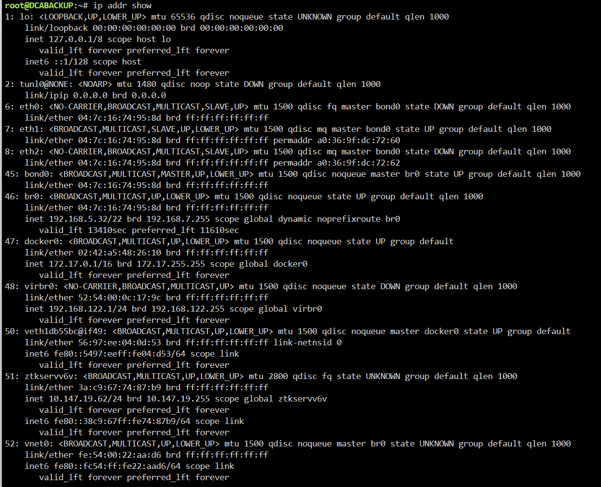

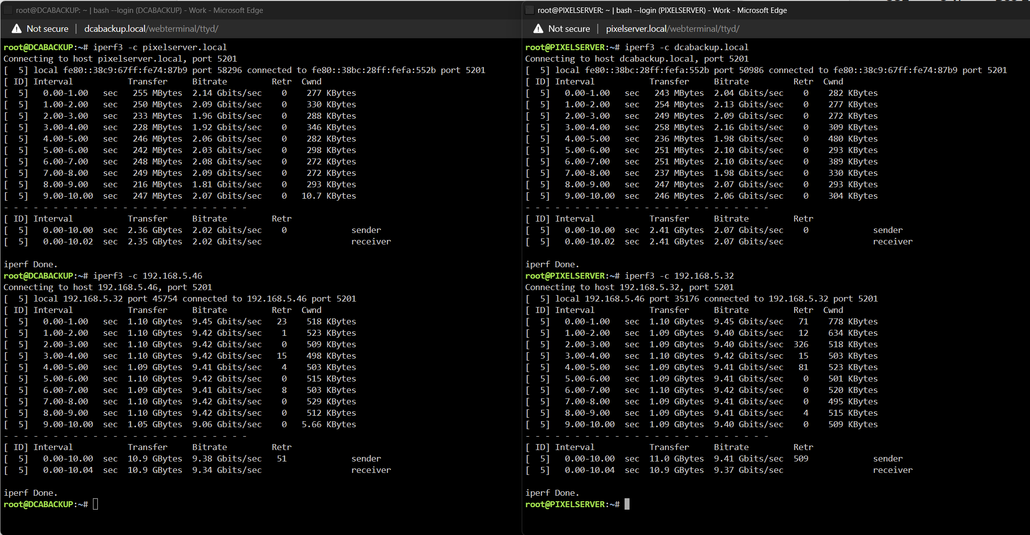

Does anyone know why iperf would resolve to the IPv6 address when using DNS (despite IPV4 Only set). Performance is fine through IP. When it grabs the DNS, it's a fraction of the speed. I don't think that's impacting performance, but curious if anyone has seen this. My hope is that it's an obvious answer for a newbie. I am pretty sure that ZeroTier is grabbing the address for a virtual interface, however, I can't figure out how to disable it (tried enabling IP4 +IP6, then looking to uncheck something, but nothing is there). Assume it's a config file that needs to be updated.
