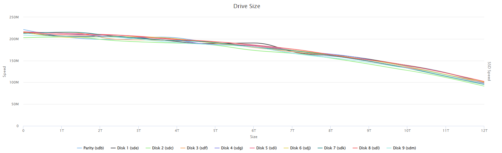

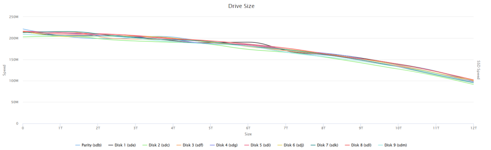

I installed the 'DiskSpeed' Docker and conducted some tests. Interestingly, individual speeds reached around 200MB/s. It appears that the issue highlighted by @JorgeB might indeed be the key to optimizing the performance. Thanks for suggesting the docker – it seems to be a valuable tool.
See screenshot of the tests on all my HDD drives for more details.

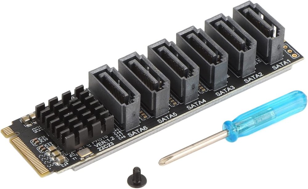

Upon investigating further on the same evening I started this topic, I reconfigured the disk connections and discovered that two out of the six SATA ports on my motherboard were completely non-functional. It appears that this was probably the reason why I initially arranged the disk connections in a certain way. Unfortunately, due to the malfunctioning of these two ports, I was limited in terms of reconfiguring the setup.
To address this issue, I proceeded to order an M.2 to SATA adapter equipped with an ASM1166 chip, providing functionality for six SATA ports.
M.2 to SATA x6 (ASM1166)
I received this tiny piece of equipment yesterday and promptly connected the drives to it.
I am pleased to report that I am now achieving the desired speed of 200MB/s, effectively resolving the problem I was experiencing.
