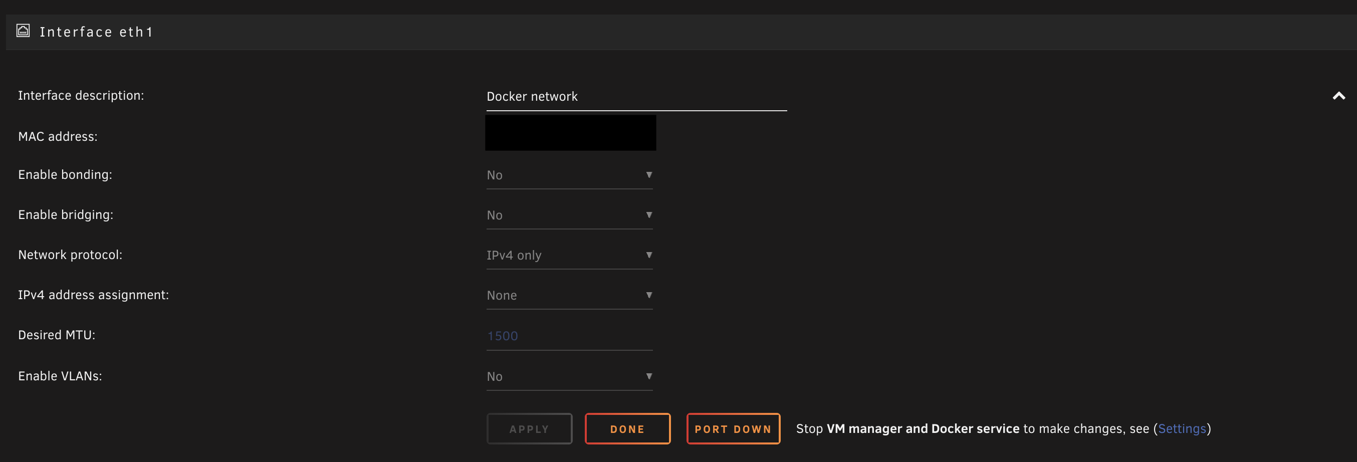

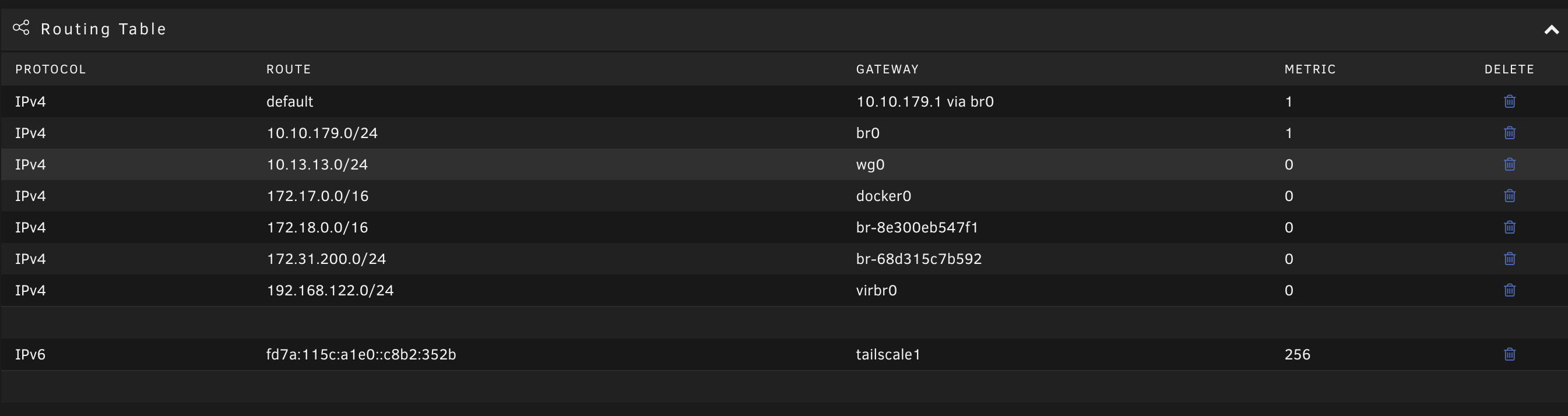

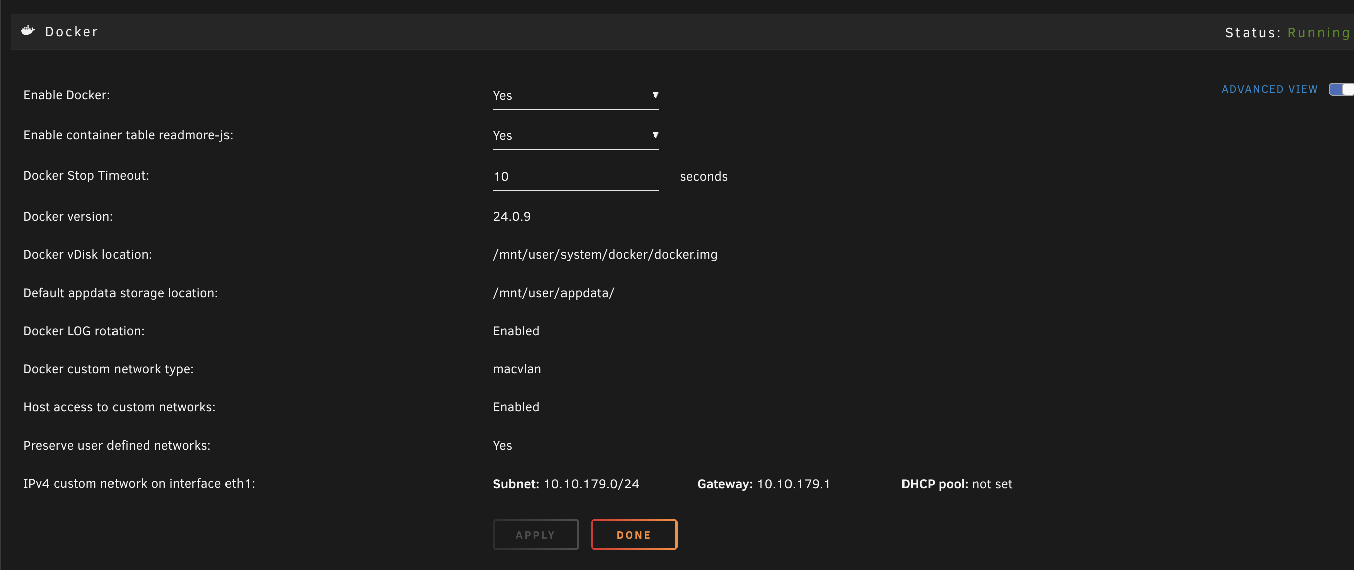

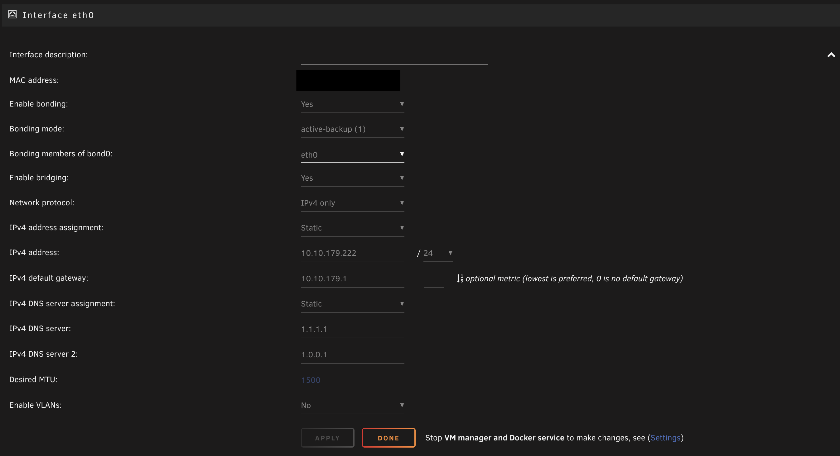

Hey guys,
I have 2 NICs on my server and I'd like to use separate NIC just for Docker:
- eth0 for Unraid and probably VMs
- eth1 just for Docker containers
Just before I start with my settings I need to let you know I have only single subnet work with `10.10.179.0`, as I have business router in my apartments and I do not have access to it.
Ideally I would like to have Docker default bridge IP being separated from Unraid WebUI IP, but not a requirement.
Attaching my settings with screenshots.
Edited by noonamer
I'm not sure it would be right approach, but I can add route for let's say subnet: `172.18.0.0/16` to eth1
ip route add 172.18.0.0/16 via 10.10.179.1 dev eth1
