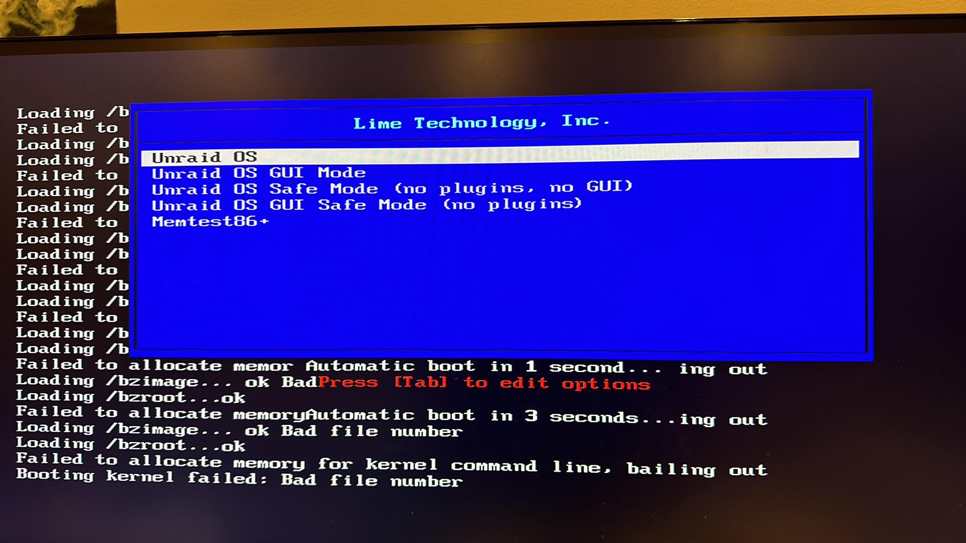

I am having issues with trying out Unraid on my T320, everything is updated to the latest versions, but I keep getting failed to allocate memory for kernel command line, bailing out
Having UEFI boot enable doesn't prevent from booting legacy, that is chosen in the BIOS, but if you leave it disable, you can be certain that when it's booting, it's booting legacy.
