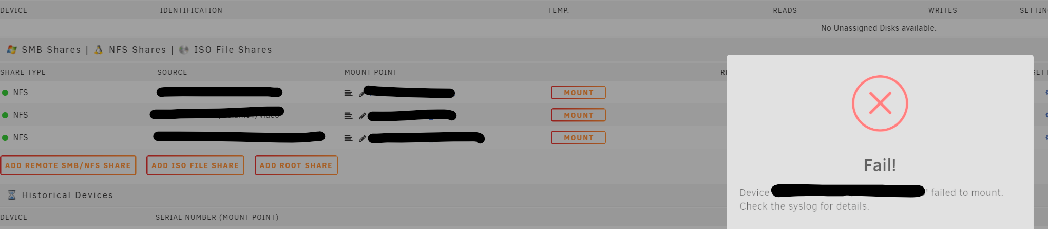

Today I've installed 6.12.9 version and since, I can't mount NFS shares anymore (same for SMB).
I can detect and find the shares I want to add but impossible to mount them anymore.
I've the following message :
Device 'xxxxxxxxxxxx' failed to mount. Check the syslog for details.
and I don't know what or where to check.
Do you know what can I try ? (share are on a Synology NAS, I used them for plex)
Syslog says:  (xxxxxxx = shares name)
Mar 29 21:03:08 Lab unassigned.devices: Mounting Remote Share 'xxxxxxxxxxxxxxxxxx'...
Mar 29 21:03:08 Lab unassigned.devices: Mount NFS command: /sbin/mount -t 'nfs' -o rw,soft,relatime,retrans=4,timeo=300 'xxxxxxxxxxxxxxxxxx' '/mnt/remotes/xxxxxxxxxxxxxxxxxx'
Mar 29 21:03:08 Lab unassigned.devices: NFS mount failed: 'mount.nfs: Protocol not supported '.
Mar 29 21:03:08 Lab unassigned.devices: Remote Share 'xxxxxxxxxxxxxxxxxx' failed to mount.
NFS mount failed: 'mount.nfs: Protocol not supported...   well does it mean I need to downgrade or something ?

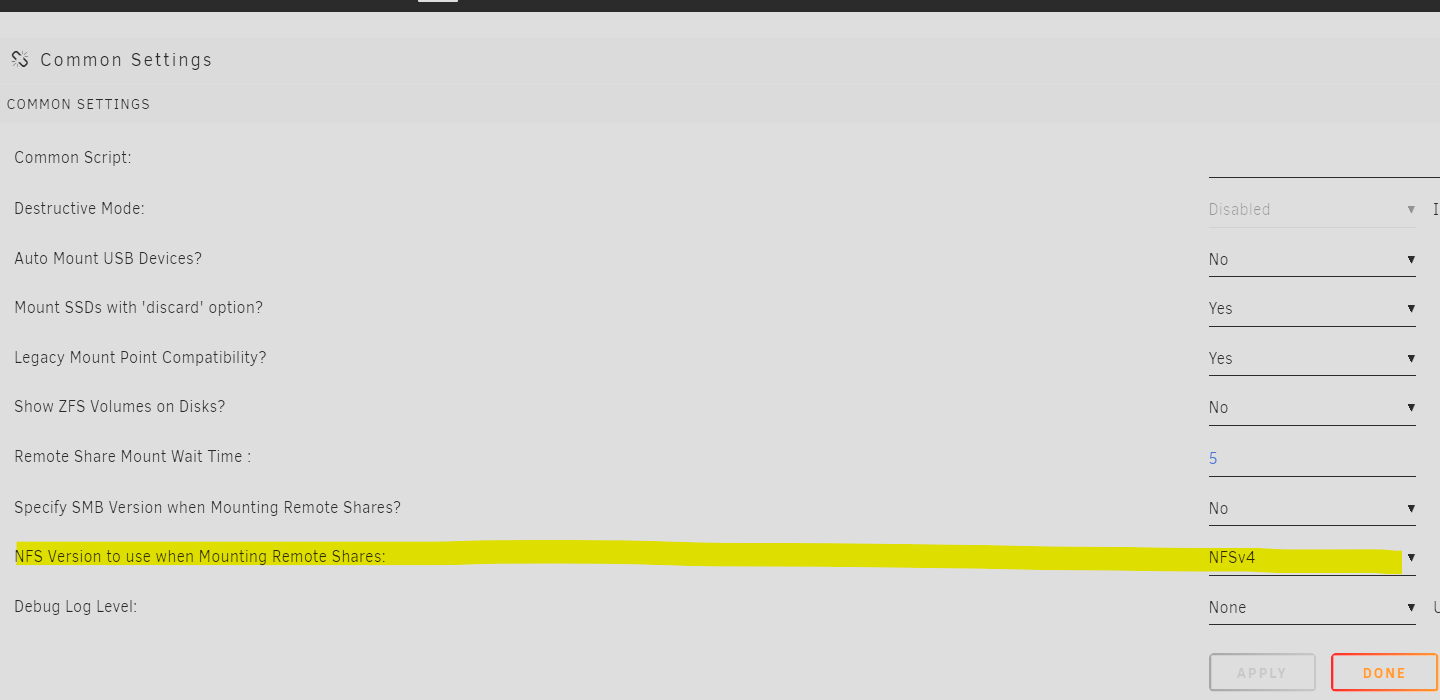

When mounting NFS remote shares, UD uses a setting to request the server for the latest version of the protocol available.  You can force UD to use NFSv4 settings when mounting NFS shares by setting the "NFS Version to use when Mounting Remote Shares:" to NFSv4.  This disables the NFS request for version feature.
There have been some changes in the latest Kernel in 6.12.9 that have probably caused this change in the way this works.
set "NFS Version to use when Mounting Remote Shares:" to NFSv4 fixed the problem for me. My Synology Share is back
Hello, I confirm it solves my problem too.
Many thanks !!

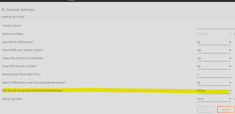

attached a screenshot for those who want to do the same change in 'Unassiged Devices' setting too :
Edited by zarkoff
Ah ok, that's true that I did the change after the update of UD... so at the end I don't know what really solves (update or change in settings), so I suggest you do the both :-).
Thank you.
Ah Ok, so I'll change it back to 'Auto'
