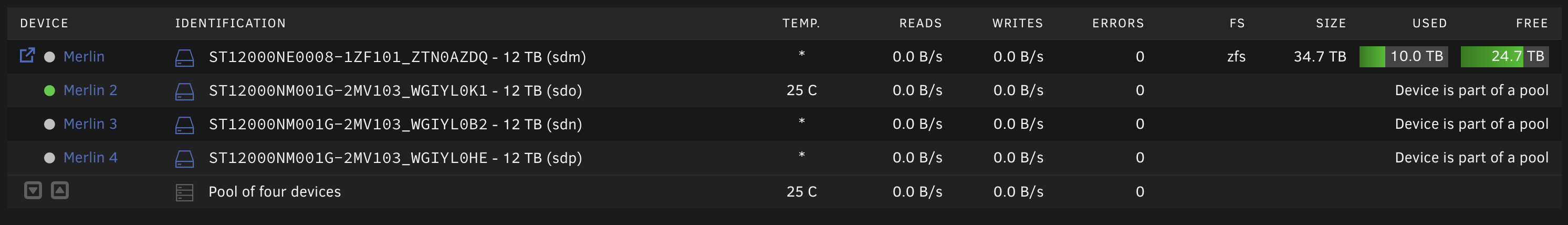

Random single drive from ZFS POOL keeps spinning up...
Unsure of cause.
I though a ZFS pool of 4 disks all need to all spin up at once if anything is accessed.
This is how it usually works if I access any data on the shares on that ZFS Pool..
It may not if it only needs to access some metadata.
