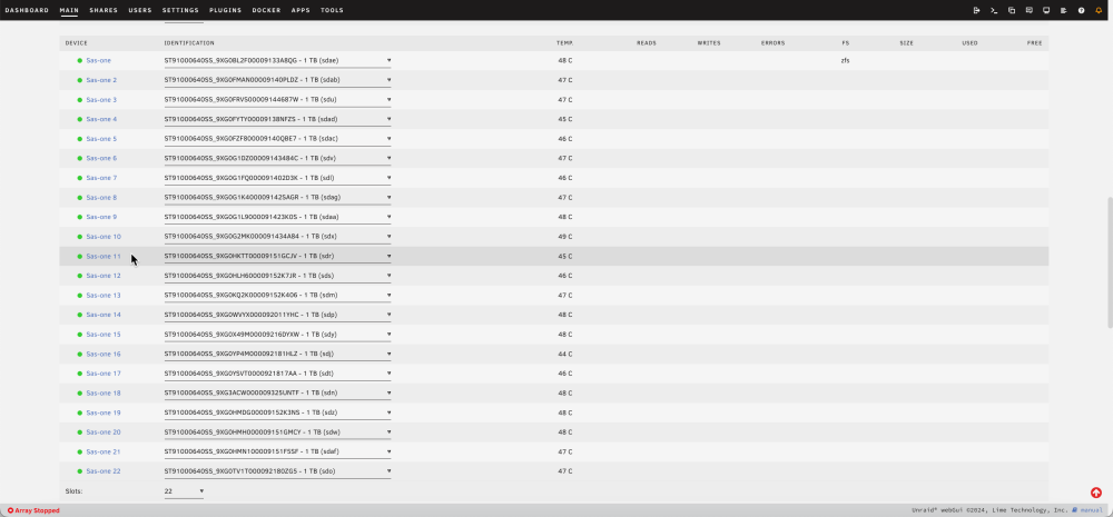

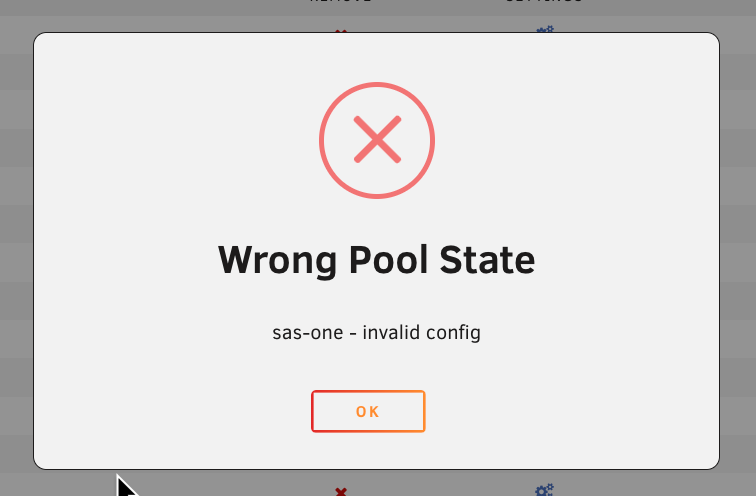

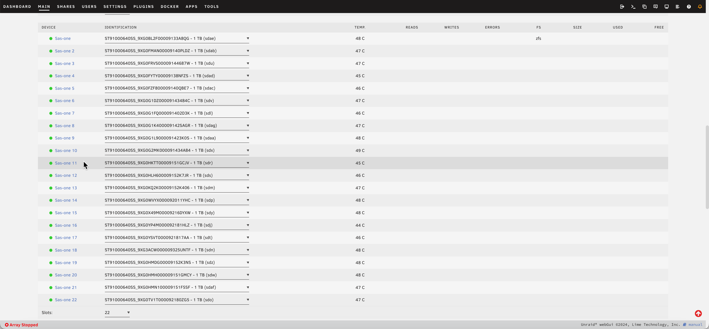

See no errors on Web Page, can not start the array
I noticed this in the log
> Apr  4 19:21:51 SpaceStation emhttpd: sas-one: invalid config: root_slots 44 num_slots 22
