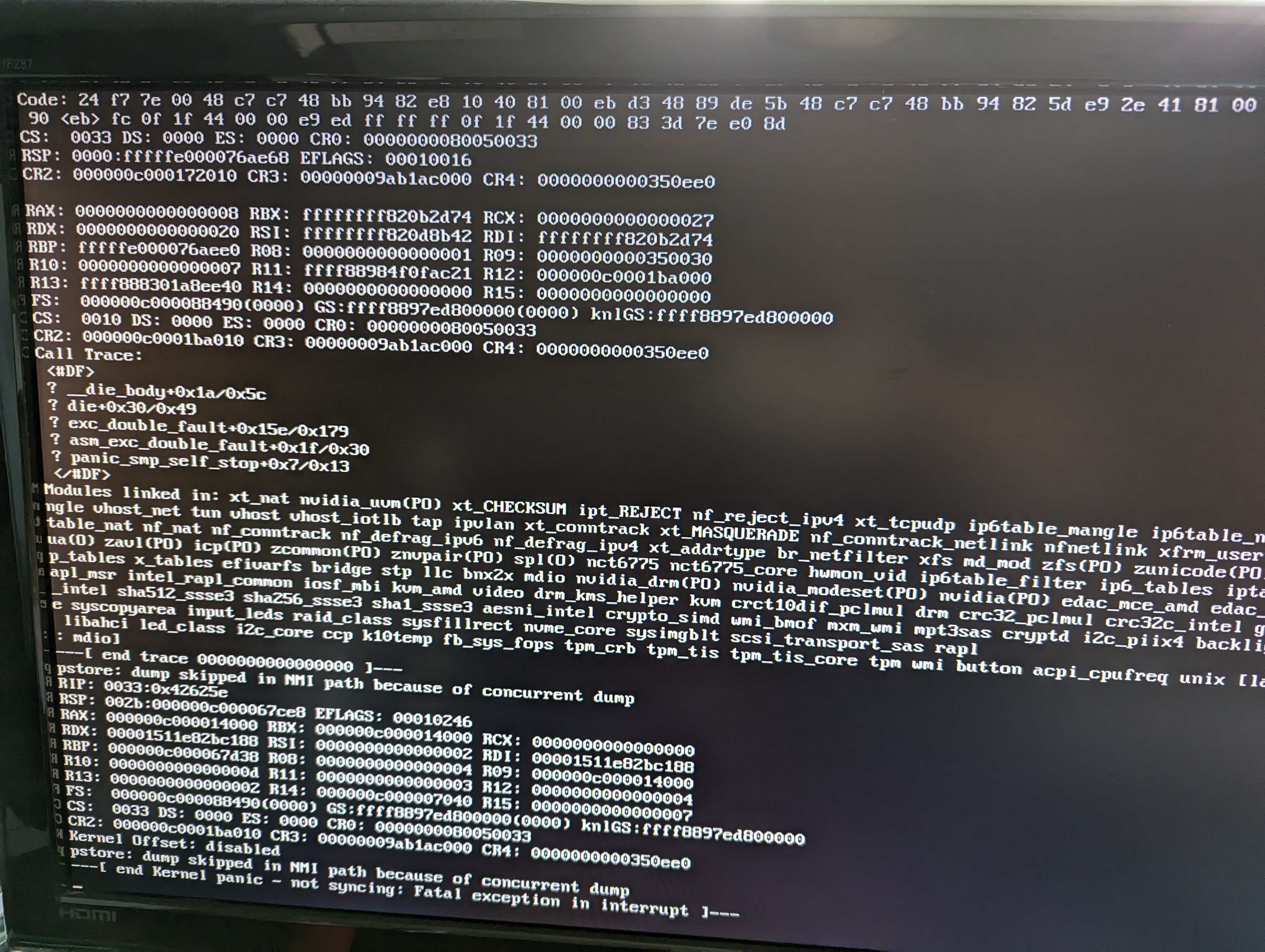

Its just crashed again - now the system doesn't stay up for more than 5 minutes before a panic.
It held on the error screen though...pasting here and then gonna reboot and do a syslog setup

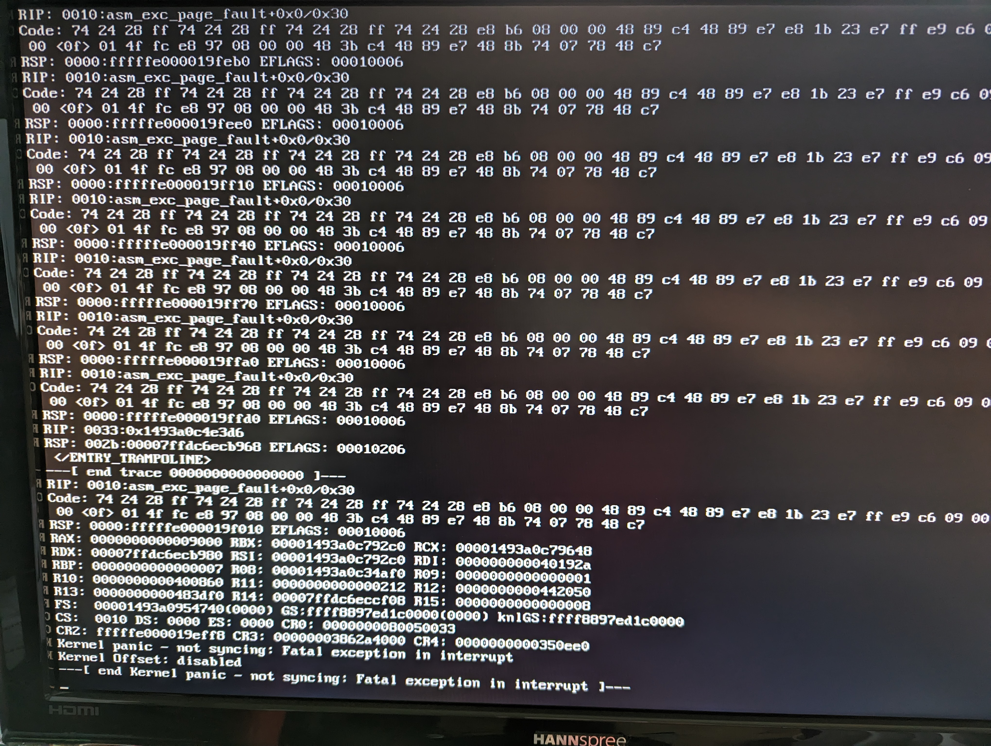

Arrggh...super annoying. Took your advice - disabled all but my plex docker container and things seemed totally stable. It was all fine and dandy. Ended up disabling the syslog stuff as I didn't want any wear and I thought the problem had been cracked. Didn't need the additional dockers anyway so was content to leave it like this.
Then just a minute ago I come back to a kernel panic. Took a photo of the screen in case there is anything it can allude to, but otherwise think this is either the plex docker container or just a hardware issue and I'm gonna have to rebuild the whole thing to figure it out.
Photo attached - All help appreciated
Plex container has been known to crash servers, seen it multiple times in the forums recently.
Just done a search and yea seems to be a thing at the moment. Will keep an eye on those threads, and update this one if there is an answer there.
