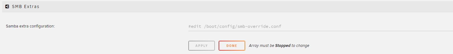

this is why the extras smb exisits.
array has to be off to edit.
[unraid]
        case sensitive = Auto
        comment = full array share
        path = /mnt/user/
        read only = No
        fruit:encoding = native
The array must be started for this to work, which is why I recommend running a manual smb config. to guarantee a smooth startup with out errors.
