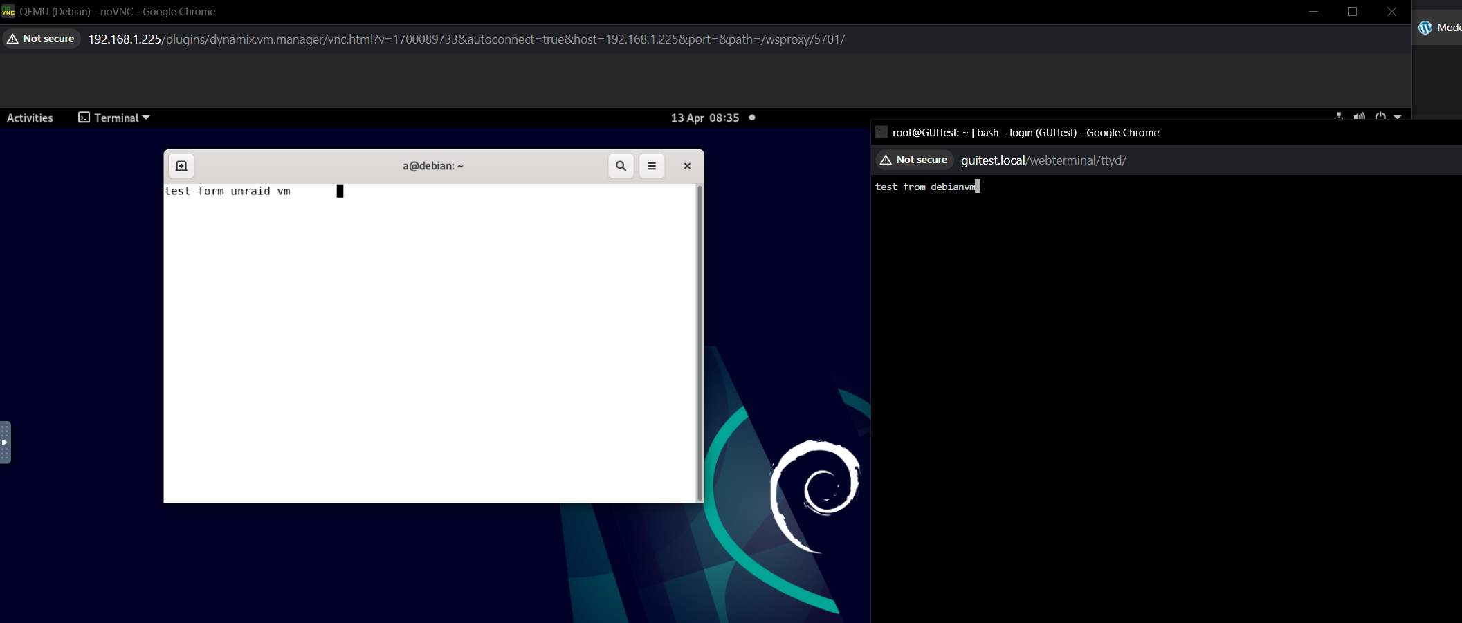

I have been able to get this to work.
To get socat for 6.12 do, if extra does not exist mkdir /boot/extra
cd /boot/extra
wget      https://slackware.uk/slackware/slackware64-15.0/slackware64/n/socat-1.7.4.3-x86_64-1.txz
installpkg socat-1.7.4.3-x86_64-1.txz
For next release will need to be 1.8 this version is not compatible with 6.12.
wget https://mirrors.slackware.com/slackware/slackware64-current/slackware64/n/socat-1.8.0.0-x86_64-1.txz
You only need to install once downloaded. Packages in extra get loaded at boot.
This is the XML added to each VM.
Debian
    <serial type='unix'>
      <source mode='bind' path='/tmp/foo'/>
      <target type='isa-serial' port='1'>
        <model name='isa-serial'/>
      </target>
      <alias name='serial1'/>
    </serial>
Unraid-VM
      <source mode='bind' path='/tmp/foo2'/>
      </target>
    </serial>
Then run -dd is only to give debug data.
root@computenode:/usr# socat -dd  UNIX-CLIENT:/tmp/foo  UNIX-CLIENT:/tmp/foo2
2024/04/13 08:22:30 socat[17649] N successfully connected from local address AF=1 "\0\0\xEE\0\0\xEE\0\0"
2024/04/13 08:22:30 socat[17649] N successfully connected from local address AF=1 "\0\0\xEE\0\0\xEE\0\0\xEE"
2024/04/13 08:22:30 socat[17649] N starting data transfer loop with FDs [5,5] and [6,6]
