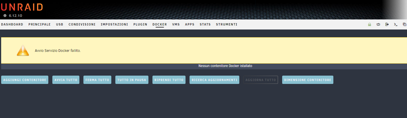

Docker engine error
every 2 days i have this problem - docker service failed to start...and i have to restore a backup of usb key...
how can i solve?
thanks

Edited by Lordbye
Solved by JorgeB
2 hours ago, Lordbye said:
Apr 12 09:43:17 LordbyeNas kernel: SQUASHFS error: xz decompression failed, data probably corrupt
Apr 12 09:43:17 LordbyeNas kernel: SQUASHFS error: Failed to read block 0x28885fc: -5
These usually mean a flash drive problem.
ouch..again? i have to change usb key every 6/8 months :/
ok i'll try to buy another usb key and reload
thanks
there is some command line that i can use to
fix the situation while waiting for a new key
