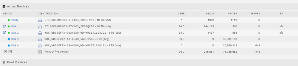

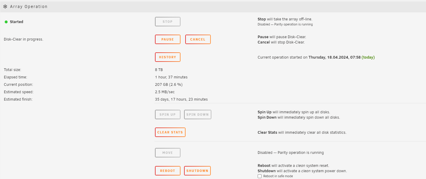

after adding a couple of drives to my array I seem to have an issue with the time of pre-clear, for some reason its incredably slow, is there any way I can speed this up or should I just wait? 35 days seems like a very long time...
I can see that I have some errors on the 3TB drive, but not sure why the 8TB drive is so slow:

I am guessing from the diagnostics that you mean Clear on disk4?   If that is the case you are getting lots of write errors and resets on that drive and in the diagnostics and it appears to have gone offline.   I would suspect a cabling issue (power or SATA) but it could be the drive itself but as it is offline we cannot see any SMART information.   You will almost certainly have to power-cycle the server to get that drive back online.
Yes,basicly what Im trying to do is add 2 drives at the same time, but I guess thats whats failing atm.

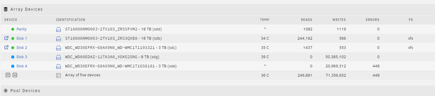

To give you a perspective of what Im seeing in unraid now:
Atm Im a bit stuck with deciding what to do, should I cancel the disk clear, stop the array and remove the faulty drive? Would that increase the speed of adding drive 3?

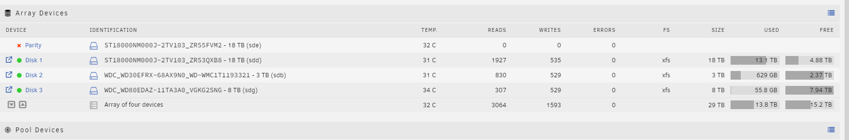

Hmm, got the array stopped but now my partity drive is disabled, will try a hardware reboot and see if that fixes the issue. edit: Nope, damn, seems like my disk1 died on me during the process.... Cant see it in the bios either....
Weird thing is, disk1 smart info reports no errors. Anything I can do about this?

I ended up starting the array without a parity disk and reassigned the disk to the array, so now just need to wait for the rebuild. Oh well, I guess it was time anyways
