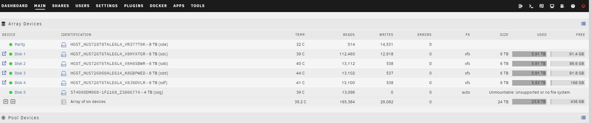

Looks like the drive is part of the array now but after the pre-clear of the drive it is unmountable. How to fix this. If it is not fixable how can I remove this drive from the array and toss it?
This is a new array disk right? New disks added to the array need to be formatted before use, next to array stop button.
It used to be part of the array and I replaced it with a larger 6TB disk. Then I bought the SATA controller and added the disk back into the server. Added it to the array and Unraid began wiping it (took like 24 hrs). Once complete it shows as unmountable.
I thought the wiping of the disk was the same as formatting. I need to run the format?
Yes.
Nope. Wiping the disk writes all zeroes, removing any traces of files or filesystem formats. Think of a format as a filing cabinet with drawers and folders. It allows files to be stored in an organized fashion so they can be easily retrieved, as opposed to just tossing the files on the floor in an empty room. Filesystems take up space even when there aren't any files stored.
