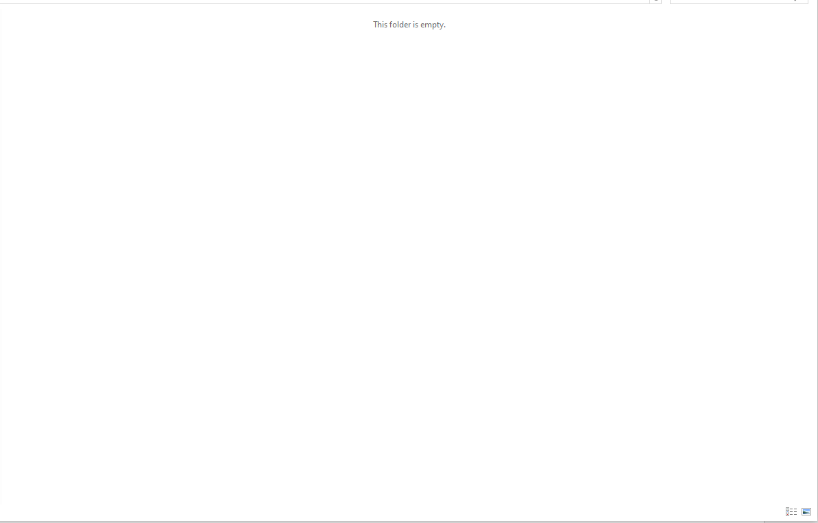

Here's a screenshot of what Im seeing after I enter in my credentials -
What was the path for that screenshot?
The path would have been //server-fast (It matches the name I set in the host file)
