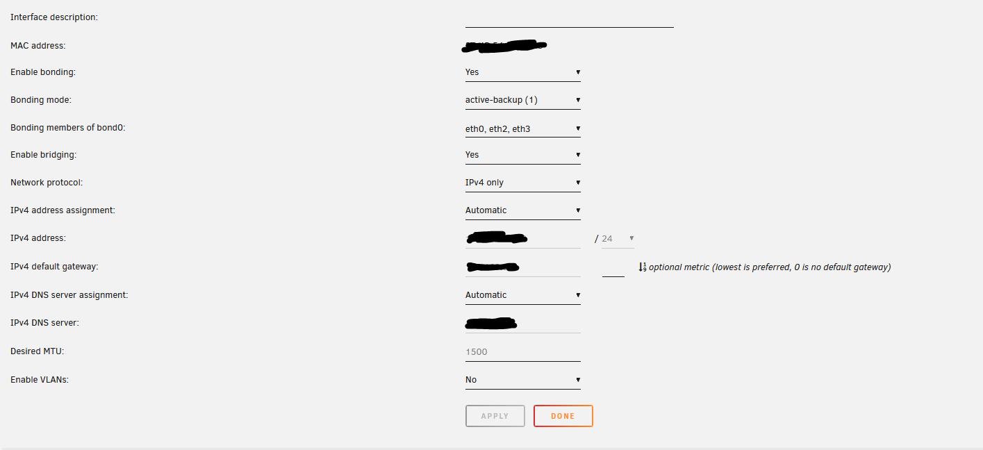

Hi, I've rececntly moved all my computers back downstairs and I found when I connected it all up again I cant access my unraid server from my windows machines. I've tried deleting the network config files and copying my backed up config files but I still cant seem to connect to my unraid server. Not sure if I didnt set it up correctly in the first place? Ive attacthed my system logs here as well. Here's an overview of how my network is setup: Overview of the computers I have: Working computer - Windows 10 machine - Windows Machine where I do all my work Unraid server - which Ive set up to hold all my files Render computer - Windows 10 machine - an extra computer that I have that I use for rendering Backup computer - backup machine which is soley used to backup the unraid server How they're all connected: Currently Im using this switch QNAP QSW-M408-2C which I've connected all of the above computers togther using a 10gbe card (Asus XG-C100C) On the config side: To setup my unraid server I followed this tutorial - Howevever I should note he assigned static IP's in unraid and on the 10gbe cards which I didnt do (at least from what I understood) Here is a screenshot of my unraid network settings: Not sure what Im doing wrong? Or if Ive correctly setup my unraid server. Any help would be greatly appreciated thanks! tower-diagnostics-20240626-1900.zip

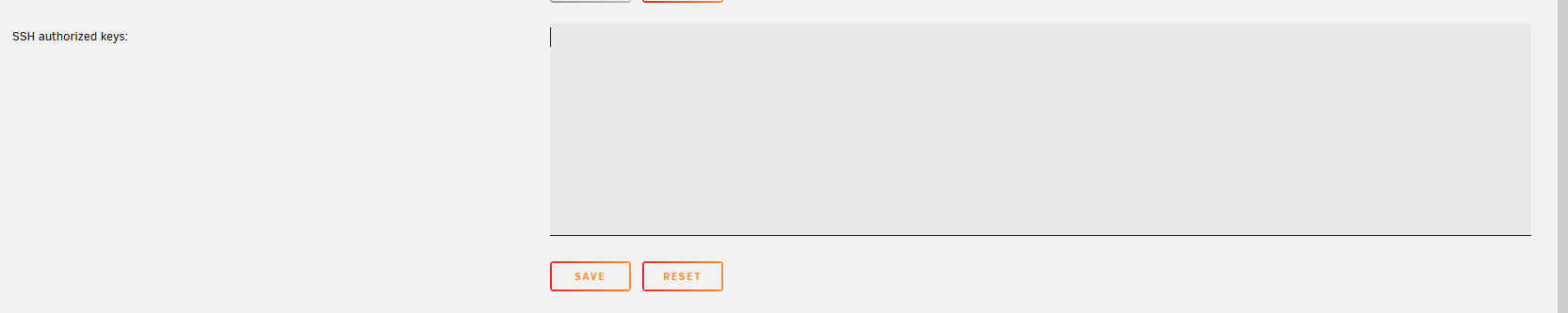

Is there a way I should be doing this? I thought it would connect to the main server once Ive run the task? I also noticed under Edit user in Unraid for the root user on my foreign system I dont see any SSH authorized keys displayed like I see in the backup server?

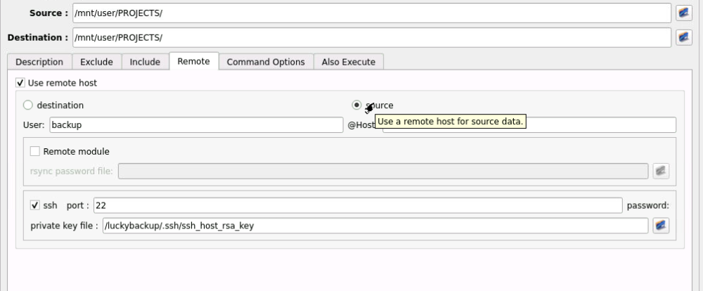

All good thanks for your help! Maybe it’s something I’ve done wrong in your steps. Here’s what I’ve done: On the backup server I went to: /luckybackup/.ssh and opened up the file: ssh_host_rsa_key.pub Copy the contents of this file Then on the main server (foreign system) created a file: authorized_keys.txt in the directory /root/.ssh Pasted the contents of ssh_host_rsa_key.pub into the authorized_keys file and saved it on the main sever in /root/.ssh Go to the luckyBackup container on the backup server Set up a new task with the settings in the screenshot
