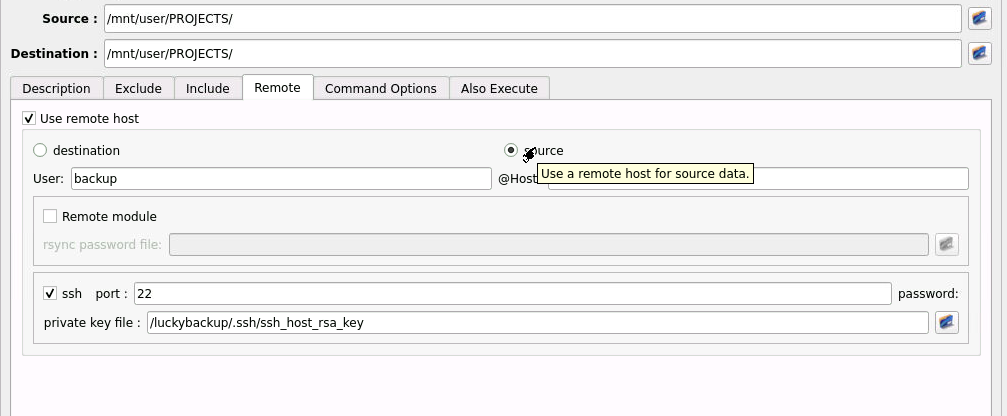

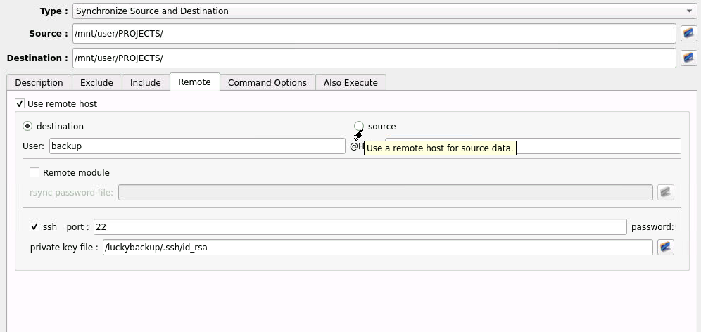

All good thanks for your help! Maybe it’s something I’ve done wrong in your steps. Here’s what I’ve done: On the backup server I went to: /luckybackup/.ssh and opened up the file: ssh_host_rsa_key.pub Copy the contents of this file Then on the main server (foreign system) created a file: authorized_keys.txt in the directory /root/.ssh Pasted the contents of ssh_host_rsa_key.pub into the authorized_keys file and saved it on the main sever in /root/.ssh Go to the luckyBackup container on the backup server Set up a new task with the settings in the screenshot

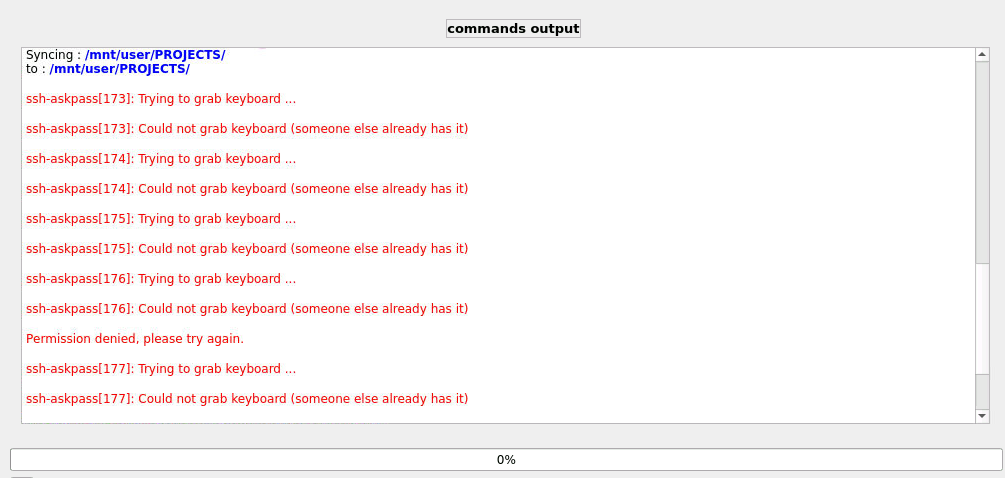

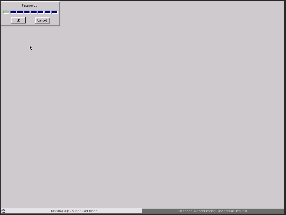

Hi!! I manged to get it working but it still seems to prompt me for a password? Which keeps popping up anytime I enter the password for the backup user on my server

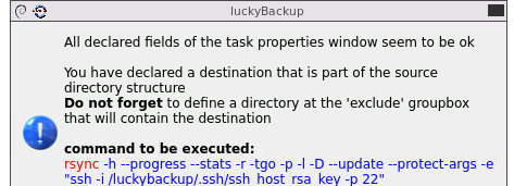

Hmm I still seem to get the same error when I create test share with a file on the source server? When I run validate though I dont get any errors indicating the direvtory doesnt exist

Thanks for your reply! backup@<IP address>:/mnt/user/PROJECTS is the source Ah yes good idea thanks!
[Support] ich777 - Application Dockers
Hi! I've followed your steps above just wanted to confirm if this is what I was meant to do for step 6? As I seem to get an error saying backup@<IP address>:/mnt/user/PROJECTS does not exist?

Thanks for your quick reply! In the guide it says to create the id_rsa on the local machine (which is my main server where I have luckybackup installed) and then copy it to the remote server (which is my backup server) Yep I have done that I created it under /luckybackup/.ssh on the local machine and then in the guide he copies it to the remote machine which is where I have it under /root/.ssh Yep I did that that the authorized_key is on the remote machine Unless I should have installed luckbackup on my backup server instead of the main server?

Hi, I'm using Luckyback to back up my main server to my new backup server using this guide - https://unraid.net/blog/unraid-server-backups-with-luckybackup However Im a bit stuck, when I run the Task I created to back up my main server it prompts me for a password which when I enter it seems to accept it but then the OpenSSH Authentication Passphrase request window will pop up again and that happens a few times and I get the below errors: I created the id_rsa file under /luckybackup/.ssh and then copied that file to my backup server in /root/.ssh. The authorized_keys file is also in /root/.ssh on the backup sever. Not too sure where I'm going wrong? This also how Ive set up my task: Any help would be greatly appreciated thanks!
