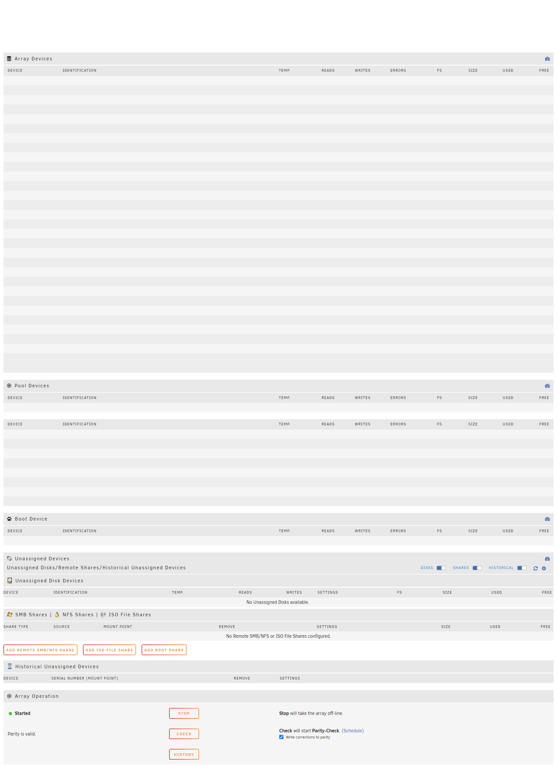

Good Day,
I have an issue where my array devices in the gui is blank after starting the array. I would be so grateful if someone can point me to a resolution to this issue. I have restarted many times and disabled the theme I previously had in efforts to fix this. Also, I am using a usb3 flash drive but I have tried both usb2 and usb3 ports but no difference. I have included a pic for reference as well as my syslog.

Is is the same if you boot in safe mode and/or use a different browser?

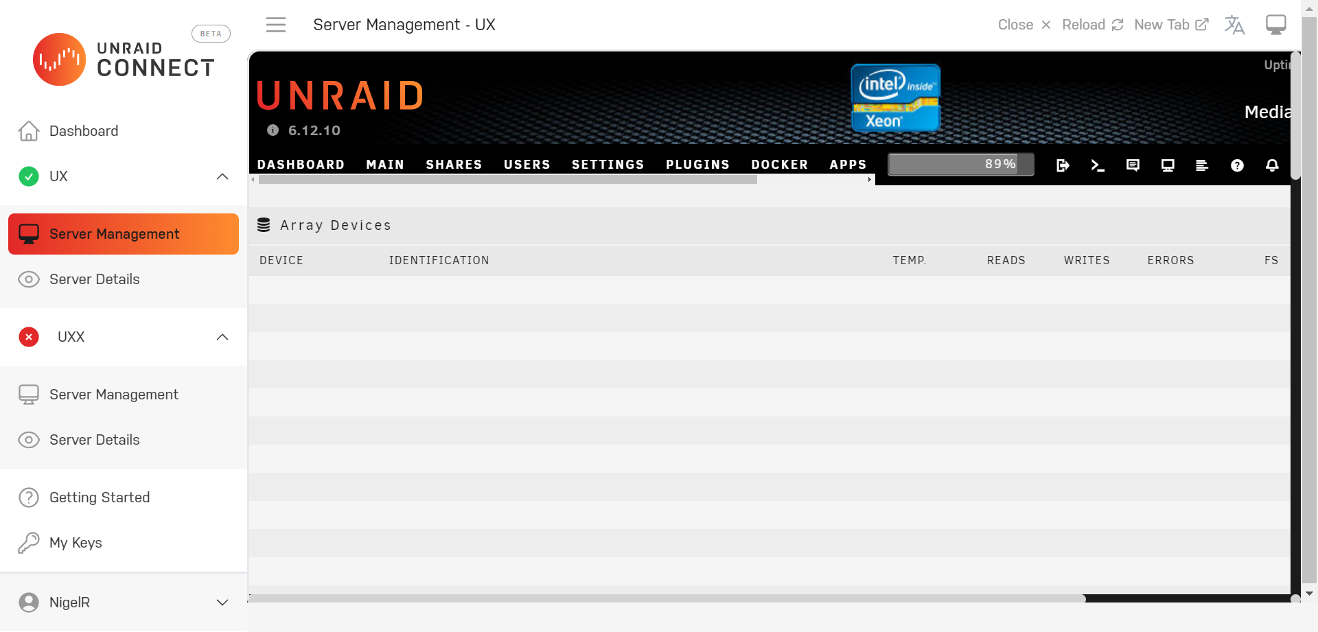

@JorgeB I used both chrome and edge with the same result. I did not boot into safe mode but will try that next. If I boot into gui mode on the host server, I get the same issue. I just tried to access the server from connect and get the same issue as well.
Quick update, I tried safe mode. The array devices initially show up after starting the array but soon disappear giving the same result.
Do you have an adblocker or anything else that might interfere?
This issue has been affecting some users for a while, unclear what's causing it just for some, but I'm afraid I don't really have a solution.
@trurl No adblocker installed.
@JorgeB I may be doing some hardware upgrades over the coming weekend. Can I reinstall a previous version of unraid to my existing USB drive, copy my license file to the config folder and set back up my array? Is that advisable in this case?
I'm thinking 6.12.6 from December.
