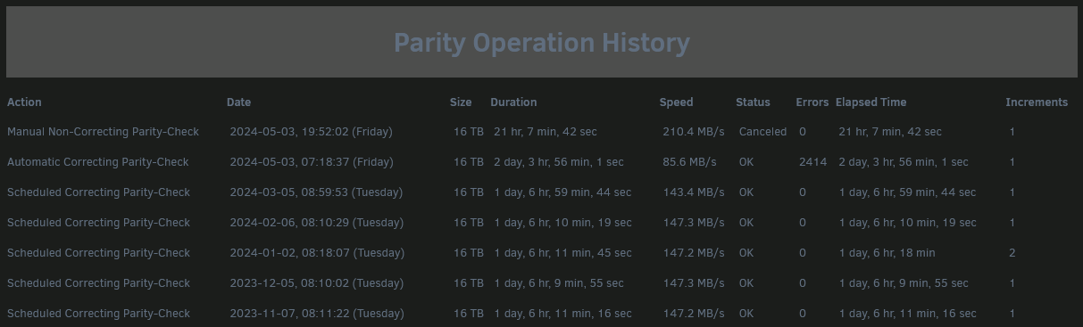

14 hours ago, JorgeB said:
Parity check related notifications have been known to sometimes be wrong, they show the previous results, according to the previous-syslog there were sync error, but they should now be corrected.
You can always look at the "History" stats on main, the stats for the last check will be correct there.
Here's what the history looks like :
I'm running another parity check right now, we'll see.
