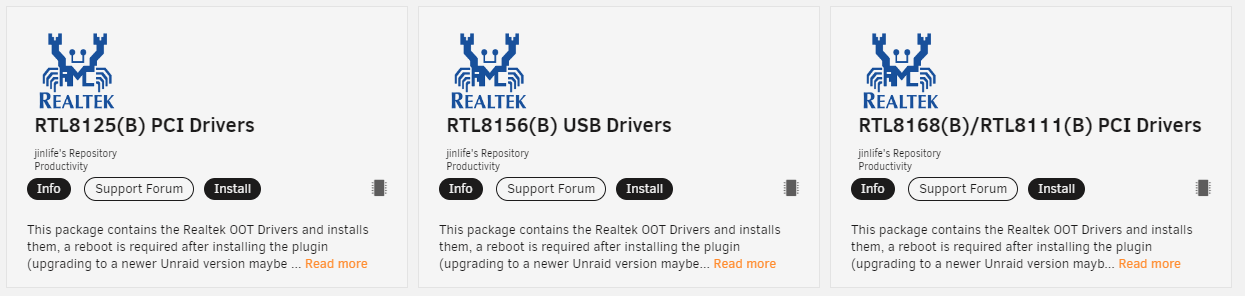

Reviewing the specs on the gigabyte board you may have needed a unraid plugin driver installed to use the 2.5 realtek nic:
https://www.gigabyte.com/Motherboard/X570-AORUS-MASTER-rev-10#kf
Realtek® 2.5GbE + Intel® Gigabit LAN with cFosSpeed
the 3rd driver option search for realtek...
