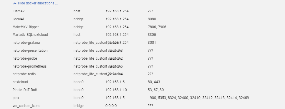

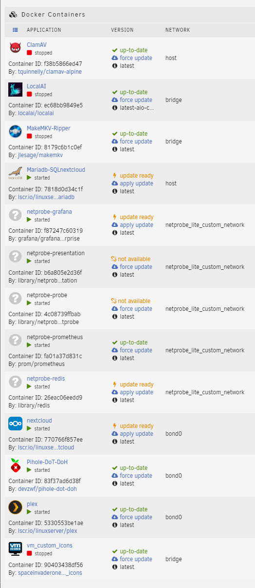

It comes down to templates, docker communication and use case. As you can see with my docker selection. Some items are in their own docker network that I created.
Others are using unraids default macvlan setup and have a static IP they are using bond0
Others are using host and share ports but are direct connected to unraid and others are using the docker default bridge.
So when you make a docker, it's imports to choose the network:
It is also important to not duplicate ports on the same network you chose. if you chose custom bond0/br0/eth0 you don't have to worry about ports as they are assigned to the ip addresses. Whereas if you have multiple default networks the ports can become in conflict as the ip to access them is unraids host ip, and we can't use the same port multiple time.
host:  replaces unraids ports and if you replace critical port features with host you can brick the machine. (Normally for databases...)
bridge: Is the default network setting... this bridges the ports for the docker to unraids IP (if you have port conflicts it is recommended to move them to a custom or isolate them in there own networks.
netporbe: This is another default docker bridge I made for these dockers to isolate them to talk to each other in that network. Similar to bridge, it bridges the unriad ip to access them.
bond0: this is my unraid custom network docker. Unraid settings bridging off, bonding(mode 1) on then docker setting custom network macvlan and host access enable
^this is a macvlan setup that gives each docker its own random mac address and lan IP static to be used next to unraid over unraids interface. so if unriad is at 192.168.1.254 i can set a docker using this network to 192.168.1.x and to access that docker i go to 192.168.1.x
