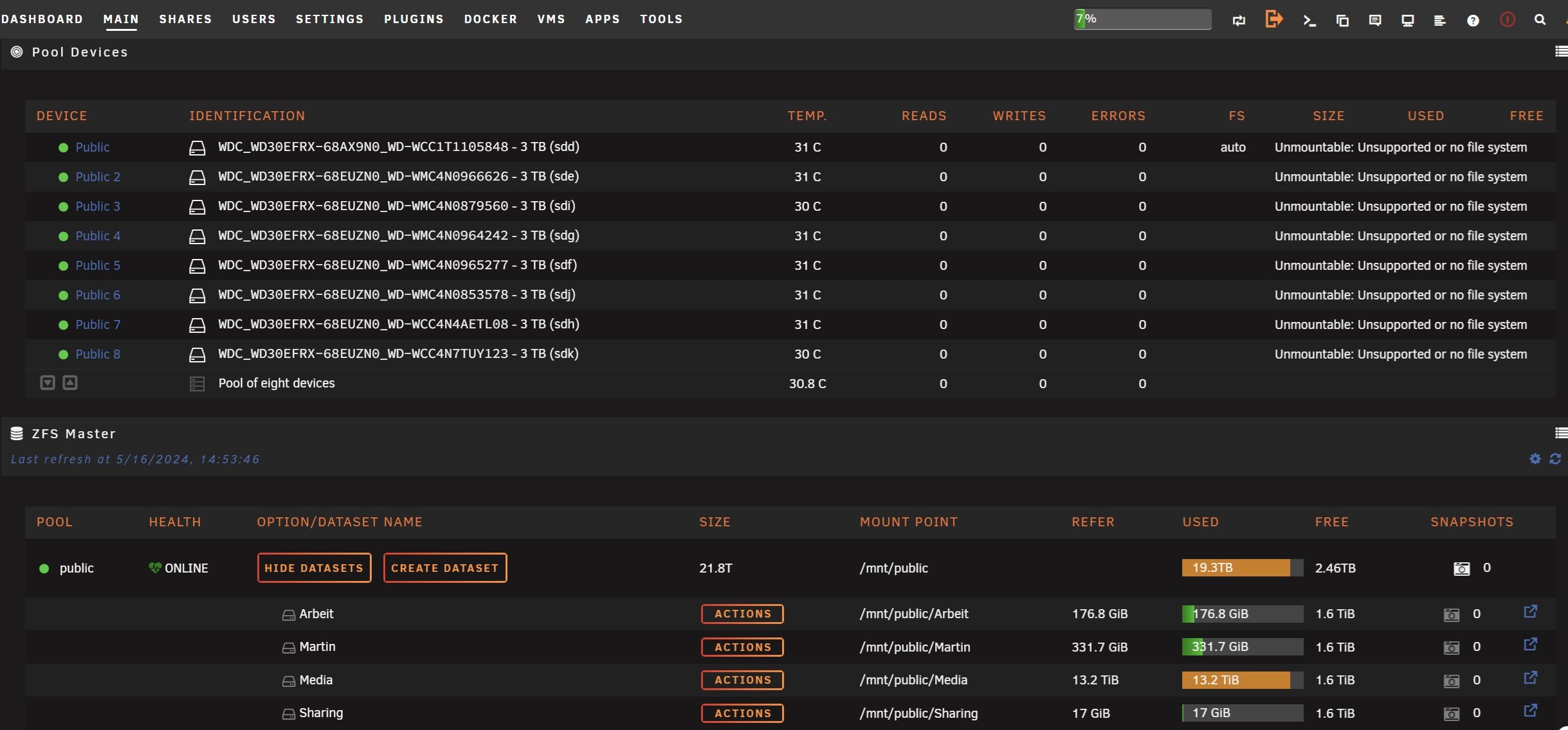

One thing bothers me though, after every restart of the server, the ZFS pool is no longer available. Every time I have to go back to the terminal and use “zpool import [poolname]” to mount my pool once again. Personally, I don't have a problem with this, but I can't imagine that this is correct.

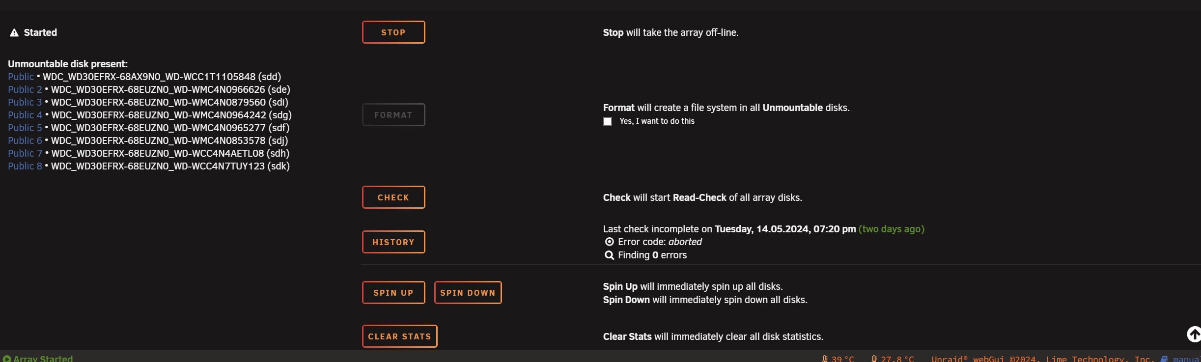

  2. create my ZFS PoolDevice in the WebGUI in the same order as it is displayed in the ZPool status,
  3. Start array
  4. Insert pool in the terminal via zpool import [poolname]
I did it exactly in this order, but unfortunately it does not work. I need some more support here.
I have attached the diagnostics and 3 pictures of what it looks like in the overview.

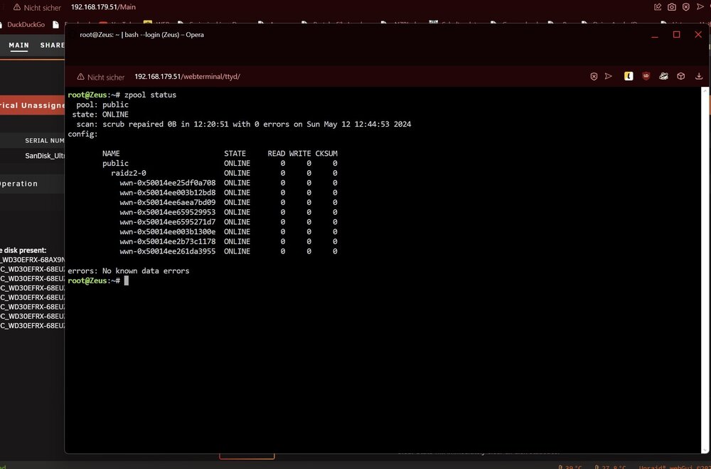

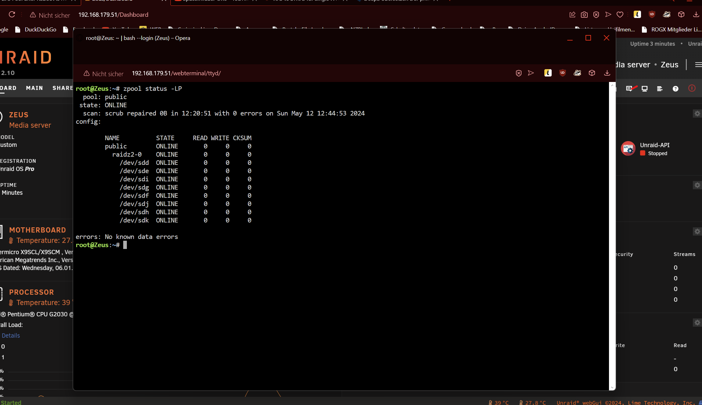

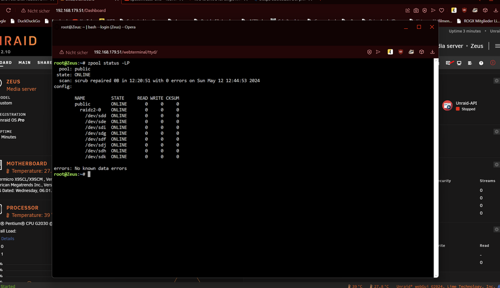

Import the pool manually and post the output of
zpool status -LP

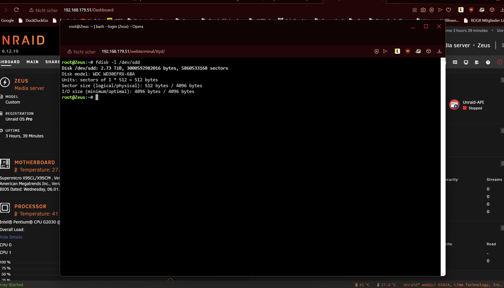

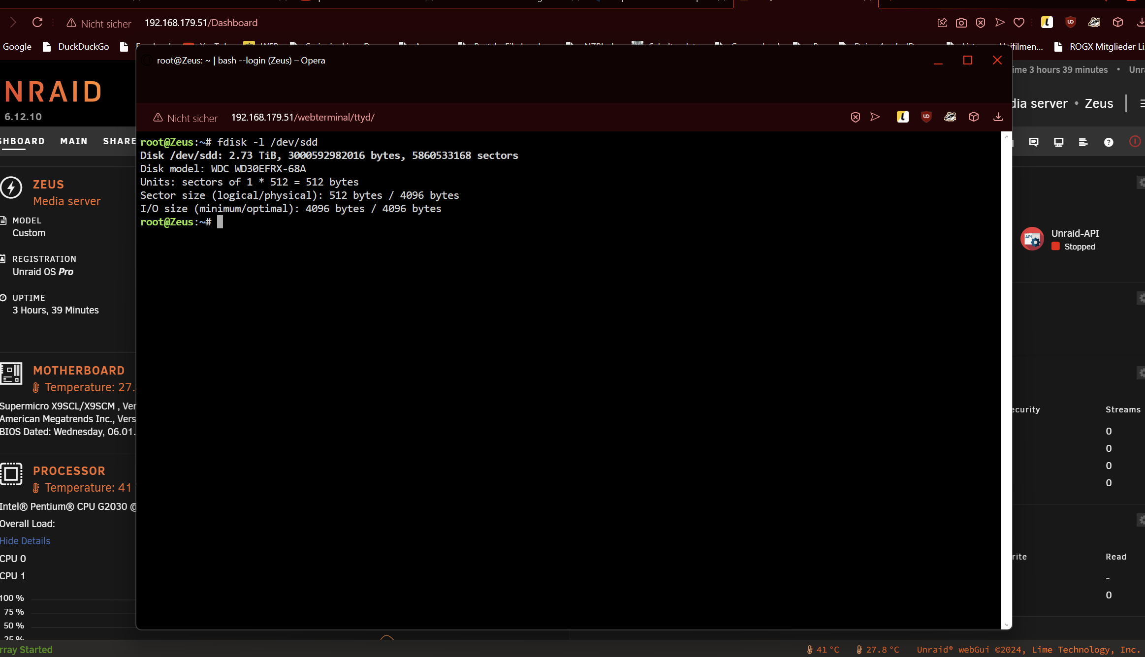

And now the output of:
fdisk -l /dev/sdd
Just wanted to confirm, but as the first output suggested you are using the whole devices, no partitions, Unraid requires that zfs be on a partition.
How was the pool created? Both TrueNAS and using the command line create partitions, even if you give it the whole devices.
The partitions were created some time ago with Nas4Free, today's XigmaNAS. After that I switched to Ubuntu and now to Unraid.
Unfortunately that pool won't work with Unraid, and AFAIK it's not possible to switch from whole disks to partitions, because they should always be a little smaller, so you should not be able to degrade the pool and replace one disk at a time (or two since it's raidz2) with a partitioned one.
