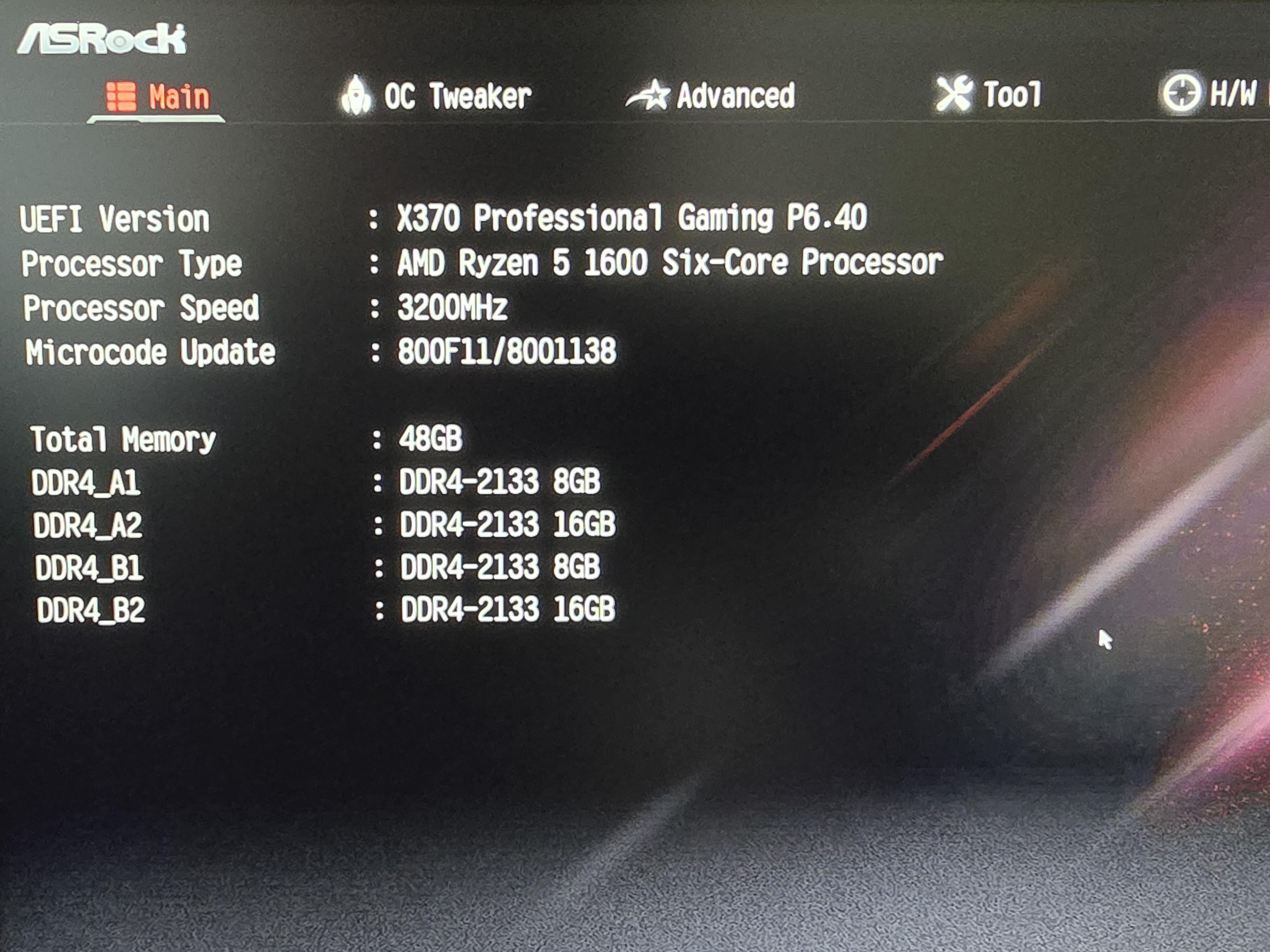

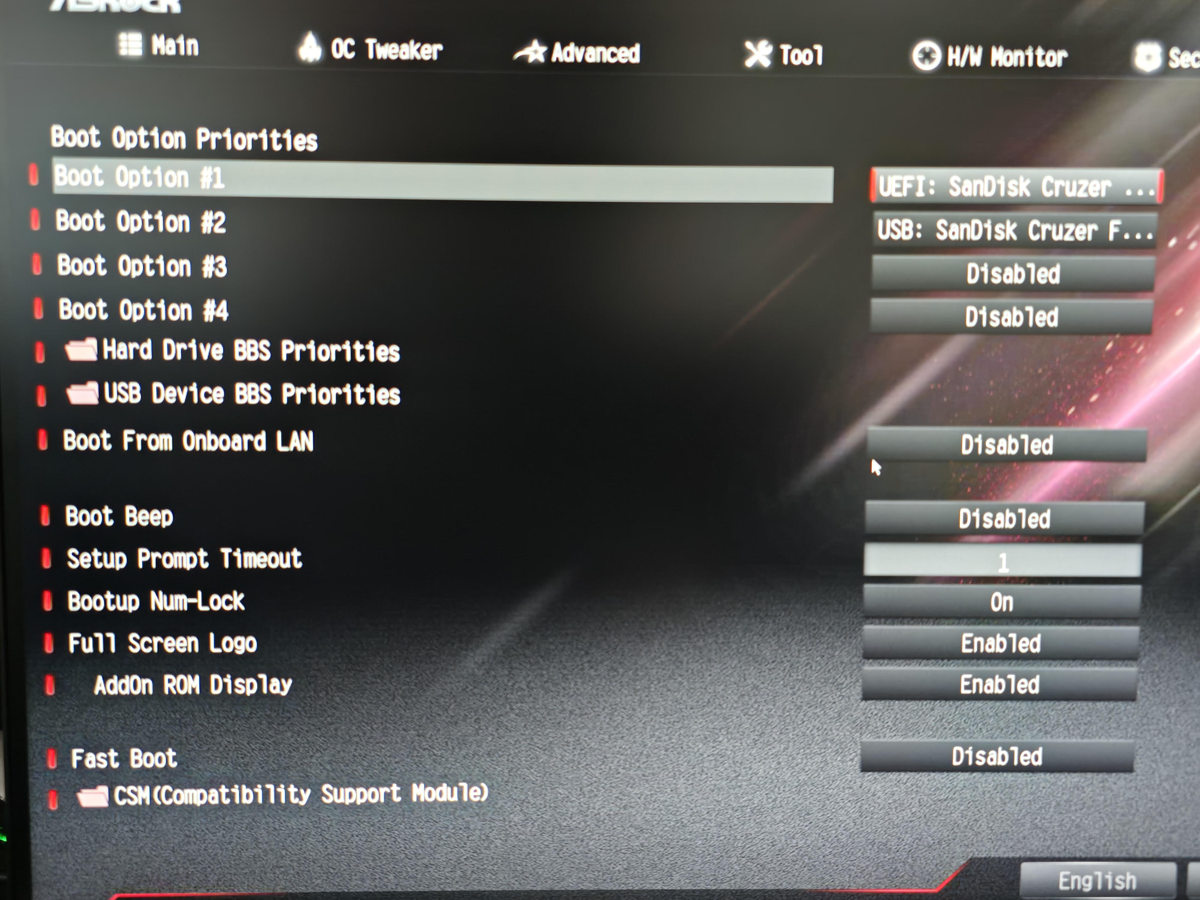

Help! Went to reboot my server this morning and after the BIOS screen all that pops up is "Boot error." I restarted into BIOS and made sure that my USB EUFI drive was #1 boot device but that didn't help. My BIOS is also showing all my drives are connected and all sticks of RAM show up. I deleted everything off my USB and copied over everything from a backup made on 5/5 that I know for a fact works because I had to restore from it last week. All I've changed since that last backup is install a few dockers. Any suggestions on what may be the issue that I can try. Thank you in advance!
I just tried loading my backup onto a different USB device and Unraid booted like normal (except for the unregistered USB device license key error from Unraid). What could be wrong with the SanDisk USB drive I've been using for years that would make Unraid not boot anymore but me being able to write and copy to it on my laptop with no issues?
Did you run chkdsk with your laptop on it?  Have you since tried to boot from it?
