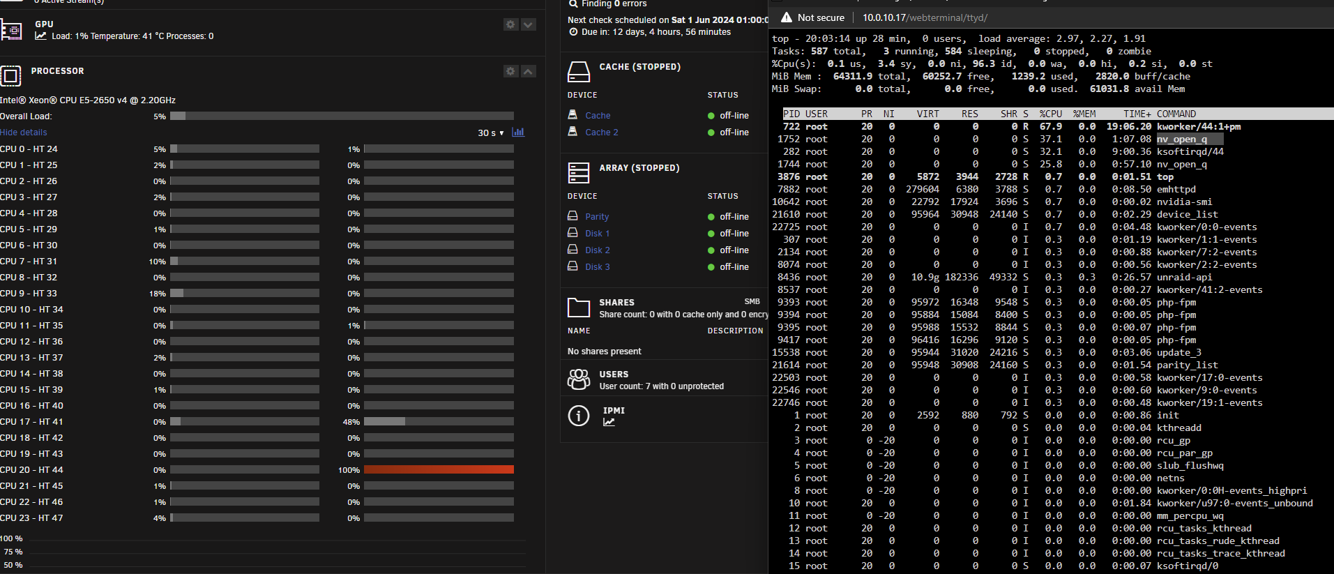

CPU 100% on 1 Core ?? Array not even running Still Happens Help advise

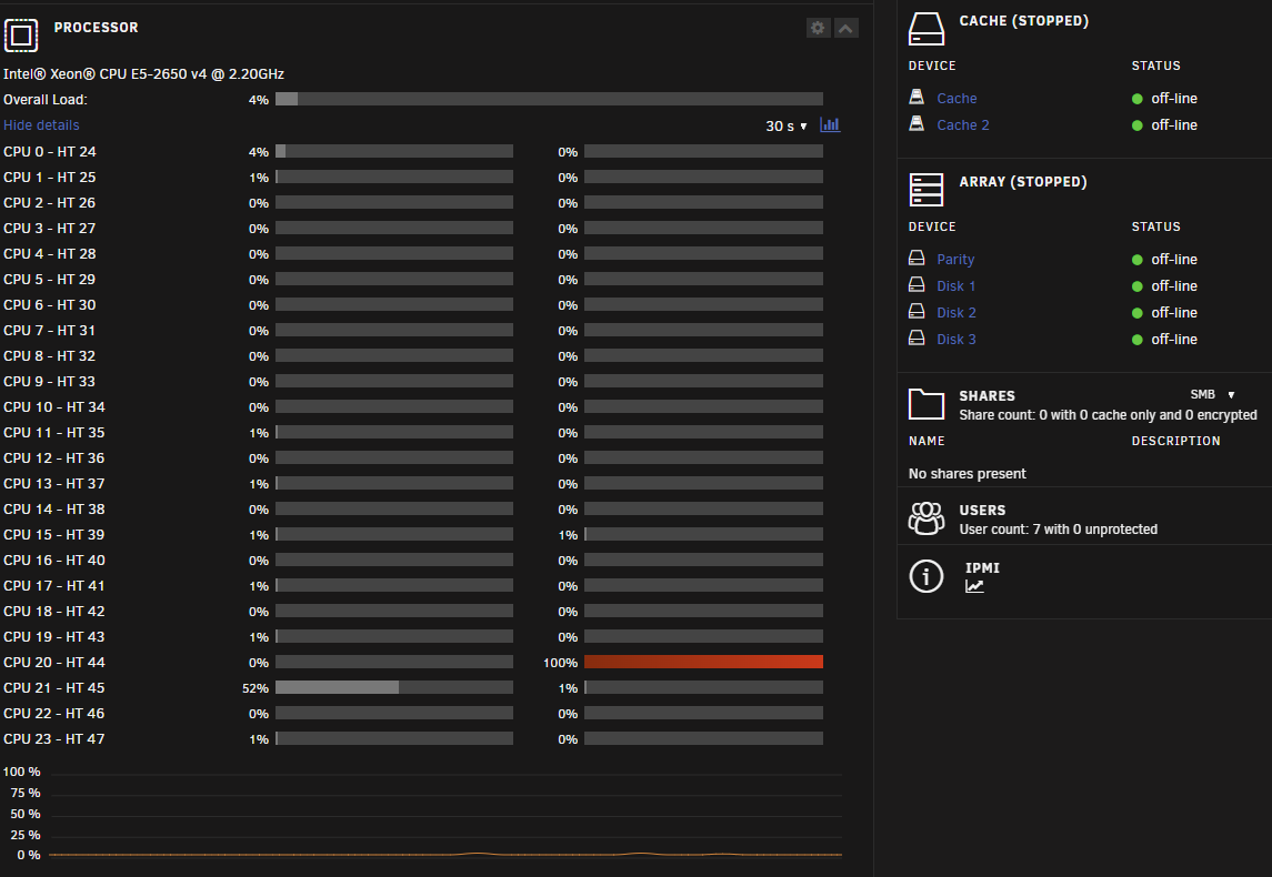

Hi All
Need some advise or what could be causing this i Keep getting one Core stuck on 100 % even when the array not even started or running . this is my second Unraid server and the other one is working fine.
I have one Docker Plex with GPU installed
one VM Windows runs no issues but keep noticing one core at 100% even before i started the Array or any Docker or VM some time it happens after i started them also random Core as well
attached Screen Shots and Diagnostics for the smart people to dive in ....... this starting to drive me mad as i double check remove cards move them etc as all working from other server when install in another PC before i move it across.
Unraid Version 6.12.10
Many Thanks
Bannie

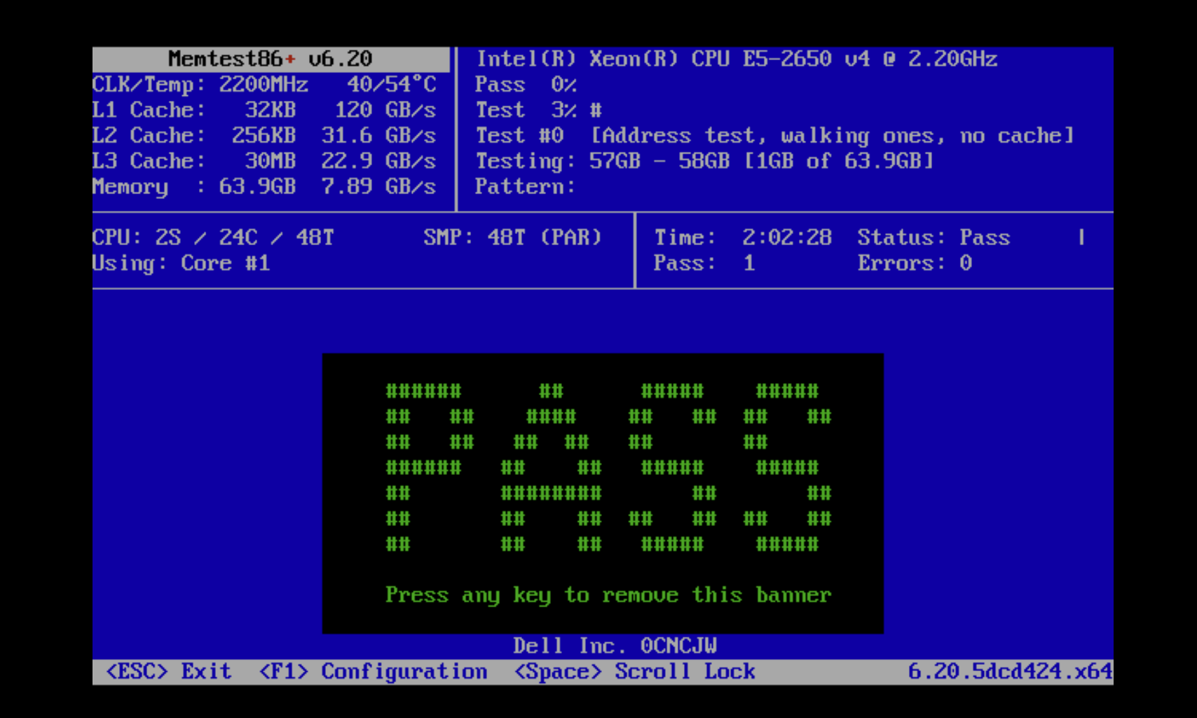

Signs of a core thread stuck and it's a bug caused by potential hardware failure in memory. the cpu was sent a task that it got stuck on so the cpu core locks and becomes 100% as displayed.
Please run mem test.
Thanks for the reply i try mem test ..... just a bit odd as was runs windows Server 2022 fine with no issues on for a few weeks and VMs with no signs on cpu thread at 100% ...... i let you know if it does or does not see any errors .

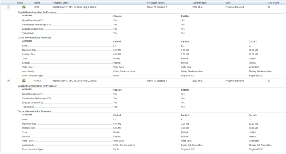

Run Memtest no issues PASS .....
CPUs Set as Stock .....

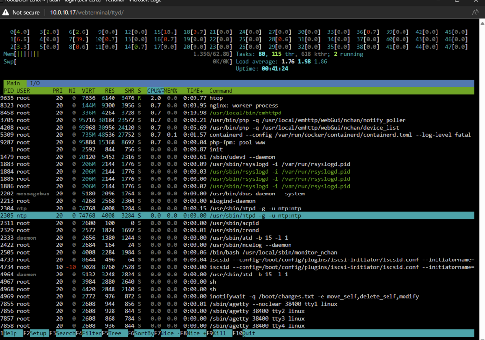

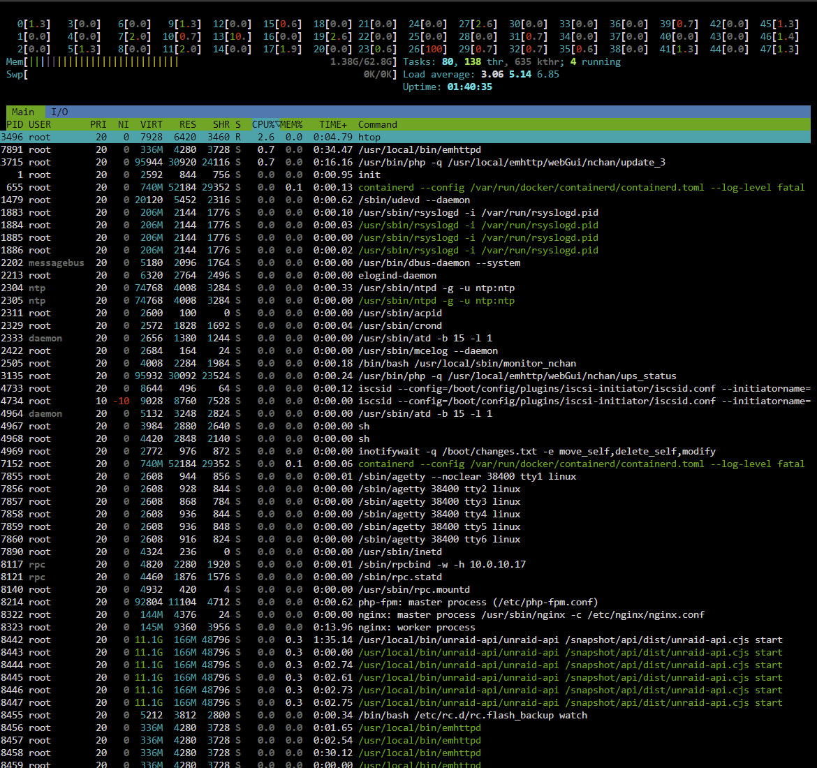

https://unix.stackexchange.com/questions/653292/htop-shows-one-core-at-100-cpu-usage-but-no-processes-are-using-much-cpu
run htop not top
htop will show ||| bars per CPU for total. May be a emhttp bug on data.

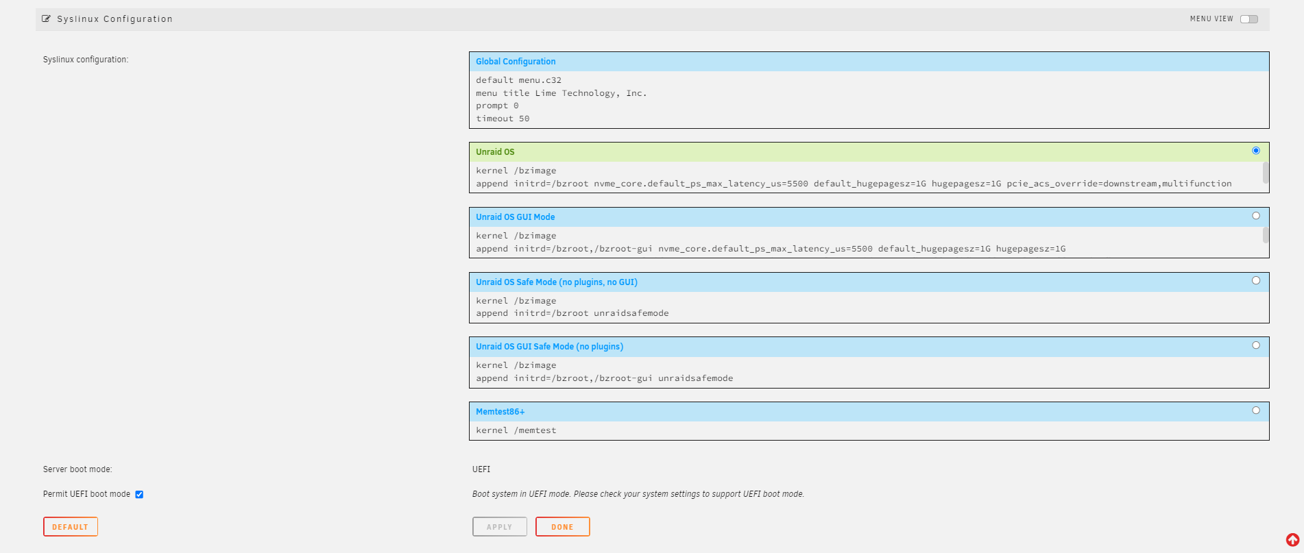

Potential an acpi error we can fix via a grub option
main > flash > syslinux add this to end of config:
acpi=off
 so:
kernel /bzimage
append initrd=/bzroot acpi=off
Depending on other vfio / vm settings you may have other data here don't lose that data!
Also - check bios settings. Make sure it is set to Other OS
also confirm that secure boot is off.
^Known to cause this bug to cpu instruction set by hadware firmware at boot.
acpi=off
 so:
kernel /bzimage

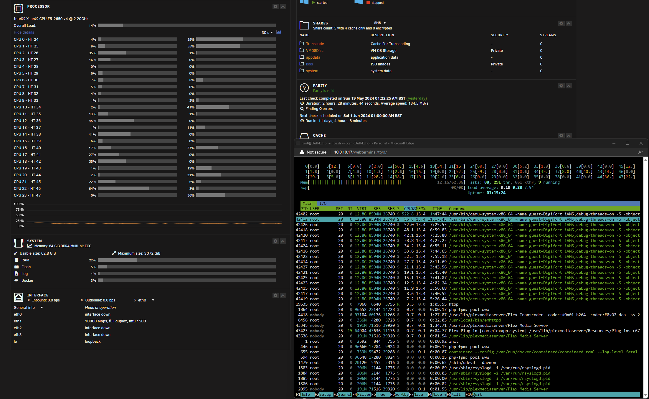

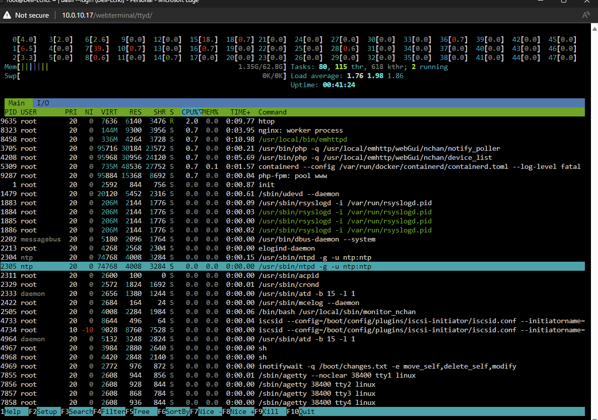

So last night before i went to the land of nod i tried a few thing and after few minutes is was still doing either straight away before the array had been started manually just to see if it was doing with it not running and it was .... in the end i headed up to nob brain still thinking ..... so i had a little brain fart during the day thought i wonder if one of the drives could be causing this so when i got home today i went about mission drive ....... lol
very odd so before powering up server i remove all my drives as was thinking possible a Drive could be causing this random core to go 100% so Parity missing and drives booted in to unraid put them all back so Unraid could see restarted the array and then rebooted . then added the acpi=off code where you said rebooted then only showing one CPU and one core , run htop and did show CPU all as one . so remove code rebooted started the array and so far still acting normal only array running no real data on here yet so array layout not worried about yet ...... still a bit New to Unraid (linux codes) still learning as go what is what and does  .... htop it is
screen grab taken before docker running and after still all ok then started the VM ...... expecting it to do it 1 core 100% but nope it running fine .... i it either that magic code work and did something or a possible drive error caused not fully in ..... just in case i ordered a couple of drives to replace then because did have a little doubt about two of them so i wait and see what happens ..... at the monument no data on array all on the NVMe drives ......
then started Plex Docker ...... still all ok .... starte dto play film still go to go ......
just so you know its running on a
Dell R630 Dual CPU in HBA Mode .......with a couple of SAS drives for the array for testing and Cache Pool is Two
CT1000P3PSSD8 1TB which i had in the unraid before porting across to server and was working fine no issues that i know off :)
Again Thanks you for all your help as it now seems to be running and Docker running and VM which before you ask is whats the Digifort it is a iVMS Server ..... for CCTV NVR ....
Thank you
Bannie

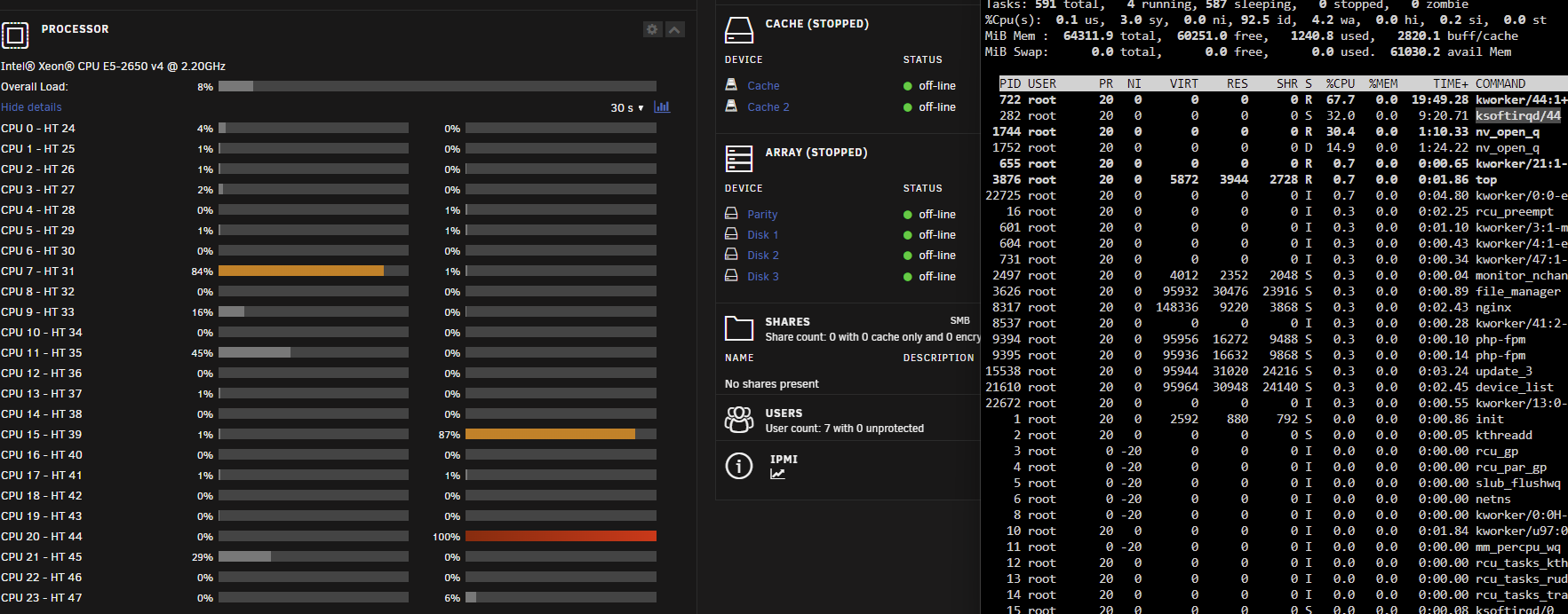

Nope spoke to soon ...... its back ..... i tested the VM on another Unraid server with No issues ...... i have plex running steaming a film stop the film after 30 mins and the still ok went off for five minutes check bang Core 26 100 %
