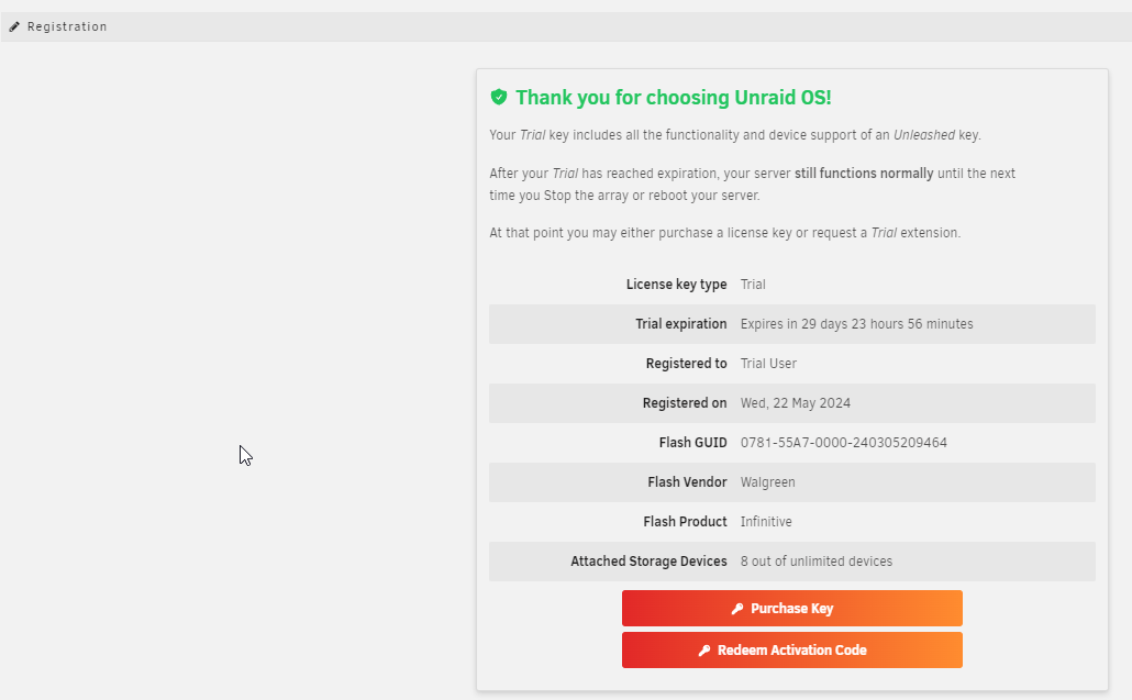

OK.  I have UNRAID on a new USB.  Trying to transfer my license, but all of the documentation shows a "replace key" button which is not an option under Tools > Registration in version 6.12.10 from what I can see.  All I see is this:
Have you put the old key file into the config folder on the flash drive?

No.  Since my old USB was completely hosed (not accessible at all) - I followed the directions from the link given above, which was:
The basic approach is:
  • Create a new Unraid boot drive.
  • Boot the Unraid server off this new drive. At this point no drives will be assigned.
  • Get the new drive licenced. This can be using either a trial licence or by following the procedure for transferring an existing licence to a new boot drive.
What I did instead was to get the URL from Unraid Connect and load that.  But, of course that leads to Registration Key / USB Flash GUID mismatch.
I figured that part out.  Use the replace that comes up to blacklist the previous USB GUID.  So now I should be at the point where I can try to figure out the drive situation.  I know which one is the parity, but beyond that I have no damn clue.
