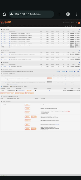

I currently have 7 drives in my array, plus 2 separate cache drives.
I have 4 8tb drives on their way and will arrive tomorrow. I am planning on using 2 of them as Parity drives and I'll be adding the other two to the array. I will probably need to stop using the 2 4tb drives which are currently in the array. What steps do I need to take to complete this?
Thanks in advance!

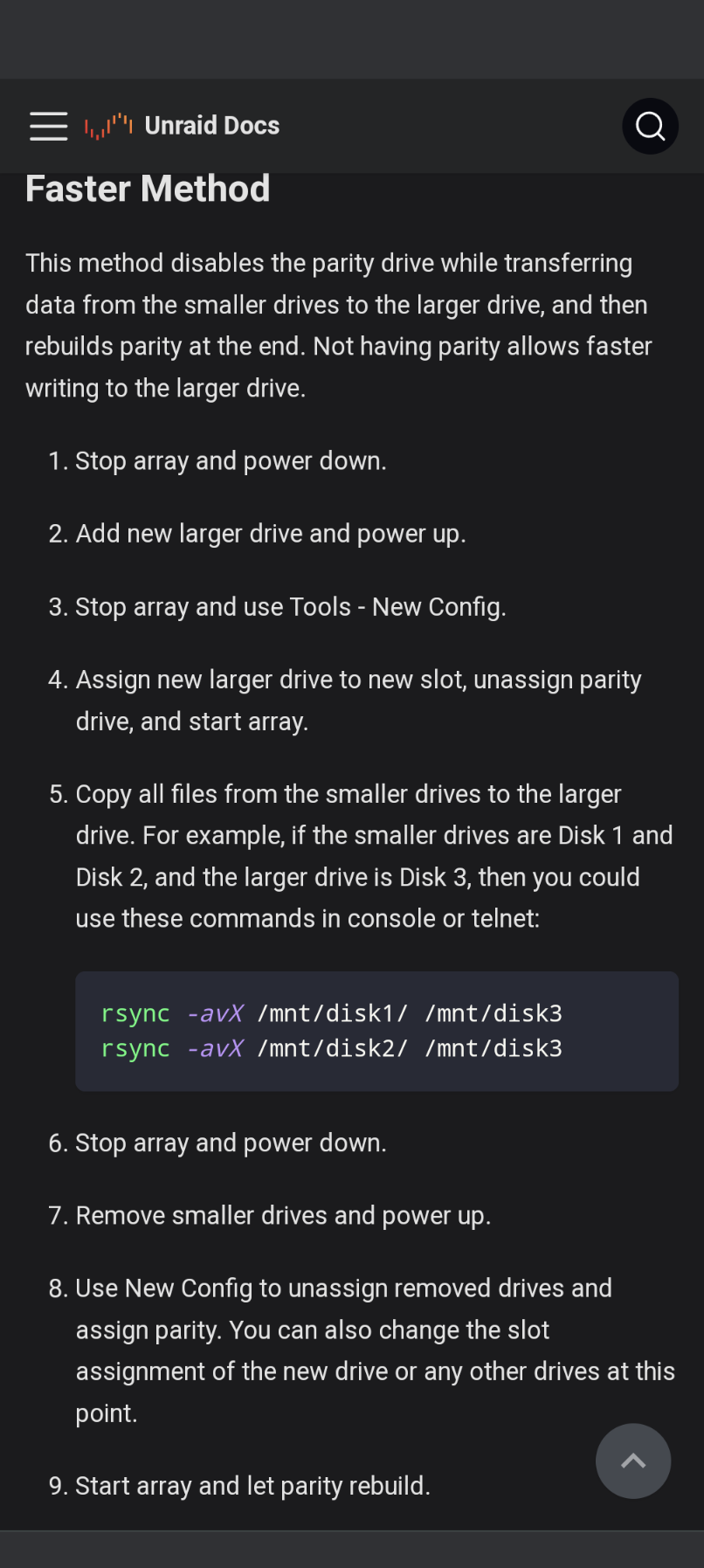

I did some reading and I came across this:
This method would work just as well, right? I was thinking about doing this before adding Parity. I was thinking that once I've sorted out all the normal array drives I was then going to add the Parity drives. I was hoping this way would save some time.
Yes.
