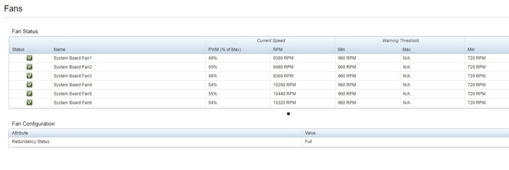

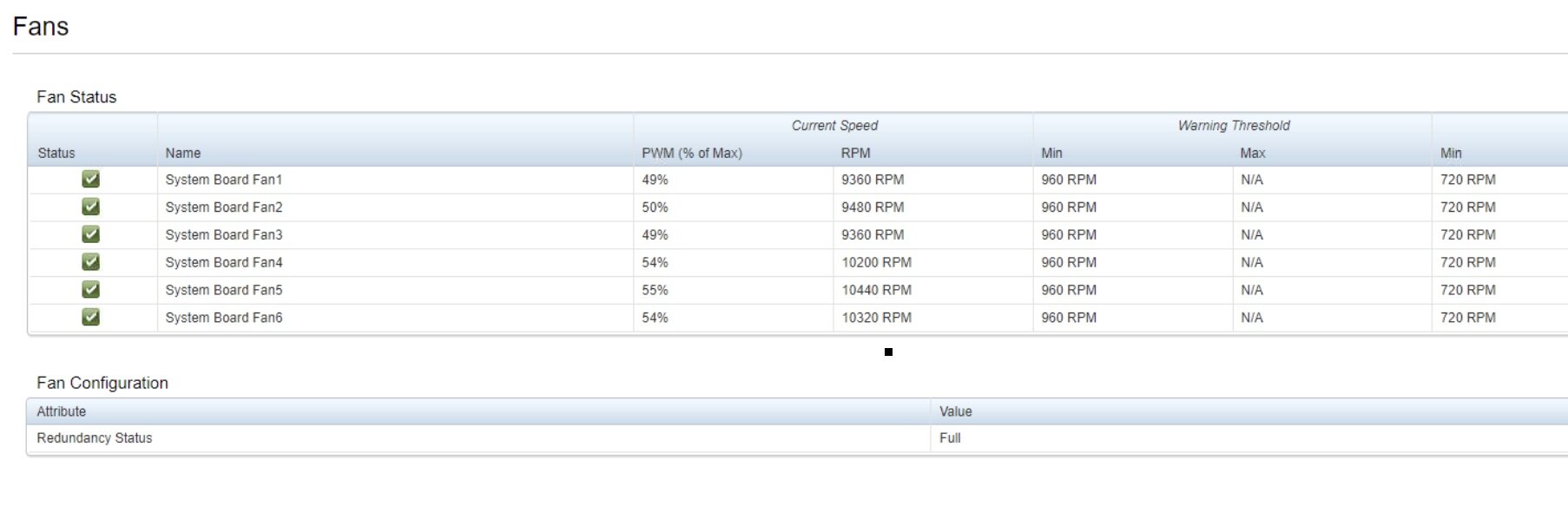

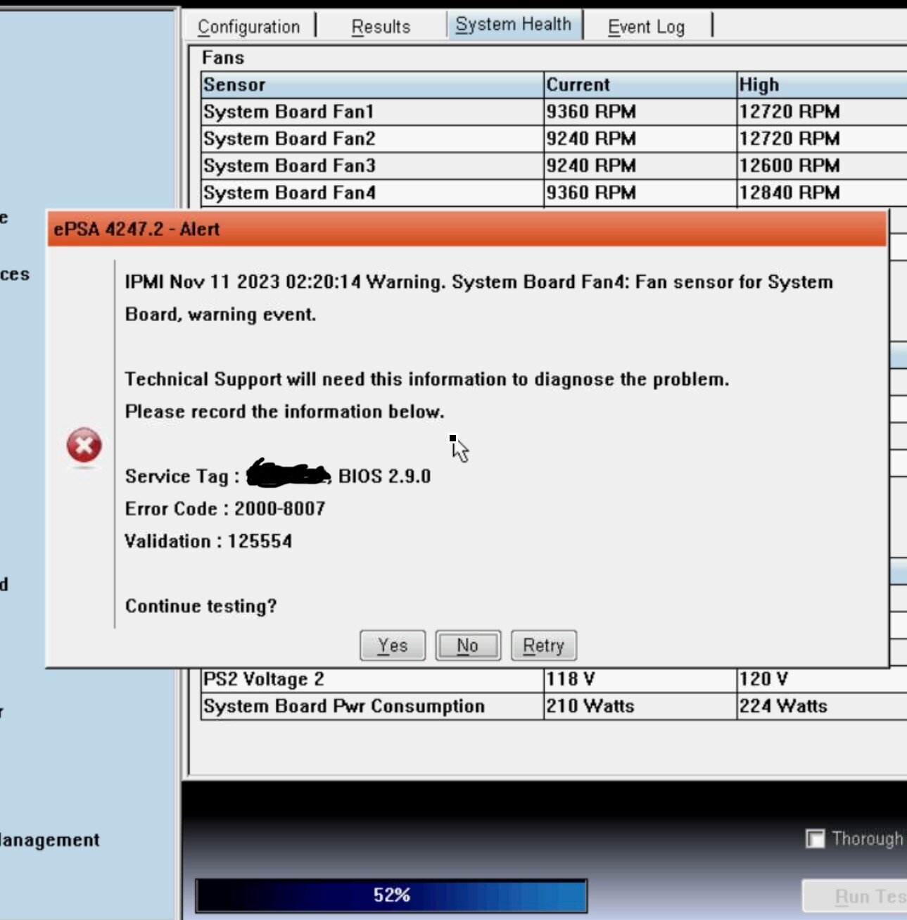

I can confirm this only happens when loading unraid. I booted into lifestyle controller and the server stays on without issue and I ran a hardware diagnostics test and the only error I got was a fan sensor 4 warning event but within idrac all my fans are listed as working fine. IMG_1017.thumb.jpeg.1e9f07a3f829aa00abf563b18dd01f6f.jpegIMG_1016.thumb.jpeg.4c21ac4e88f8b0d25998a81ce1ef848e.jpeg
