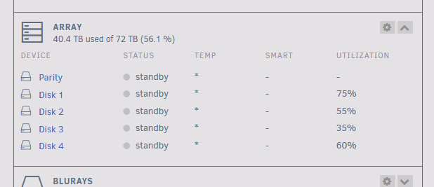

Just tried this and all drives went into standby. Opened Plex and played a movie and disk 1 fired up and movie played fine. Excellent. Just working out how to set all drives at the same time
I assume on 30 mins as I set delay for, it will spin down again ?
It then spins up on demand ?
I’m liking Unraid even more
Just to add to my comment above in case anyone else reads this for help
I've set all times for spin down on each disk to 30 mins (rather than default - although thats as valid)
I've enabled groups
And called the group on each drive  as "1 2 3 4"
Hope thats correct

Almost 😉
Its suffient to set the default to 30min and not on every disk (though it does not make any difference, as long as you do not want a disk to run longer or shorter than the others).
Group enabling is fine.
But there should only be ONE group (like "1" or so). All drives within the same group wake up at the same time.
Note that grouping has no influence on spindown time, it only controls spinup.
Usuall you do not need any groups now. They come in handy once you added drives later or replaced a drive (and enlarged it). From a certain fill level on UNRAID will split shares on many drives (this is done totally simple, a "share" is just a top level folder and if the two foldernames on two disks are identical (like "/movies") UNRAID joins the folders internally and shows them to the clients under the single name "/movies". Then it may become disturbend if you play a movie and it spins up a disk and then play the next and you need to wait again because this one was located on another disk. The user cannot see or know this, so it becomes a bit annoying.
For these purposes you create a "spinup group", so that all drives with the "/movie" folder wake up at the same time.
