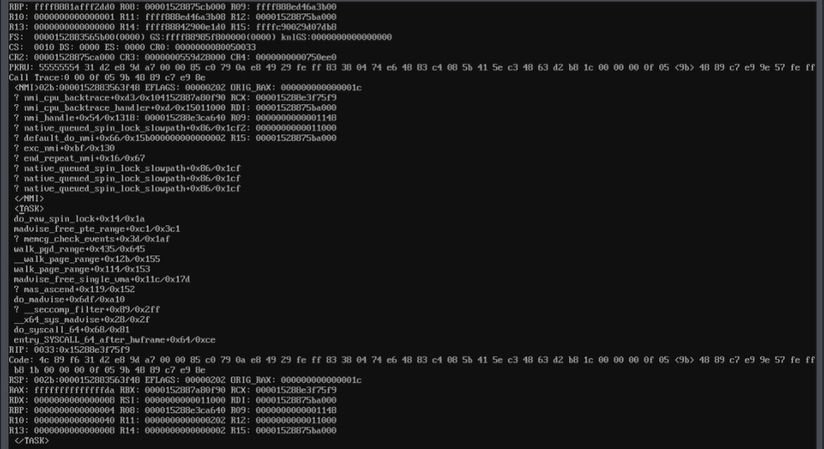

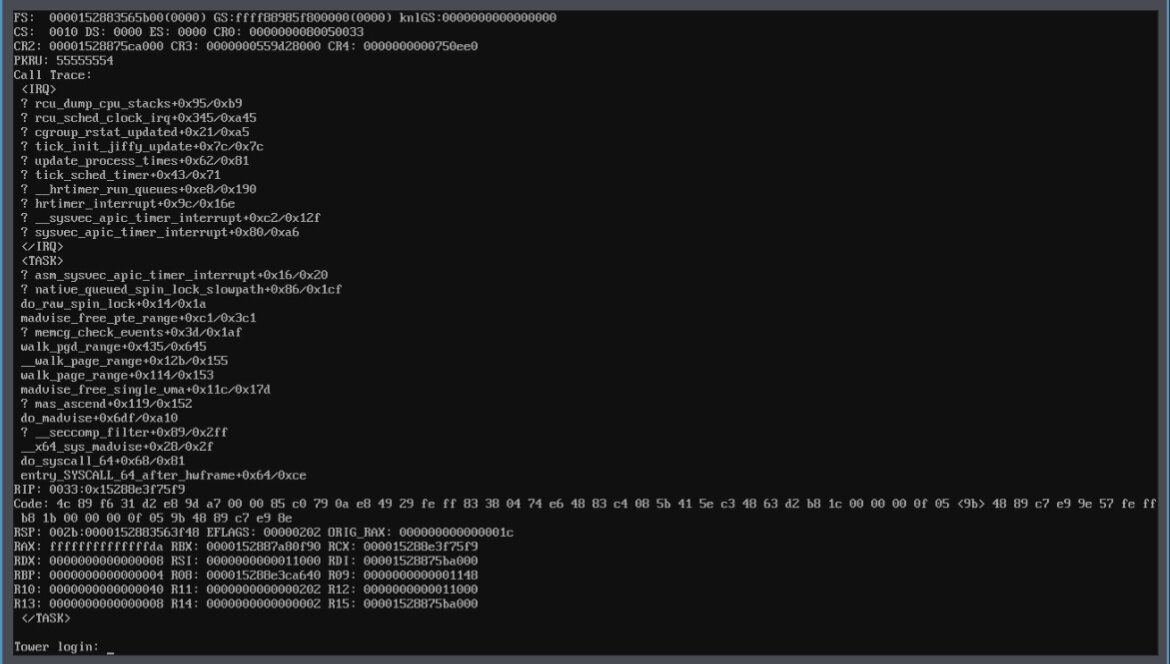

I keep getting random crashes of my unraid server. Sometimes it runs for weeks, but usually this is after a few days or sometimes less than a day. The syslog didn’t reveal anything either. However, I was able to grab two snapshots attached there, which could possibly be related to an error? I’m wondering if there is a kernel/hardwire issue on the server. Diagnostics are also attached. I could also get the syslog file if needed too. Thank you!

Constant call traces since this time until it crashed:
May 28 02:18:21 Tower kernel: ------------[ cut here ]------------
May 28 02:18:21 Tower kernel: kernel BUG at arch/x86/kernel/traps.c:934!
May 28 02:18:21 Tower kernel: invalid opcode: 0000 [#1] PREEMPT SMP NOPTI
Start by running memtest, if nothing is found, and because memtest is only definitive if it finds errors, try with just one stick of RAM, if the same try with a different one, that will basically rule out bad RAM, if issues persist, another thing you can try is to boot the server in safe mode with all docker containers/VMs disabled, let it run as a basic NAS for a few days, if it still crashes it's likely a hardware problem, if it doesn't start turning on the other services one by one.
