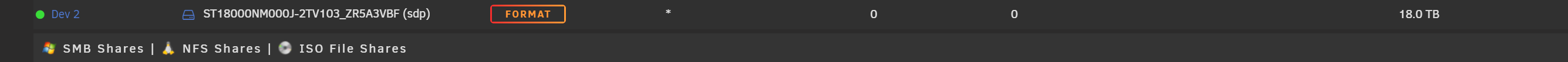

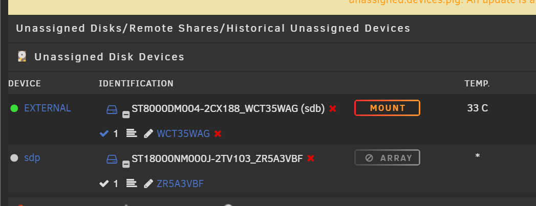

June 1, 20242 yr Hi guys, Last night my drive got 1048 errors and stopped itself (as they do.) It was emulated so I backed up bits and decided to stop the array, to maybe try an xfs repair. But now it shows in UD (bottom one) but not in the dropdown to remount! Advice please? I am trying to get my logs but chrome keeps running out of memory, (not seen before doing this!) Edited June 1, 20242 yr by folic86 wrong screenshot
June 1, 20242 yr Have you lost data? If not, I would stop using that drive immediately. I was looking into the SMART data and you have a lot of reallocated sectors.
June 1, 20242 yr Community Expert That disk appears to be failing, leave it unassigned and post new diags with array start to see if the emulated disk is mounting.

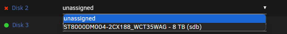

June 1, 20242 yr Author 9 hours ago, rjdipcord said: Have you lost data? If not, I would stop using that drive immediately. I was looking into the SMART data and you have a lot of reallocated sectors. Didn't appear so before I stopped the array, as SDP was happily emulated - but then it won't show as a mounting option to check now at all. @JorgeBI've restarted the array. It shows this. Logs attached. wopr-diagnostics-20240601-1636.zip
June 2, 20242 yr Community Expert That's good news, the old disk is not providing a valid SMART report, so it may be failing, but try swapping cables with a different disk and post new diags after array start.
June 2, 20242 yr Author @JorgeBcan't get a new disk today (as I guess I need an 18tb? It was fairly full!) but it does appear in unassigned devices as unformatted? Any thoughts.

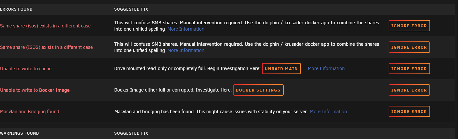

October 16, 20241 yr Author So I have been away and just started fixing this. Rebuild froze twice so I swapped out the HBA card, and now have a rebuilt drive. However I have issues with the below. I have resolved the ISOS/isos issue, but I don't know what is wrong with the Cache disk/ Docker Image and would like some help please. Also unsure on the macvlan thing. Frankly, I'm close to using paid support to resolve this! wopr-diagnostics-20241016-1733.zip Edited October 16, 20241 yr by folic86 added line
October 16, 20241 yr Community Expert The first two are self explanatory, for 3 and 4, the cache pool is corrupt and went read only, with btrfs recommend backing up the pool and re-formatting, for the last one update to 6.12.13
