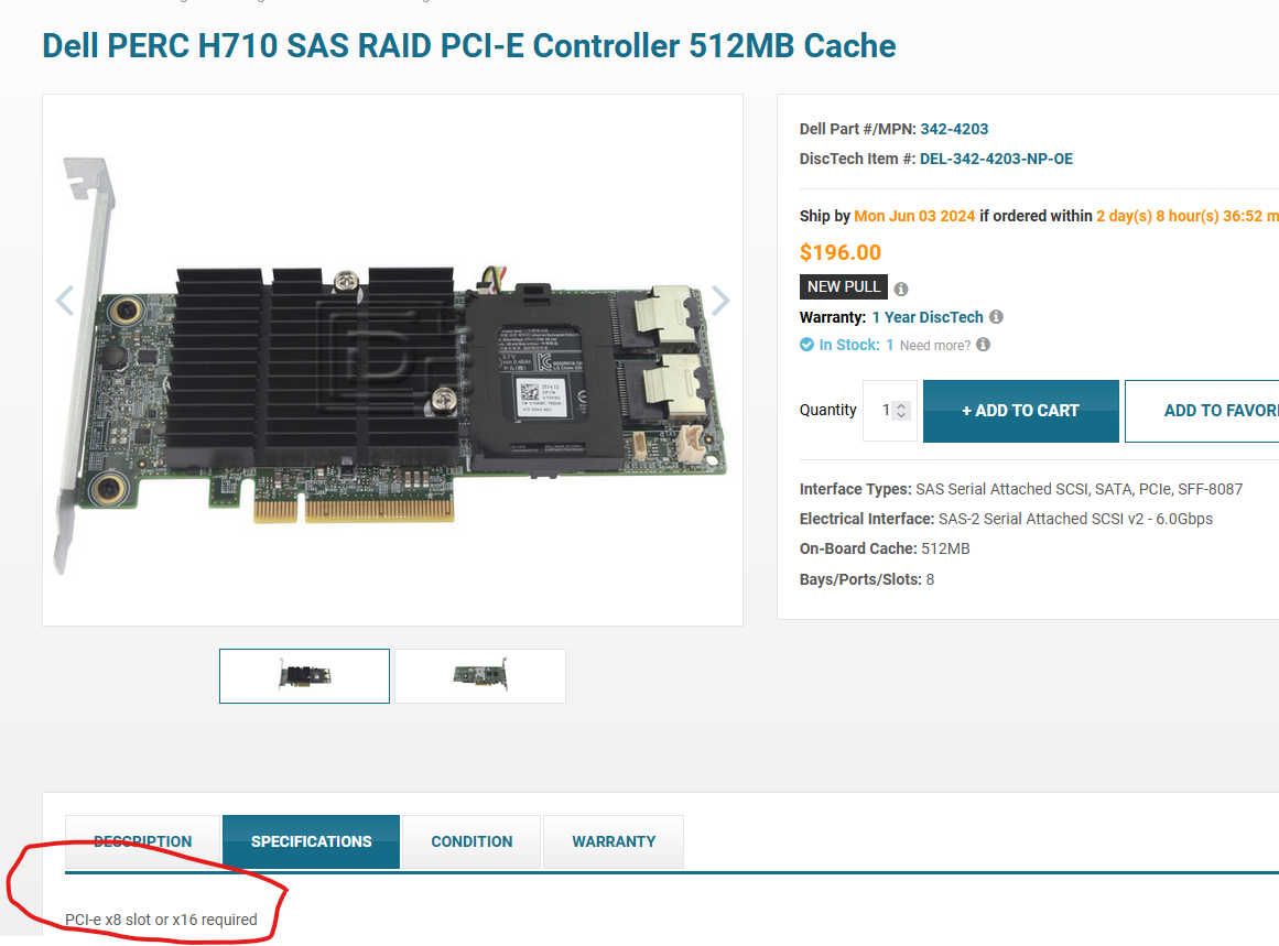

Thank you! I've tried a different slot, the main one, 3.0 x16, in which I have a GPU, and it works there. Anything I can do to make it work in the previous slot, 3.0 X4, so I can keep using the GPU?

Thank you. I thought that was PCI-e 2.0 x8 and thought that the bandwidth of 3.0 x4 would suffice.
Also, apologies for the stupid question, but why did it show up correctly in BIOS with all disks (checked them one by one) but then didn't work? Was it hitting a bandwidth limit or something?

They usually work with fewer lanes, with limited bandwidth, but that can be controller specific and I'm not familiar with that model, an LSI HBA should work fine in an x4 slot, and preferable to a RAID controller in HBA mode, since it's never a true HBA.
