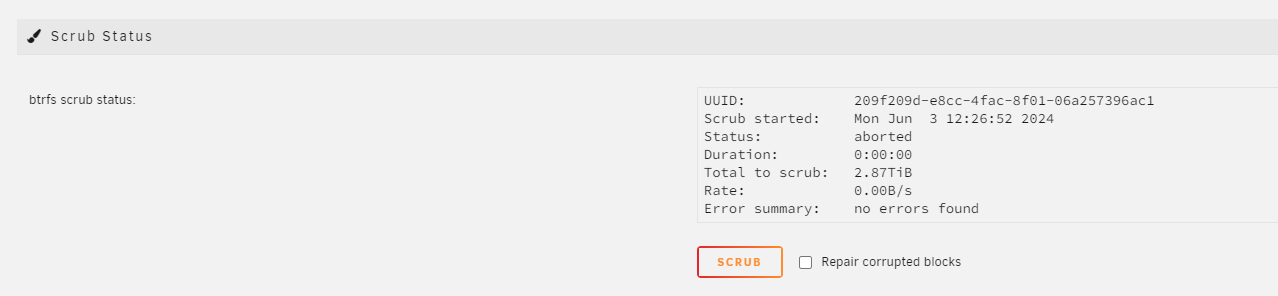

Run a correcting scrub on disk3 and post the results and new diags.
If the scrub is aborting there are some issues with the filesystem, recommend backing up that disk and re-formatting.
Yes, you can follow that.
Driver re-formatted and scurbing done without errors. Anything else I should check?
