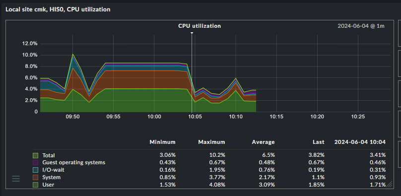

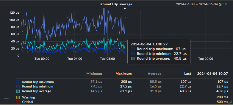

Ironically i run Checkmk in a Docker on my Unraid and it shows it stop my Unraid SNMP stopped polling/responding at 10:07 today (i rebooted at 18:00) as well as a CPU drop roughly 5 minutes before which suggests a service crash? 90% of my Bread and Butter is Windows and only 10% is Redhat/CentoS so i dont want to make assumptions

yes I am only assuming it froze around 10 as thats when checkmk stop polling SNMP to the Server, but i only discovered it when i got home 17:45 when i logged into the CLI (you can see i put in the wrong password twice)
