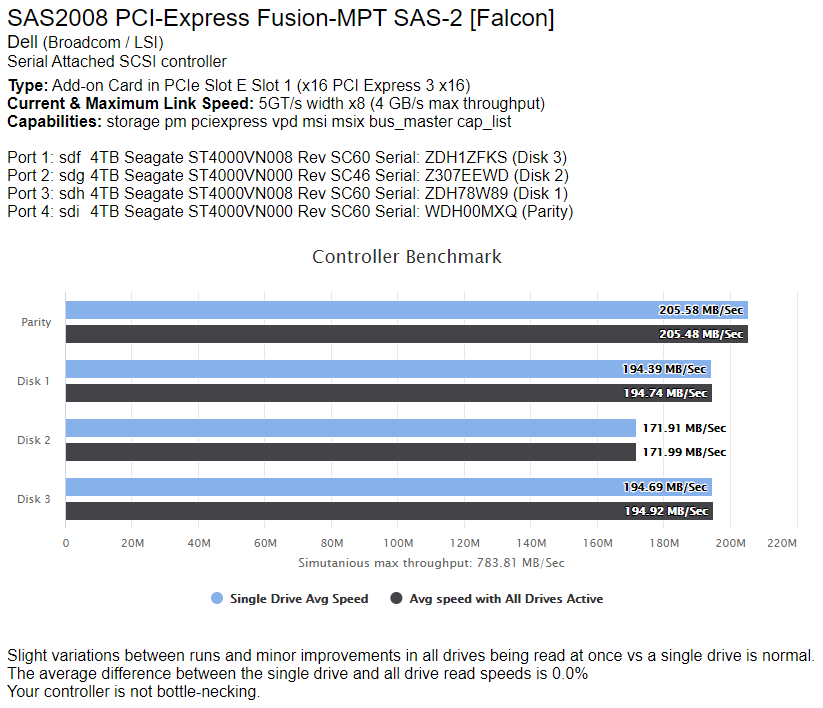

Those are the disk results, and already show some interesting info, multiple disks are under-performing, but also would like to see the controller test, looks like this:
sure here is the benchmark of the controller
That indicates a big controller bottleneck, though the previous individual test also didn't look goof for several disks, post the output of:
