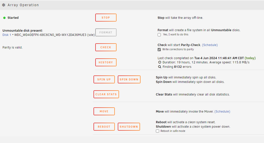

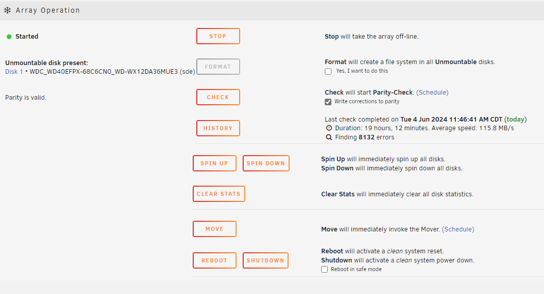

My Disk1 on my Array started acting up the other day. I am not really sure the precursor. But now it is showing up as an Unmountable drive.
When I start the array I only get an option to Format the drive. I really don't want to lose all the data on my drive again. I've tried restarting the array in Maintenance Mode and I have run a parity check which came back 8132 errors so, I am kind of hopeful the data is still there. I am just not sure how to recover at this point.
And my brain just said 'if the drive wasn't working and I left "write corrections to parity" checked all my disk1 data is gone isn't it?

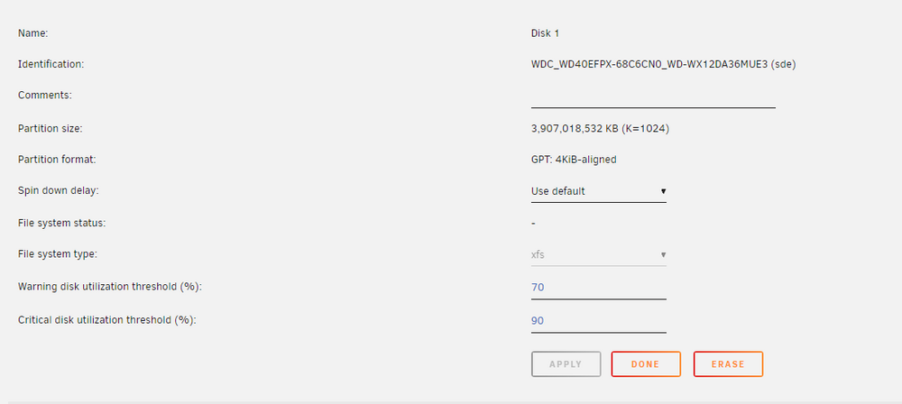

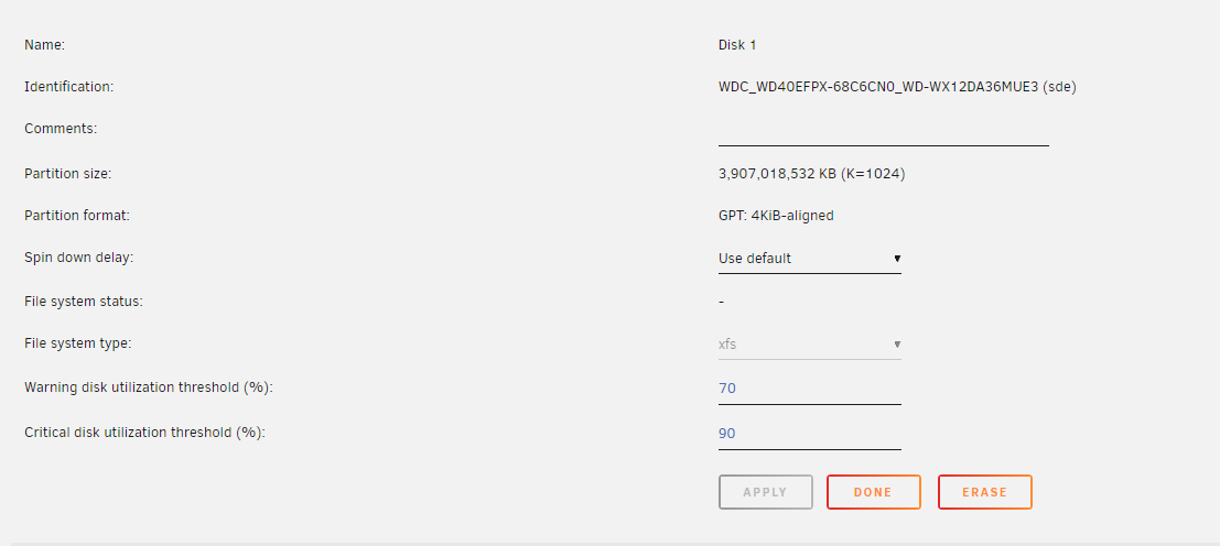

Thank you, my File system type says xfs but I don't see an mdX
xfs_repair -v /dev/mdX
should I use sde instead of mdX?
xfs_repair -v /dev/sdX1

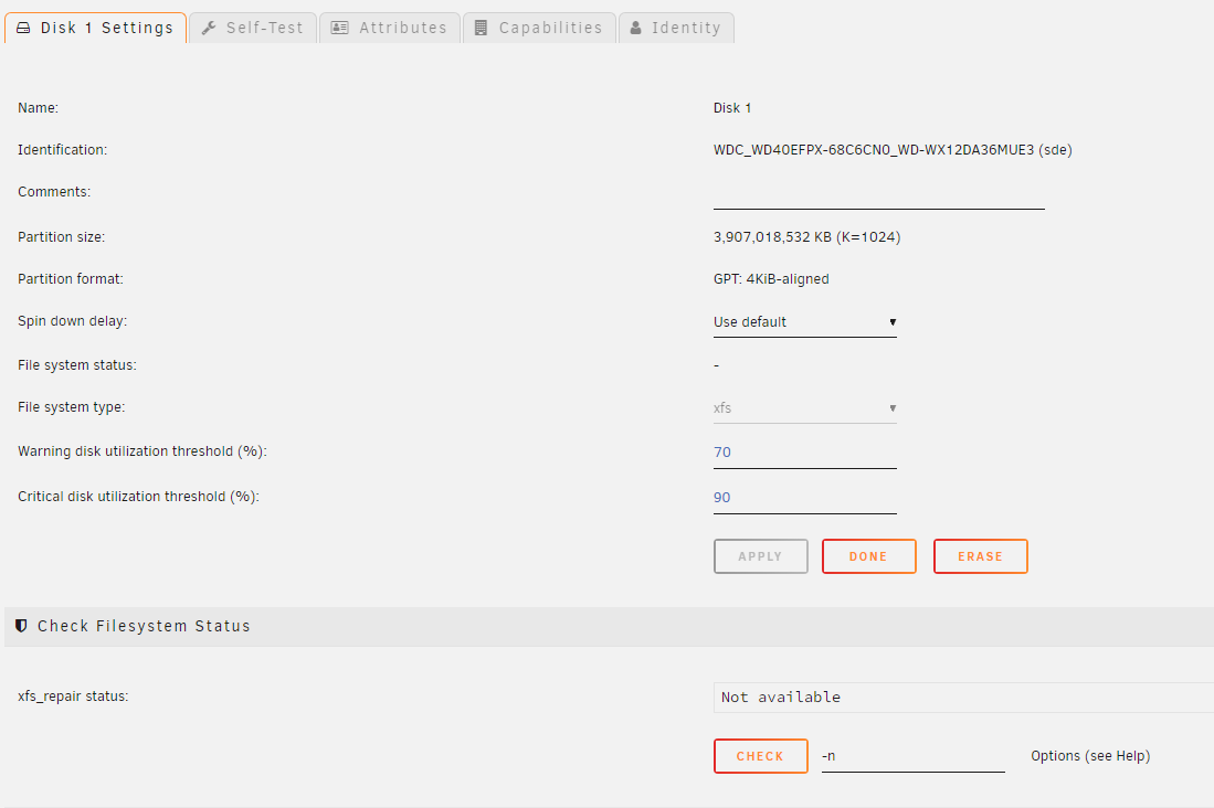

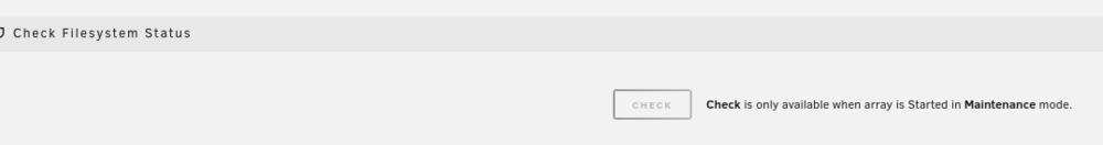

Is there a section directly below the screenshot you posted?
Okay, I see my confusion: I got confused by the instructions in "checking and repairing" because I was trying to read it all before doing anything.  Ran the repair with the -n, then tried to run it with no options.
Edit: Here are the results of the -n run:
