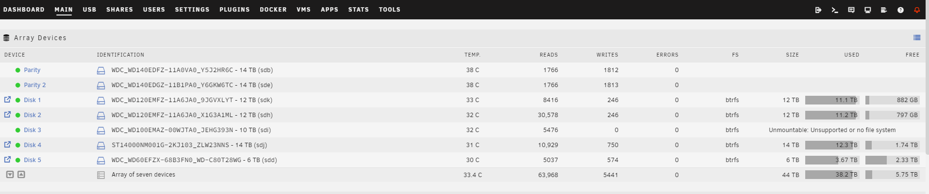

UNMOUNTABLE: UNSUPPORTED OR NO FILE SYSTEM BTRFS
Hello, I am having an issue with one of my array drives showing up as UNMOUNTABLE: UNSUPPORTED OR NO FILE SYSTEM. I plugged in a usb device (Mig Switch Dumper) that may have caused this. I rebooted and skipped parity check only to find some of my data was missing a few days later. I checked the Array and found the error message. I stopped and restarted the array and also rebooted. Here are the diags. Please help

*Update* I ran sudo btrfs scrub start /dev/sdi1 and clicked Y to clear out log tree with the array offline.
Result:
No mapping for 10376300577106952192-10376300577106968576 Couldn't map the block 10376300577106952192 Couldn't map the block 10376300577106952192 bad tree block 10376300577106952192, bytenr mismatch, want=10376300577106952192, have=0 ERROR: failed to repair root items: Input/output error
Started array and the drive is mounted and back online. Looks like clearing the log tree fixed the issue?
