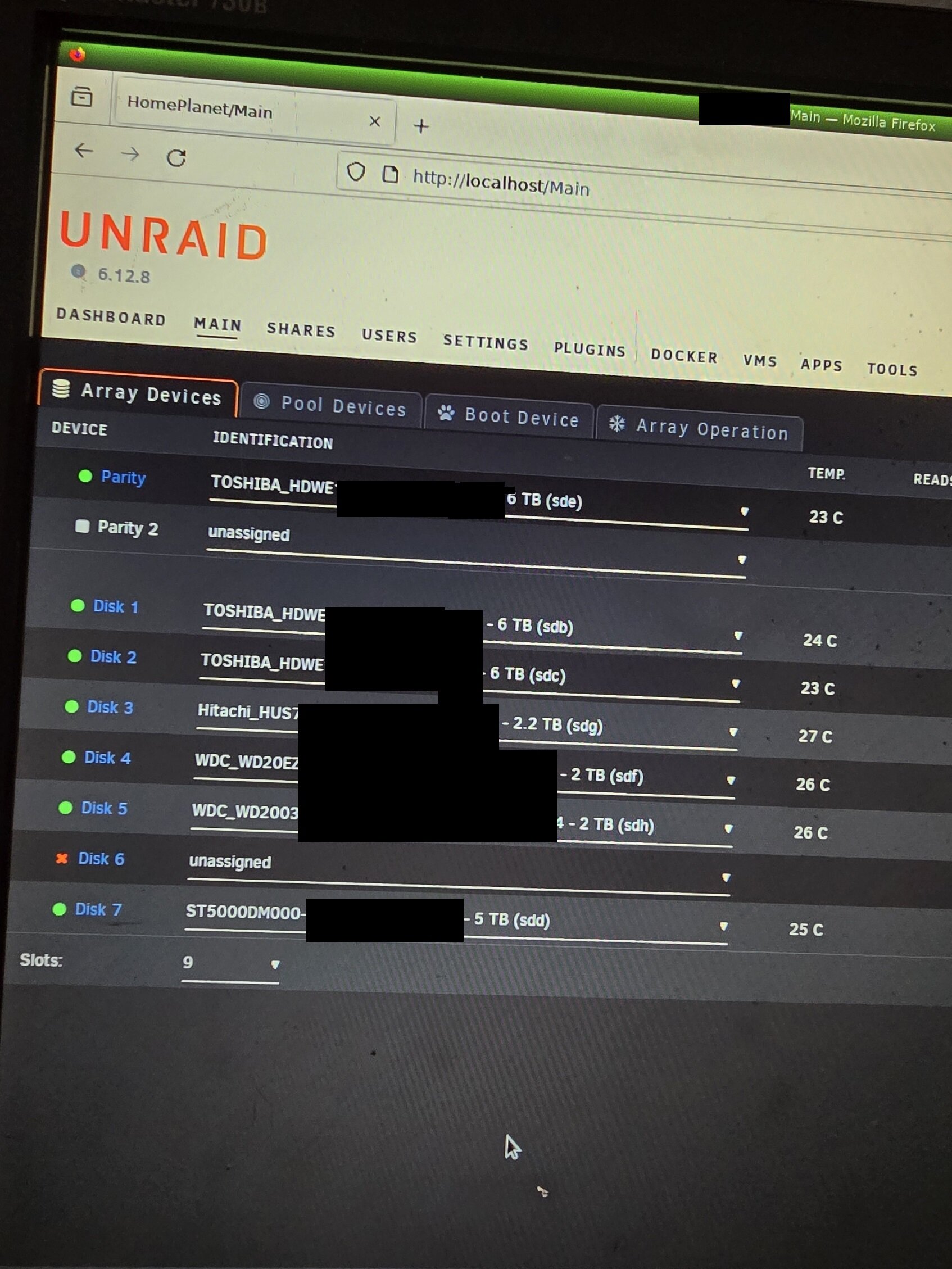

Hello,
I have an Unraid server for my data storage and a few dockers too.
*See attached image for drive sizes in TB:
      Parity:6
      Other drives: 6, 6, 5, "2, 2, X, 2"
""The lsi card I have(lsi 3081E-r) is a 3G/s which limits drive sizes to 2TB, I just have now a 6G/s in the unlocked mode to allow for larger drives (lsi 9211-8i)""
"""X= first dead drive"""
It is setup to allow 2 drive failures before data loss. One drive died a few months ago. I figured I'd replace it after I move soon.
I moved and the transport was less than ideal.
Booted the server with a non-gui interface but with a screen hooked up to monitor it.
About an hour later, it started throwing smart errors.
Then a second drive failed and the array shut itself off.
I have rebooted the server, and the failed drive appears again.
I now have a pair of 10TB drives to put in the machine.
I am worried about that drive failing during a parity shuffle/rebuild. (I didn't get the info of the 2nd drive that failed[pretty sure it's one of the 2TB drives])
I also would like to remove the low TB drives soon. :read: the 2Tb drives
Any guidance would be great.
Currently the plan is to swap the lsi card, shove the 10's in there. One as a parity the other as the first missing drive. Parity would move to the regular array(according to the parity shuffle docs) and it would do a rebuild.
Success...?!

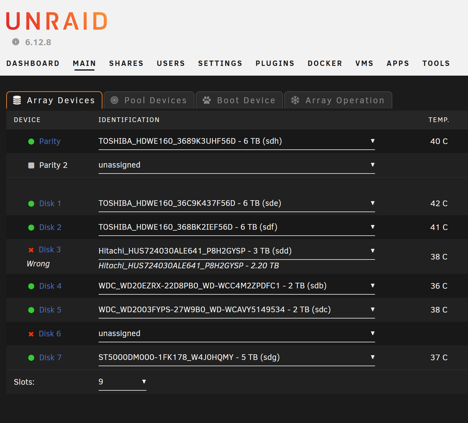

Should be OK, but it would be safer doing one thing at a time.
I did do it one at a time.
Card first. It recognized everything correctly. Which is great.
But, one of my "2TB" drives is actually a 3, but showed up as a "2.2" before because of the card limitations.
So now it shows up as it's full capacity and unraid says it's invalid. *see attached screenshot*
I cannot physically have both cards in the computer.
It seems I cannot spin up or rebuild until I also replace the first missing drive. Does that mean I /have/ to do a parity shuffle now in order to even attempt a rebuild?(with regards to my only replacement drives being so large)
You would need to "upgrade" that drive to 3TB first, by connecting it to a different controller.
Another possibility that occurs to me  is that if disk 6 can be successfully replaced on the original controller (with a drive of 2TB or less) then there would only be one disabled disk on the new controller so disk 3 could be 'repaired' to use 3TB as Unraid will think it is a new disk since the size changed.
Is that not what's happening?
This could work. I went digging and found an old 2tb drive.
This sounds like a 3-rebuild solution.
Why 3 rebuilds?    I was thinking it would be 2 rebuilds - one on the old controller to get disk 6 no longer disabled, and then another one on the new controller to get disk3 rebuilt to use its full capacity.
Then I have 2 x10TB to shove in there for a parity shuffle *and added storage*

UPDATE:
That 2tb I found was the first dead drive. Replacement is coming on monday. I am going to attempt @itimpi's suggestion.
I will update after the 2nd or 3rd rebuild. Approximately 1 week.
Also, I found a working 8TB(?!?!) in a bin and will probably be adding that too.
Thanks!
The array is fine. Everything worked. But my 'App Data' folder changed to 'appdata'. Easy fix.
Thanks for the help!
