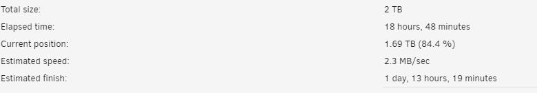

The speed now is usually around 50 kb/s and sometimes jumps to 5-10 mb/s for a minute or two.

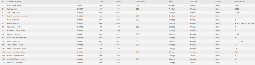

Plus in the smart report, the parity drive started to show read failure and Reallocated sector count
The rebuild process is around 85%
So the question is, do I leave it to continue? Is there a way to keep 85% of the rebuild data? or is it all or nothing?

Your replacement drive is an SMR drive, they are terrible at sustained writes like what is being done there.
It is all or nothing.
You can pause the rebuild, wait a couple of hours and resume, it'll run normally for a while until it slows down again, if you keep repeating that it should be faster than just waiting.

Constant ATA errors for parity, replace cables and try again.
