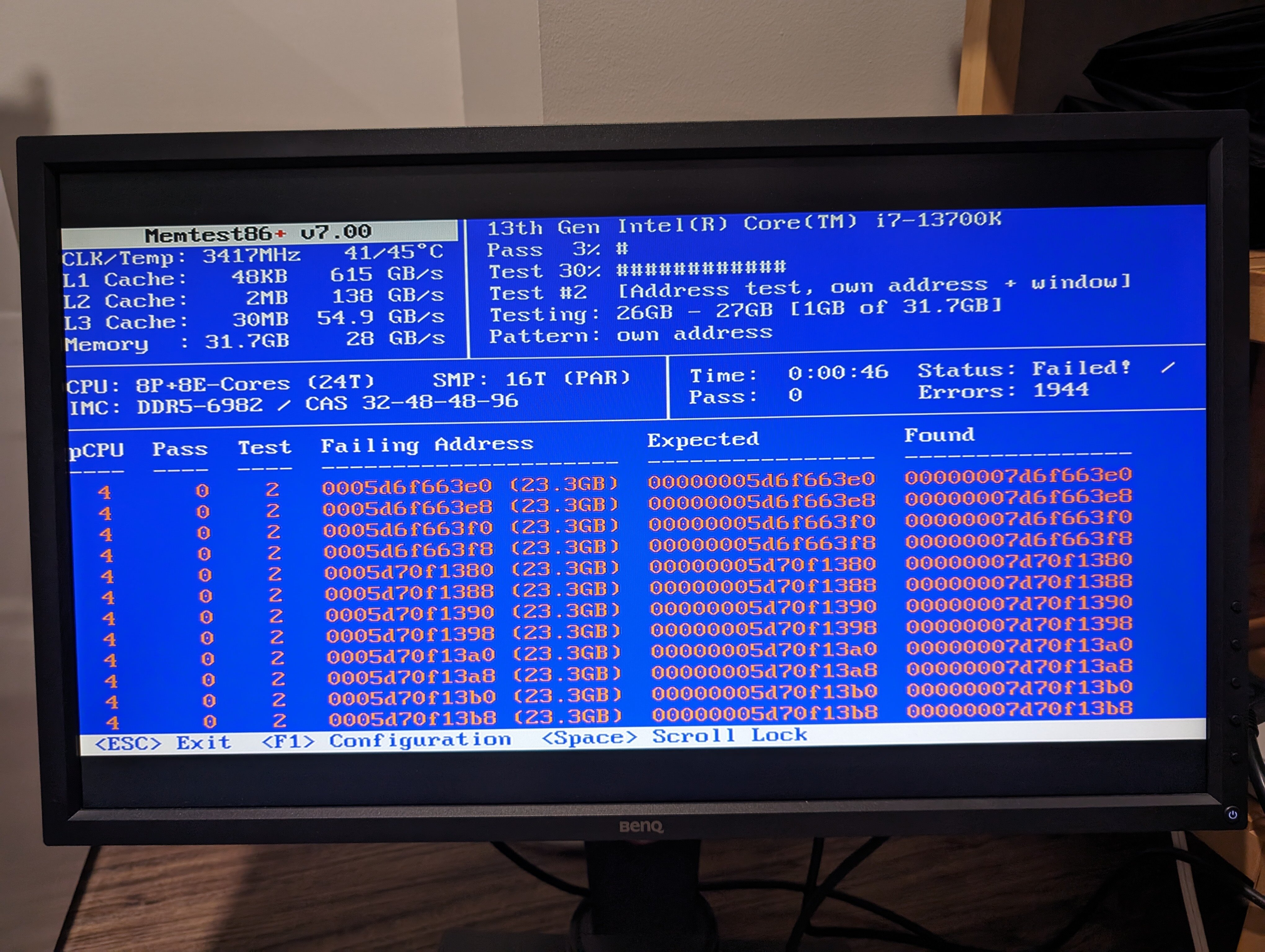

Perhaps it's a hardware failure after all? Any insight?
Yeah, any error there is critical.

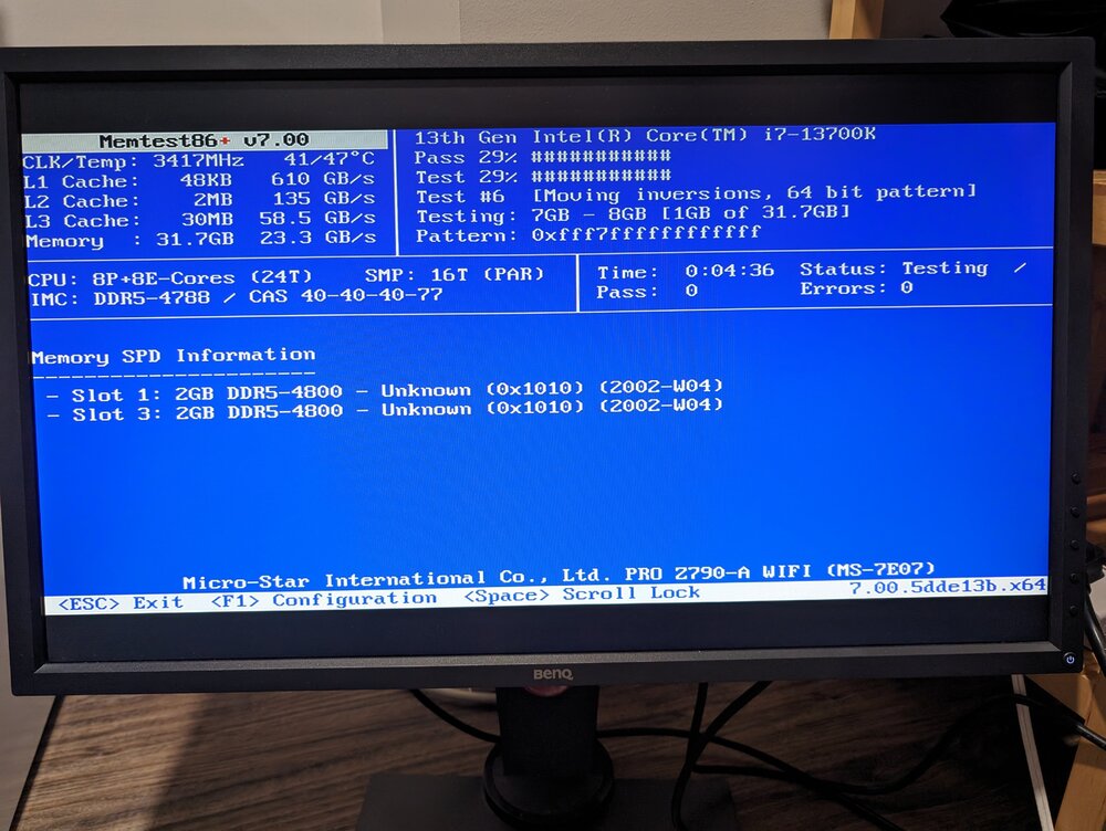

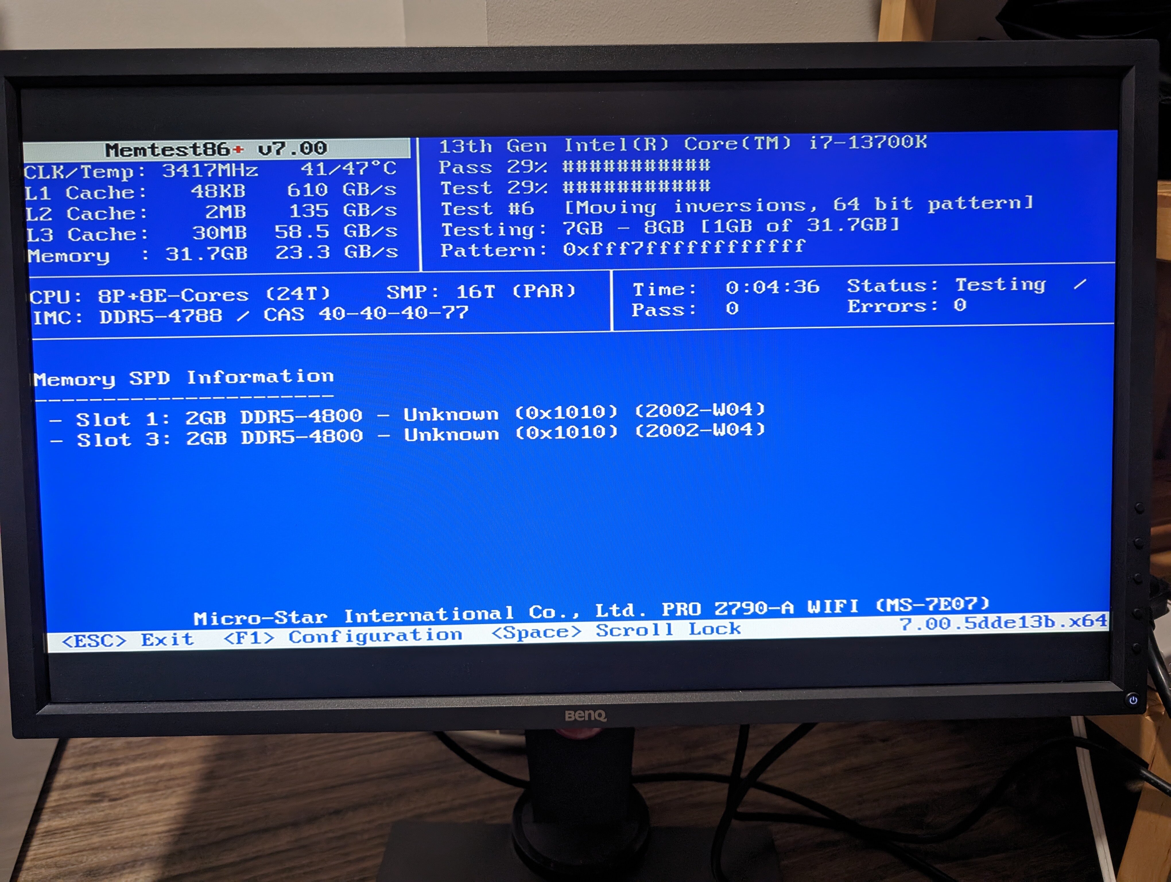

You can try with XMP disabled, the gain is minimal on a server and the toll on stability isn't worth it.
Updated BIOS and disabled XMP - so far running without error. If the test passes I'll try the server again and see what happens...
