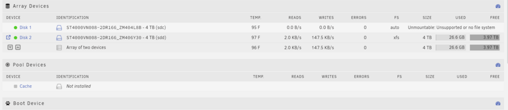

My server has gone without being turned on for about a year now. After upgrading the motherboard and turning the server on, I have an issue with Disk 1 changing from the XFS format to AUTO. Do I need to reformate the drive and allow my parity drive to rebuild it?

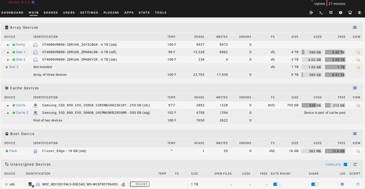

This is how it used to look:
UNRAIDARRAY_Screenshotfrom2019-07-2016-47-04.png.1cd0939a0450ca82a6d188b49818c26a.thumb.png.b1cf41fc10a5ad4920a7bd34f9f3fae2.png
Thanks

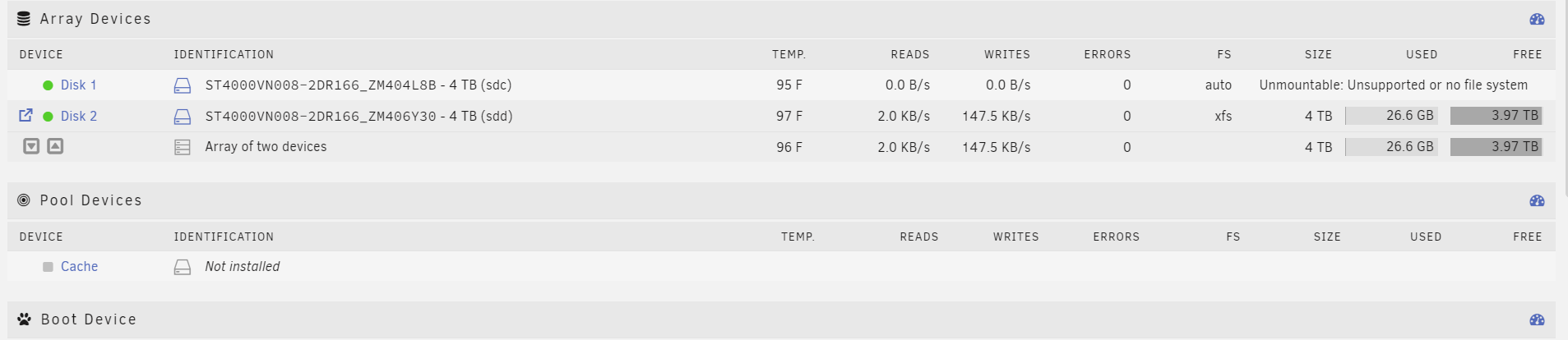

The diags you posted have disk1 mounted, so they don't match the screenshot, one of them is out of date.

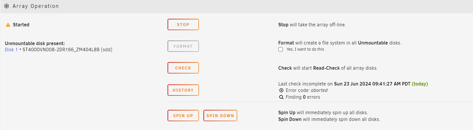

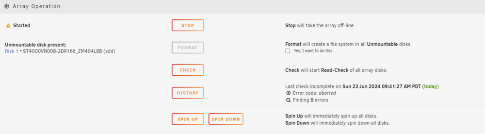

I'm having issues following the above posted document. Under the section "Running the Test using the WebGU"; step 4, I cannot find a "Check" listed to start any tests on the disk.
I also tried running a file system check from the command line as it suggests using "xfs_repair -v /dev/mdX" with no luck.
It also looks like my 500gb cache pool drive does not show up anymore but that's less of a concern at this point. I'll count it as a loss I just don't want to lose my data on Disk 1.

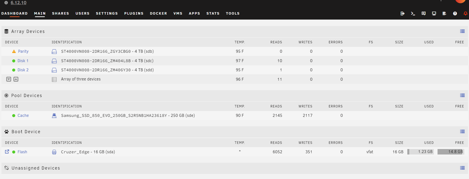

Below are the diagnostics and screenshot to date:

The command you used was incorrect which was why it failed.  It is easy to get the command wrong from the CLI.
