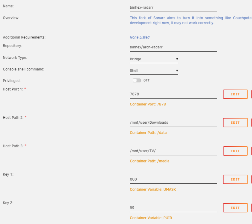

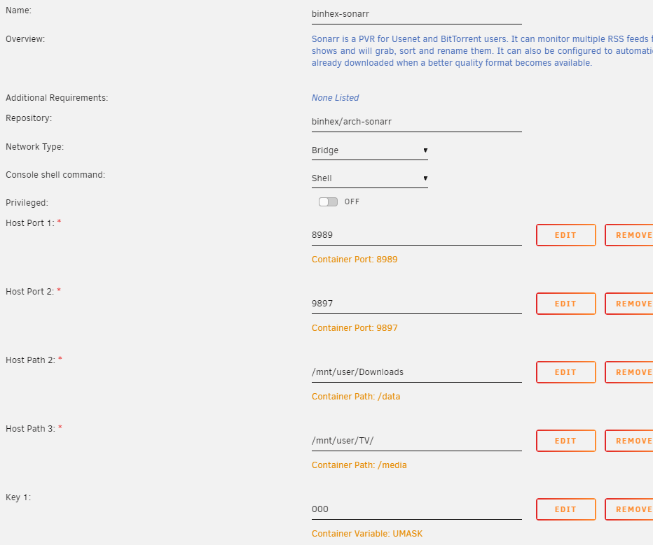

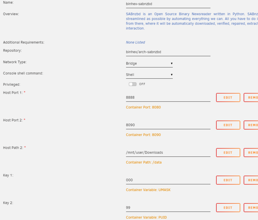

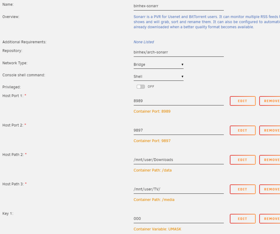

awhile back my flash drive got whacked and I had to put in a new one and re-install dockers.  I'm guessing I did something wrong because my docker.img keeps getting larger.  I expanded it to 60GB and it is almost full again.  I'm guessing it is SABNZB, but I'm not quite sure what I did wrong with the mapping that could have caused it.  I'll paste the applications that are most likely (at least from what I've read):

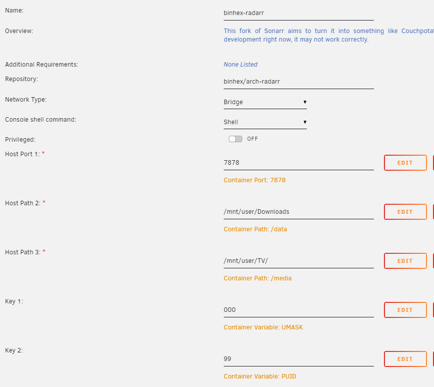

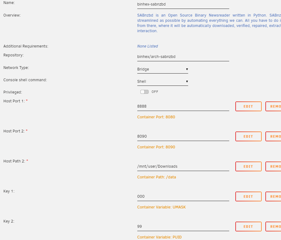

It's not usually the mapping that is the issue, but the settings inside the application not pointing to the mapping. If sab is putting downloads somewhere besides /data, that would do it, also if the 'arrs aren't moving it to /media, that would do it as well.

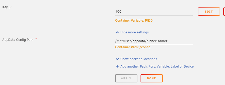

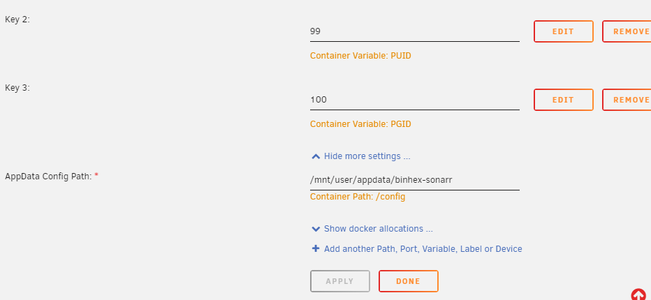

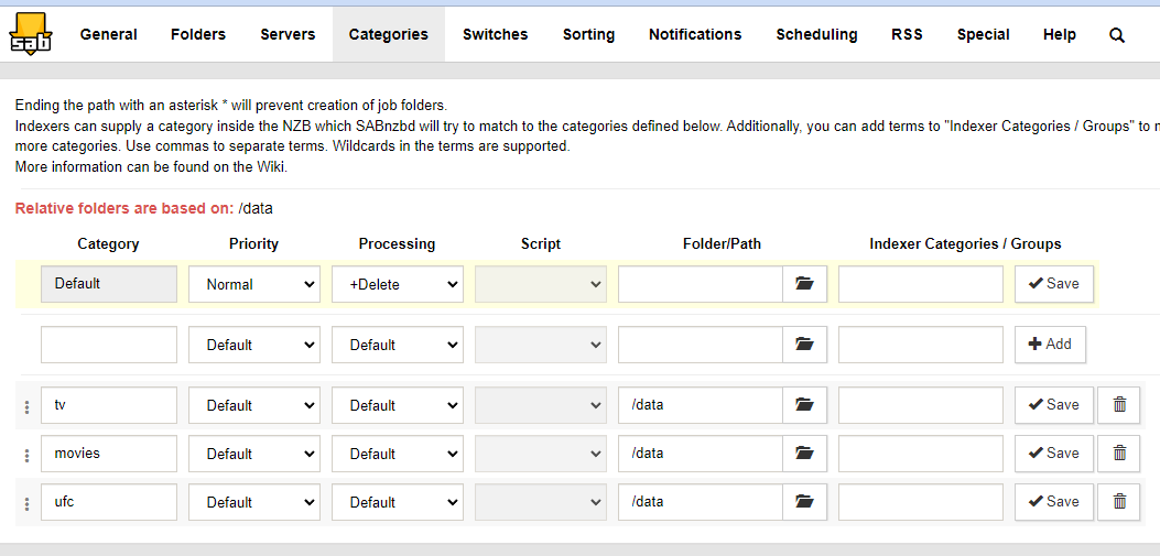

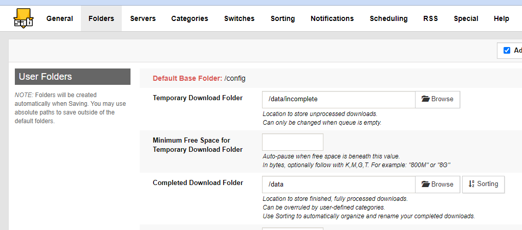

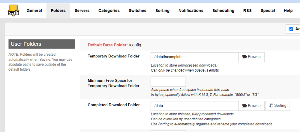

That looks to be set up correctly:

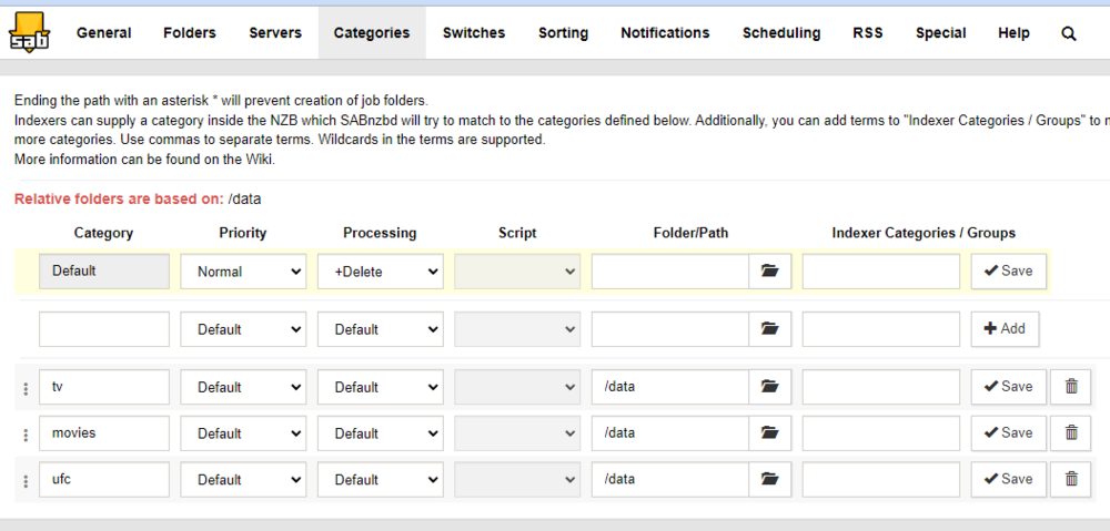

And then:
Does that seem correct to you?
Thanks!
Yep.

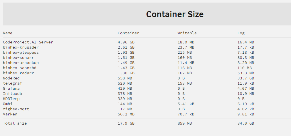

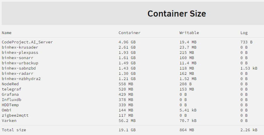

At the bottom of the Docker tab, click the Container Size button and see what it says.
Wow - I totally missed that button :(  That is informative:
Looks like logging is taking up most of the data on mostly on NodeRed.
I do not know why this is not conforming to the settings here:
I have not changed this setting, so I can only assume it was set like this before I installed any of the dockers listed.
I just did a truncate of all the logs in the docker system, so I think I'm in better shape now:

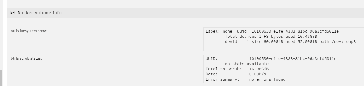

I ran a truncate on all the *-json.log files within /var/lib/docker/containers.  After I looked here I then restarted Docker.  Doesn't really look like it gained any space, though:
I get the bottom part, but it looks like 52GB of the 60GB used from the top section.
