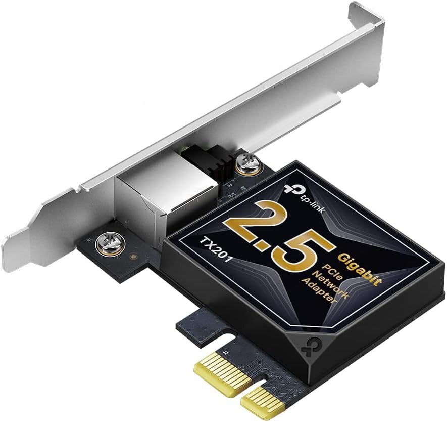

I'm going to drop a 2.5 gbps NIC to be isolated for just my VM. Where can I find more info on setting this up? Is this as simple as seetings/Network Settings/ and ensuring it's only assigned to the VM or do I need to go into Tools/System Devices and bind the selected VFIO at boot?

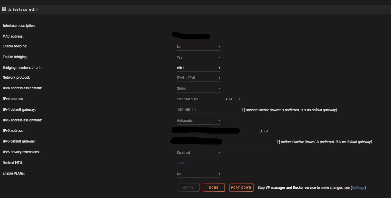

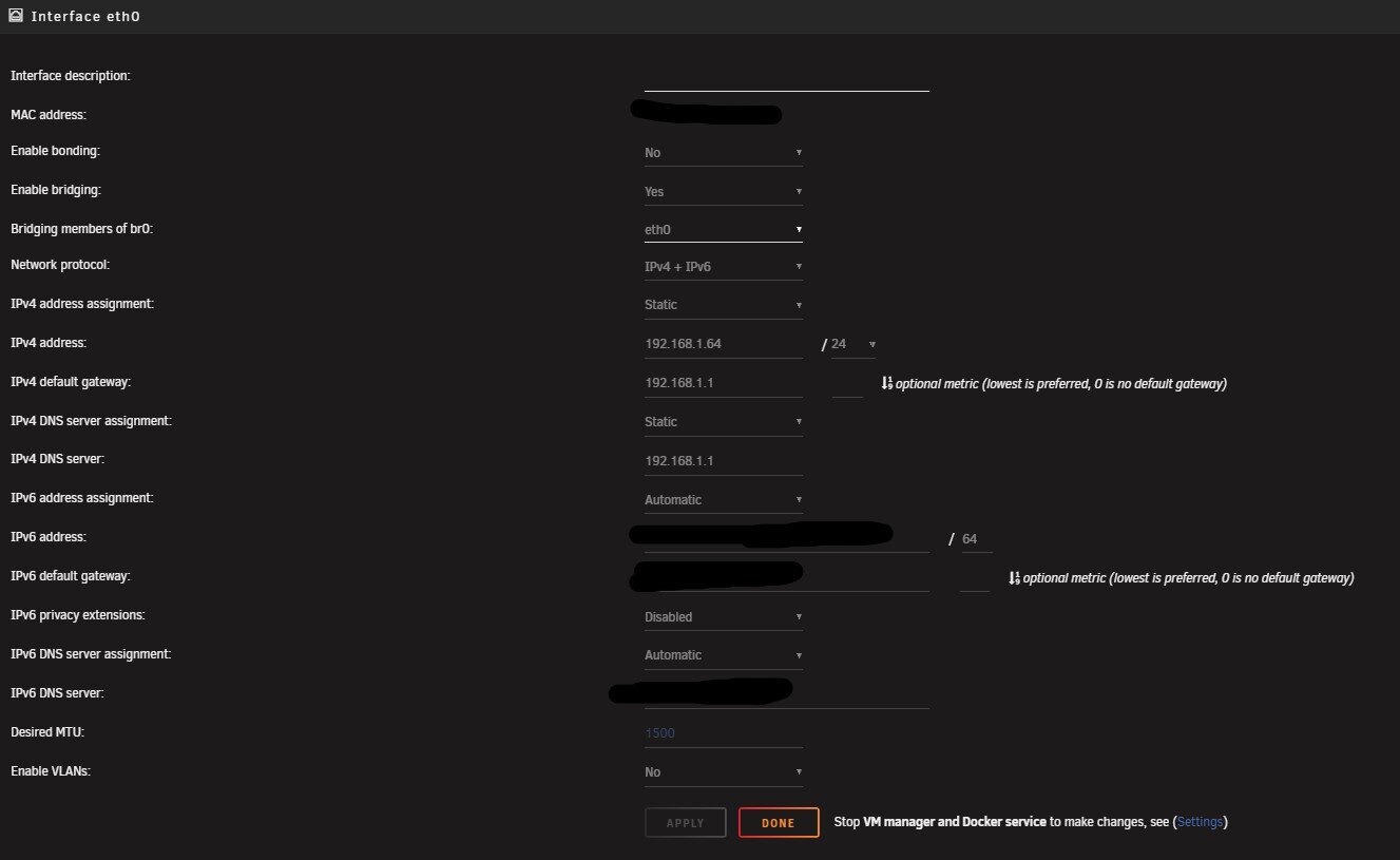

Update if anyone cares:

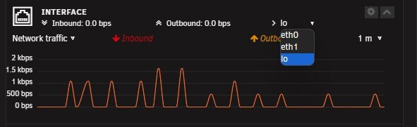

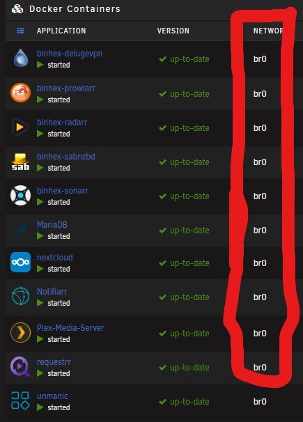

I couldn't isolate the IOMMU group for the new NIC. Instead, I had to go to the network settings and create two different eth0 & eth1. I assigned all plugins and dockers to br0 and the VM to br1. I tested everything and all is separated. only kicker is that unraid has 2 different IP addresses since I couldn't passthrough the IOMMU. It doesn't seem to be impacting anything so I don't give a fuuuuuu...
The one below this comment is the VM. I change the 0 to a 1 in the XML so I wouldn't have re-do the info for graphics card.
