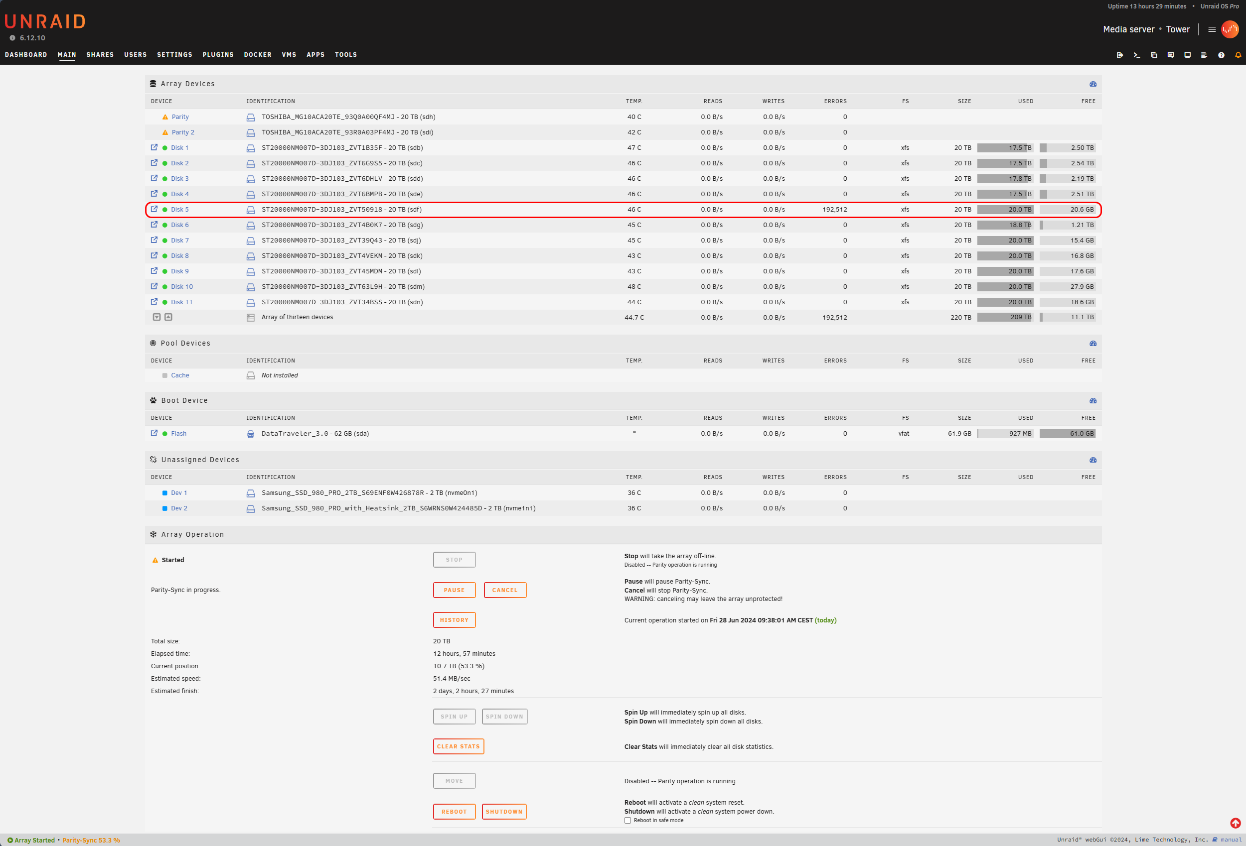

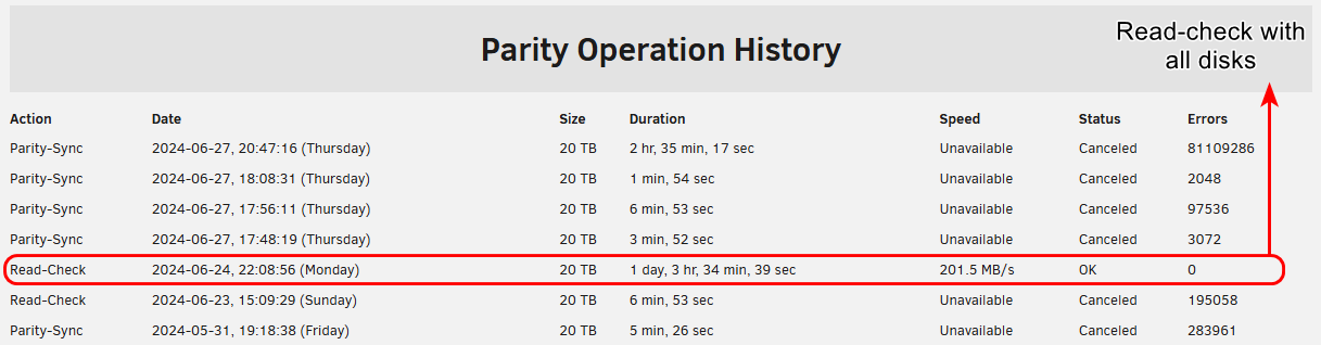

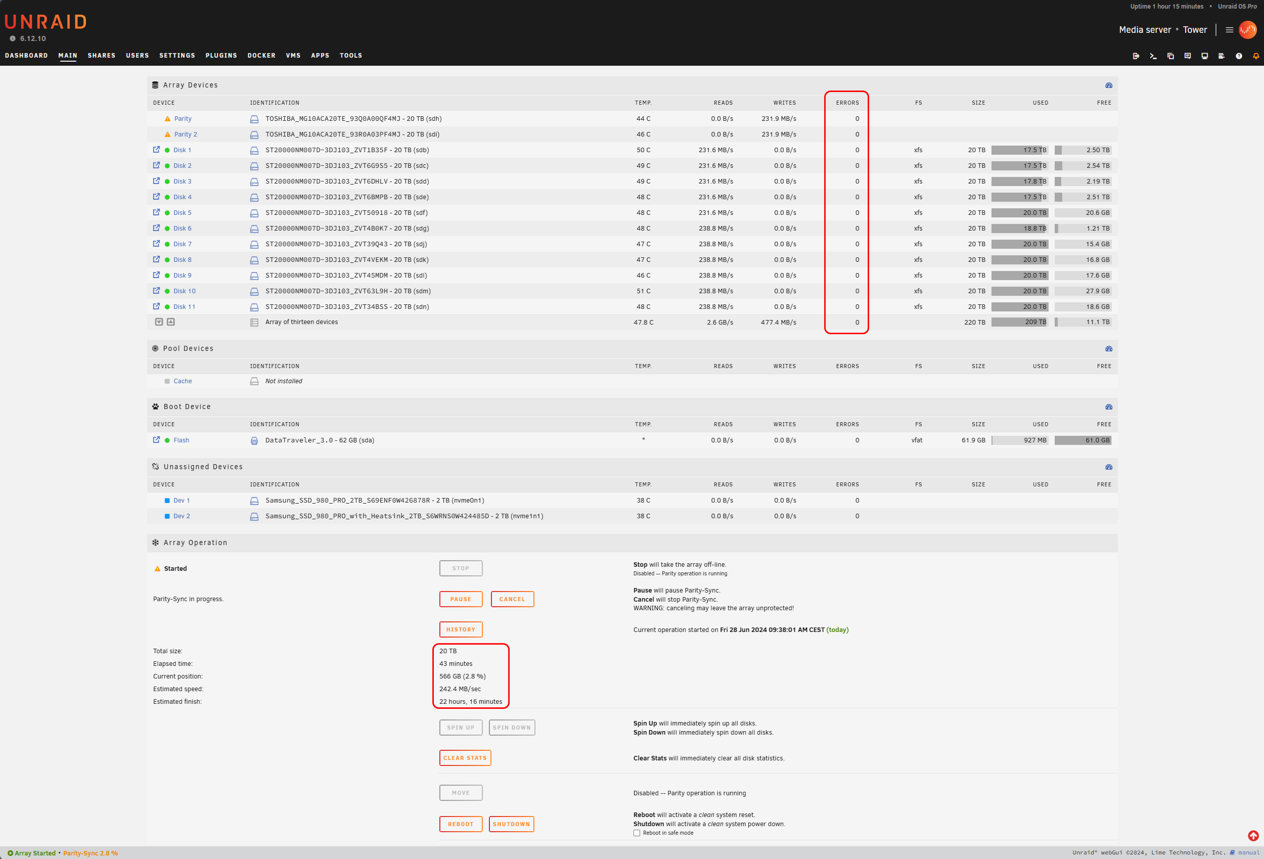

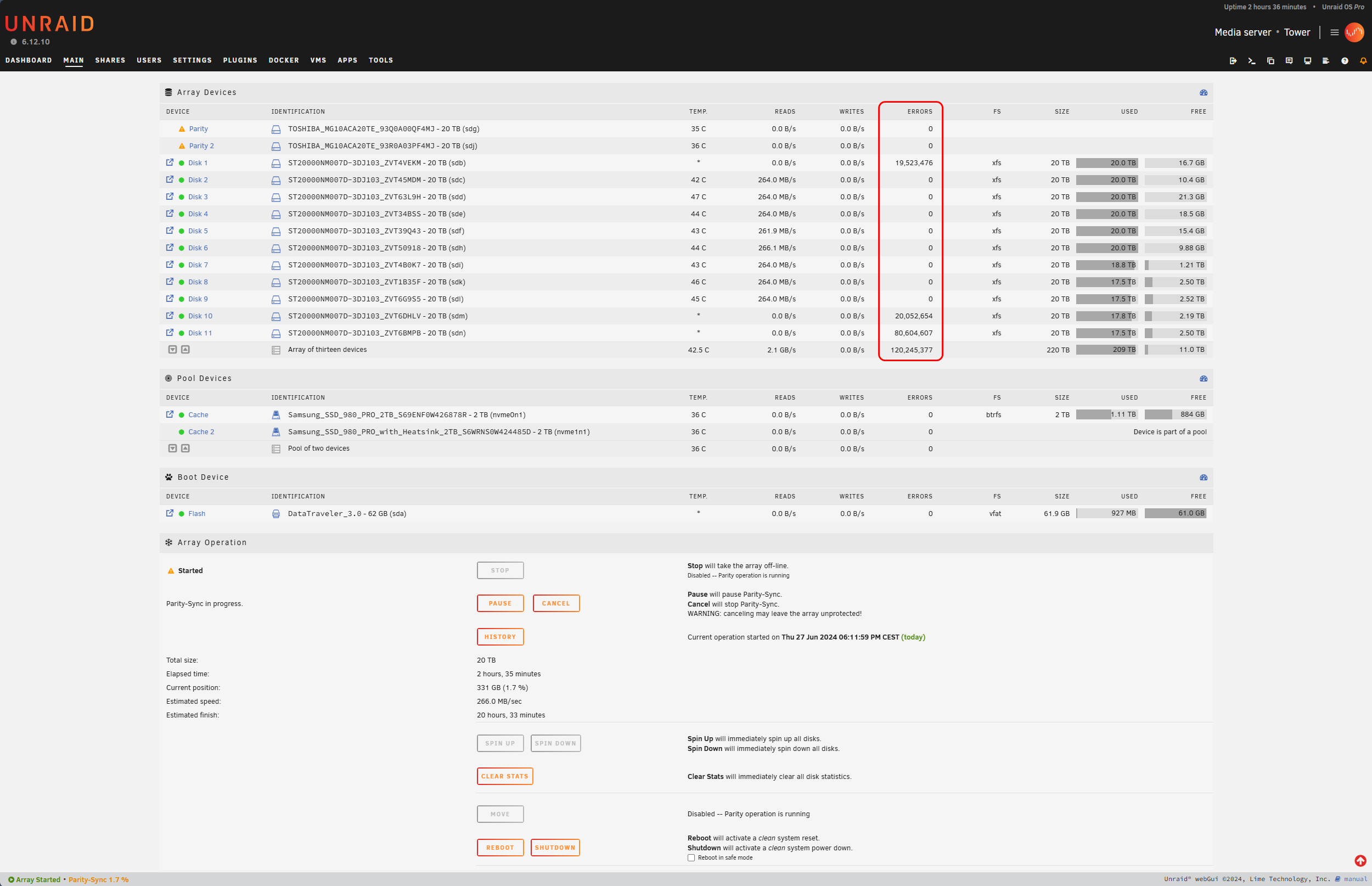

On Monday, I was doing a check-read on all the hard drives to set a couple of them as parity. Apparently, everything went well. I also did a check in maintenance mode, and I didn't get any errors. And neither have SMART errors.

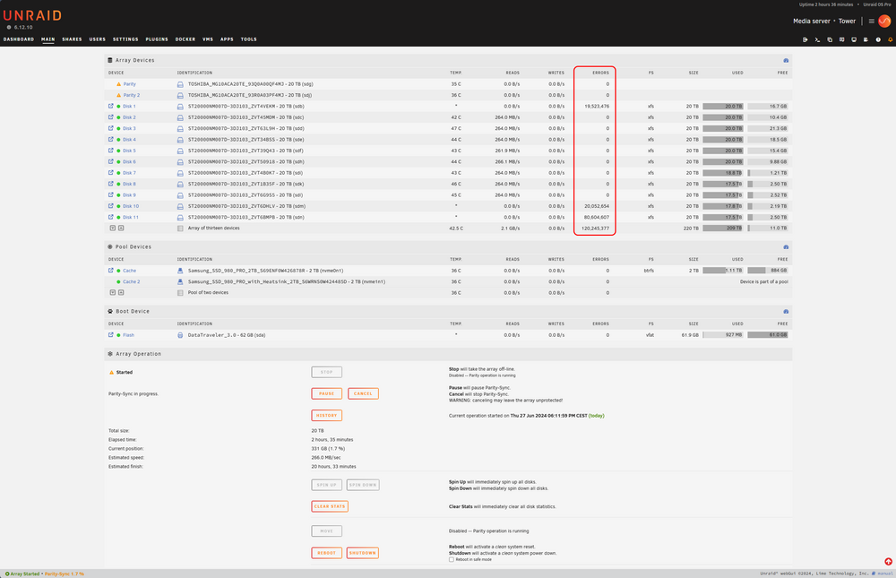

Today, I set a couple of them as parity hard drives, and I started getting a lot of read errors.
Apparently, the content seems to be fine on those drives, and I randomly checked some things, and there don't appear to be any read errors. If there had been errors, the check-read would have returned some error.
What could be happening? Should I let the parity process finish with so many errors? I am attaching the diagnostic file in case someone can help me.

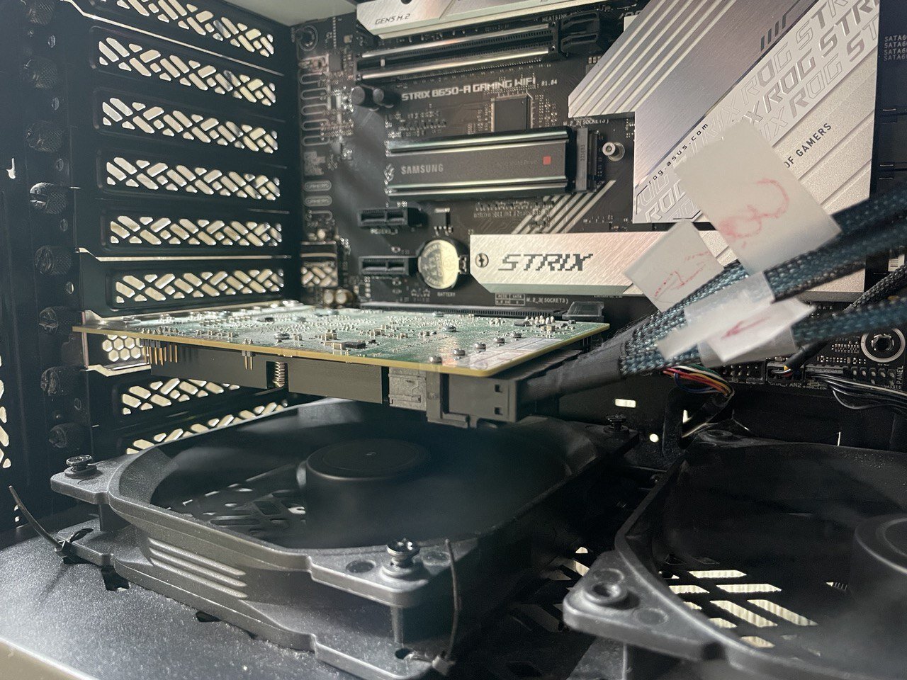

It seems that I have solved it, for now, by reversing the order of the hard drive cables. That is, the last cable is now on the first hard drive, and so on with all of them. Honestly, I don't understand anything, and what happened is very strange. I'll come back when the parity process is finished if finished ok, to tell you.

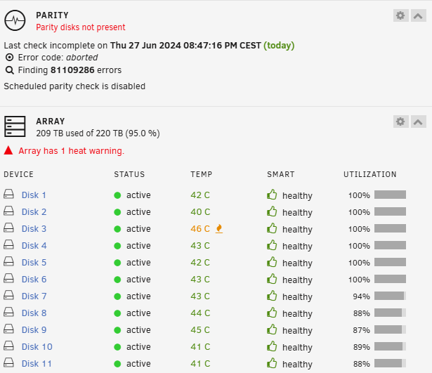

Last night, after the process passed 50%, one of the drives started giving me constant errors, so I canceled the process. I'll try again next week again.
It's very strange because if the cable or connection was truly faulty, it should also give me read errors while I'm using the array, right?

I don't know why, but I've tried changing the cables, the order,... and when I try to do the parity process, at a certain point (it's not always the same %), it starts giving errors on one or two drives. The problem is that it doesn't always give errors on the same drive; sometimes it changes. This seems very strange, because the server has been running for a month without any read problems; they only appear during the parity process.
Could it be that the controller gets overloaded at some point? If the parity process finishes with errors, does it mean that the parity is incorrect and useless?
