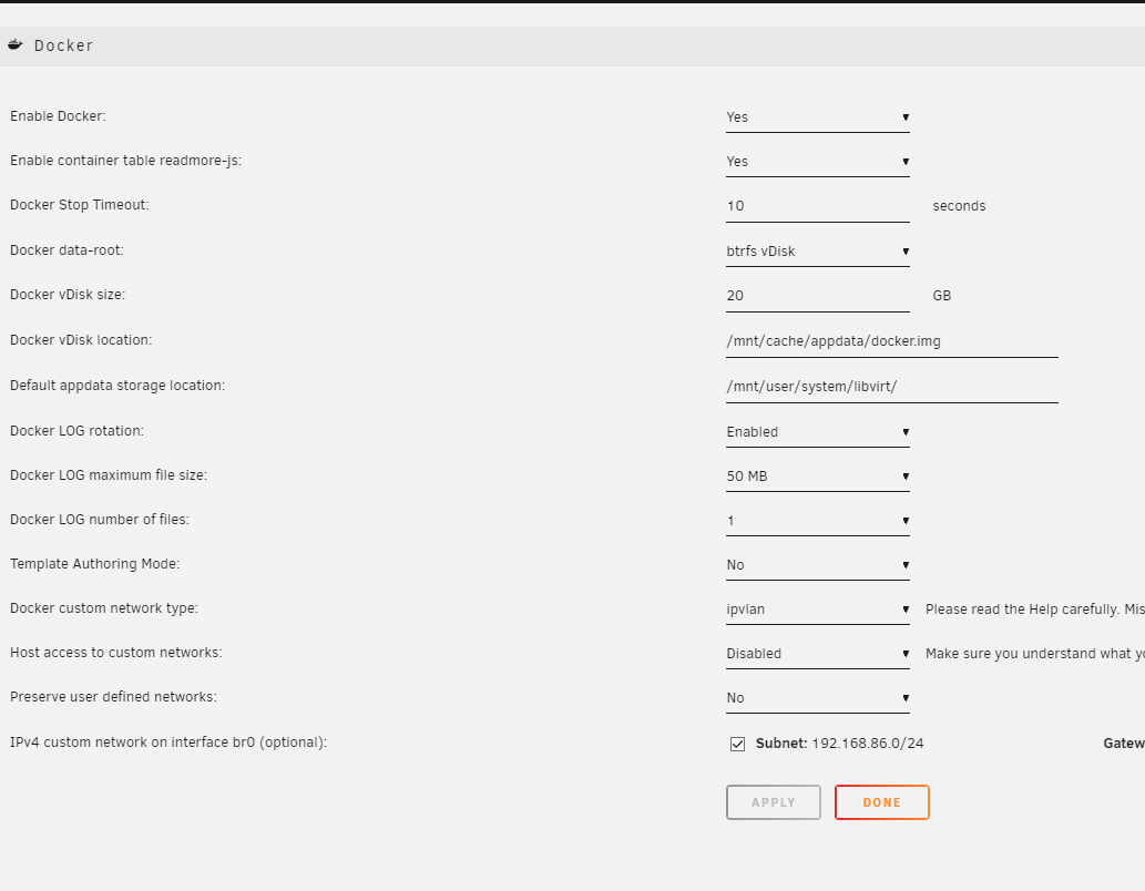

Trying to start docker by following the support threads, but can't make heads or tails of what I am doing wrong and what I should be doing in order to make it start. Above is a screenshot of the folder DIR used and recommended by the support thread linked here.

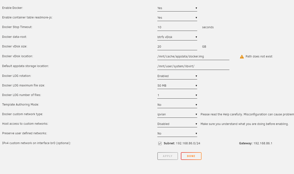

image of what I see on the docker page in the GUI

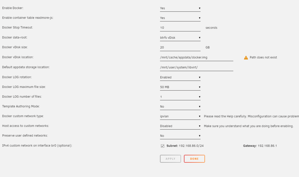

After restarting the server, path now no longer exists
Not surprising as the location /mnt/cache refers to a ‘cache’ pool that you do not have so that ends up being a location in RAM which is lost when the system is rebooted.
Any reason you changed the path for the docker.img file from the default value of /mnt/user/system/docker.img?   That would have been ok.

The original path also gave me the same error which is why I changed it referenced below Edit: now re-reading the post here, better explains why the error came up, as I didn't have the cache already, as well as me not reading the finer details of the post and just going for the "quickest" fix

Trying to start docker by following the support threads, but can't make heads or tails of what I am doing wrong and what I should be doing in order to make it start. ( I changed the path because of this issue ) Above is a screenshot of the folder DIR used and recommended by the solution in the support thread linked here.

changed back as per your recommendation after a server restart and everything worked fine this time, no clue why I was getting the error in the first place.
